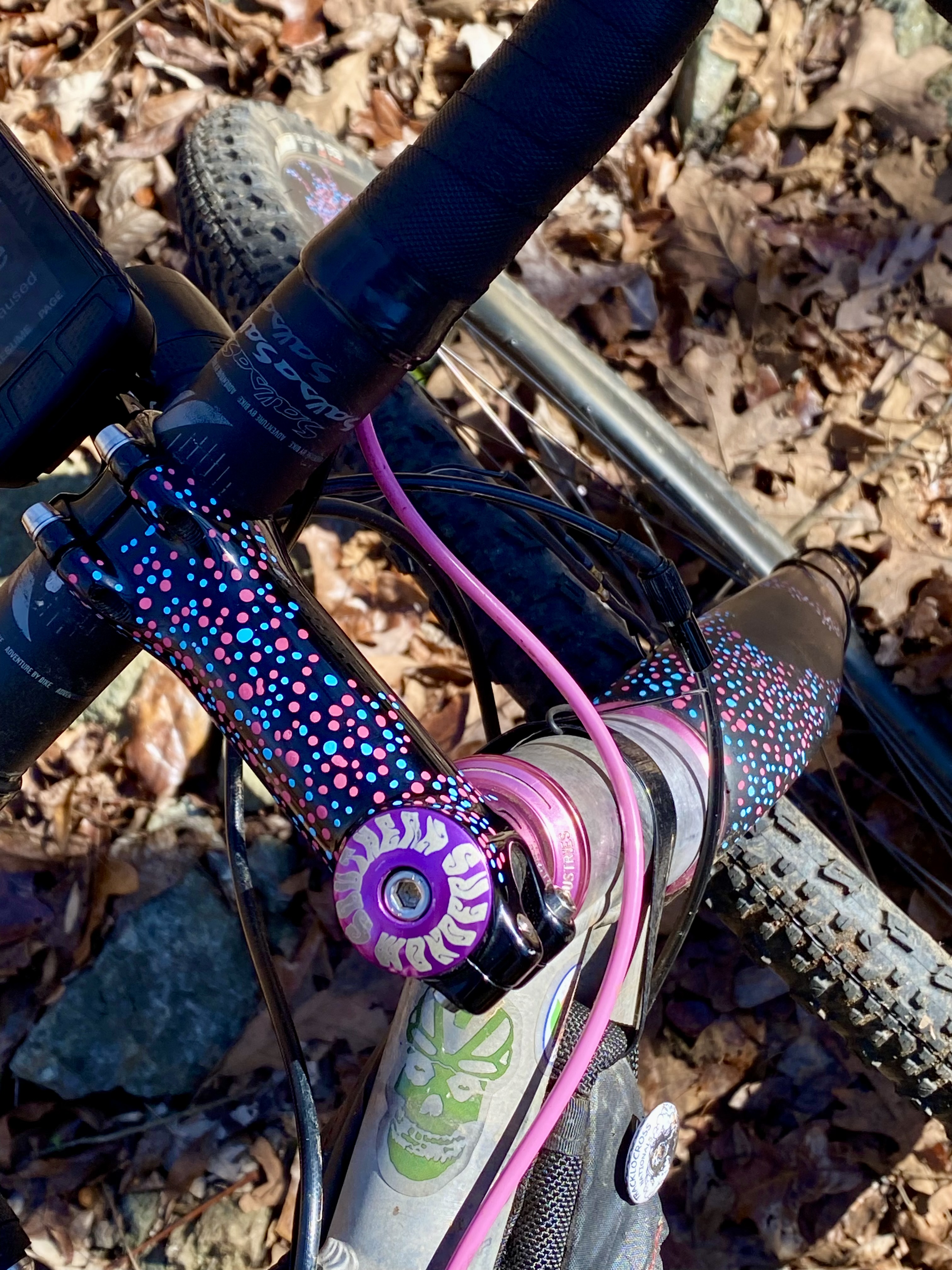

Kiddo picked out the metalflake off the shelf, she definitely goes for the TaF paint. It looks amazing in the sun.
