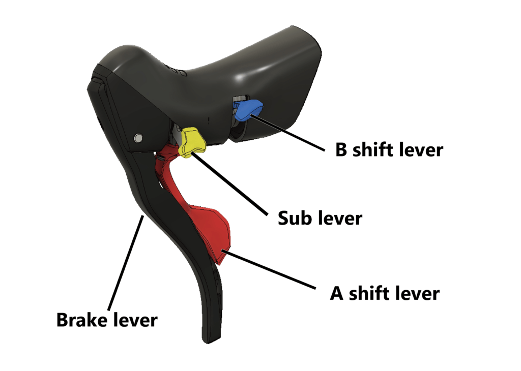

What does the shifting on the Growtac friction config? A/Sub levers inside the hood? The A lever paddle? I’m having trouble picturing this

I don’t understand how that’s any different from indexed, minus the clicks— it still seems like a ratcheting action that returns to neutral after each actuation, unlike a friction dt or barcon shifter that remains physically in position relative to the mech at the other end of the cable
That’s what’s throwing me off
Infinite indexing is the same as no indexing?

you ever ride/work on campy? FD is/was like friction in that same sense
This is correct, it’s most like old left shifter Campy. It is a return to middle friction. There aren’t any micro-ratchets, just pure friction.
yeah it’s been a while but that’s what it reminded me of… and I don’t recall people calling campy shakes ‘friction’ bitd
