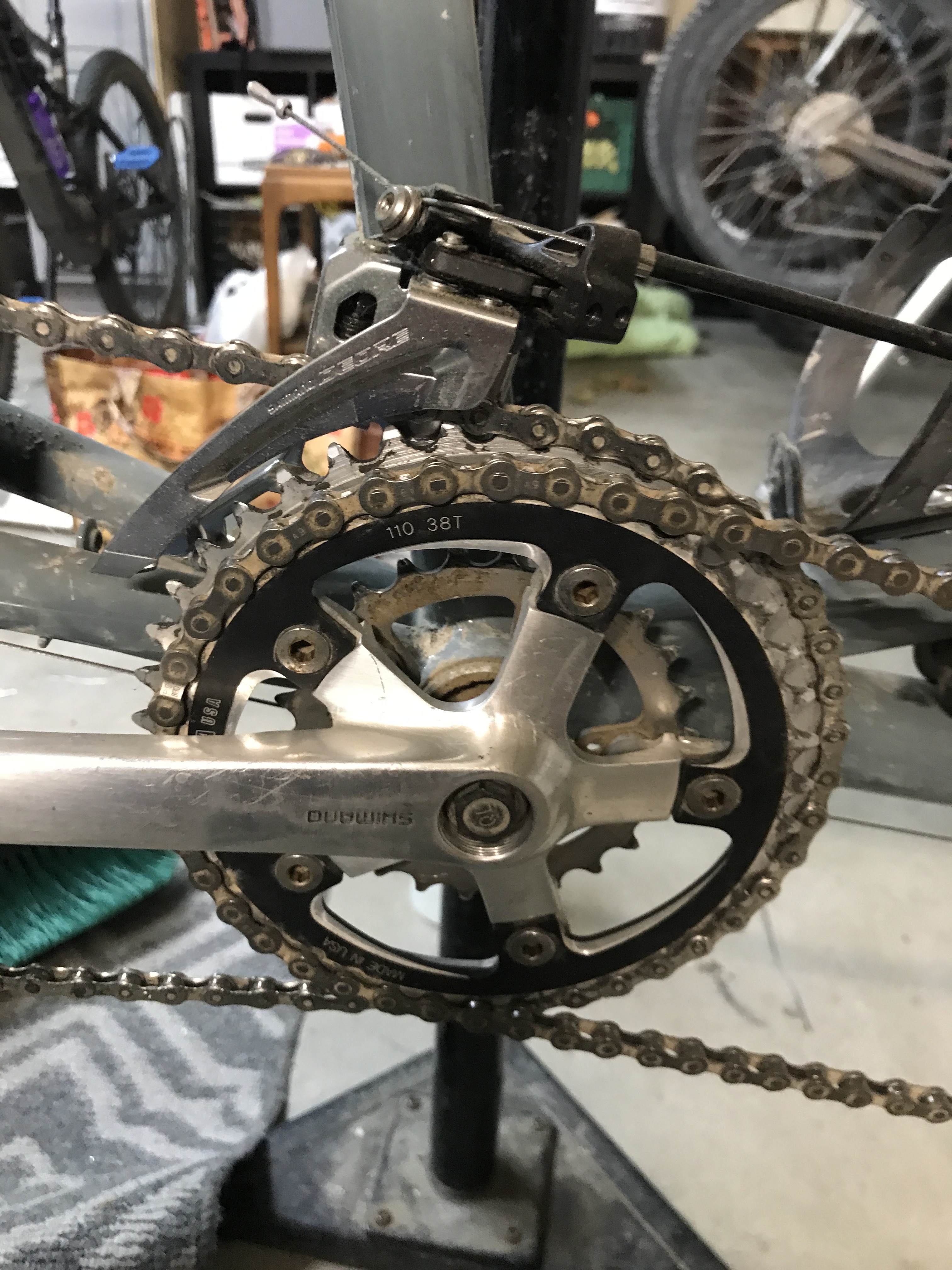

Swapped out my 38/26 crank for a 36/22. Tested today. Awesome climbing capability with an 11-40 on the back.
Ive been weighing my cranks as I dither them about. I think Ive just about got one of everything From shimano.
Not weighed my 5 bolt combos.
XTR 3x 734 grams
XT 1x 700 grams - asymmetric
Deore 2x 795 grams 36/22
XT 2x 761 grams 38/26

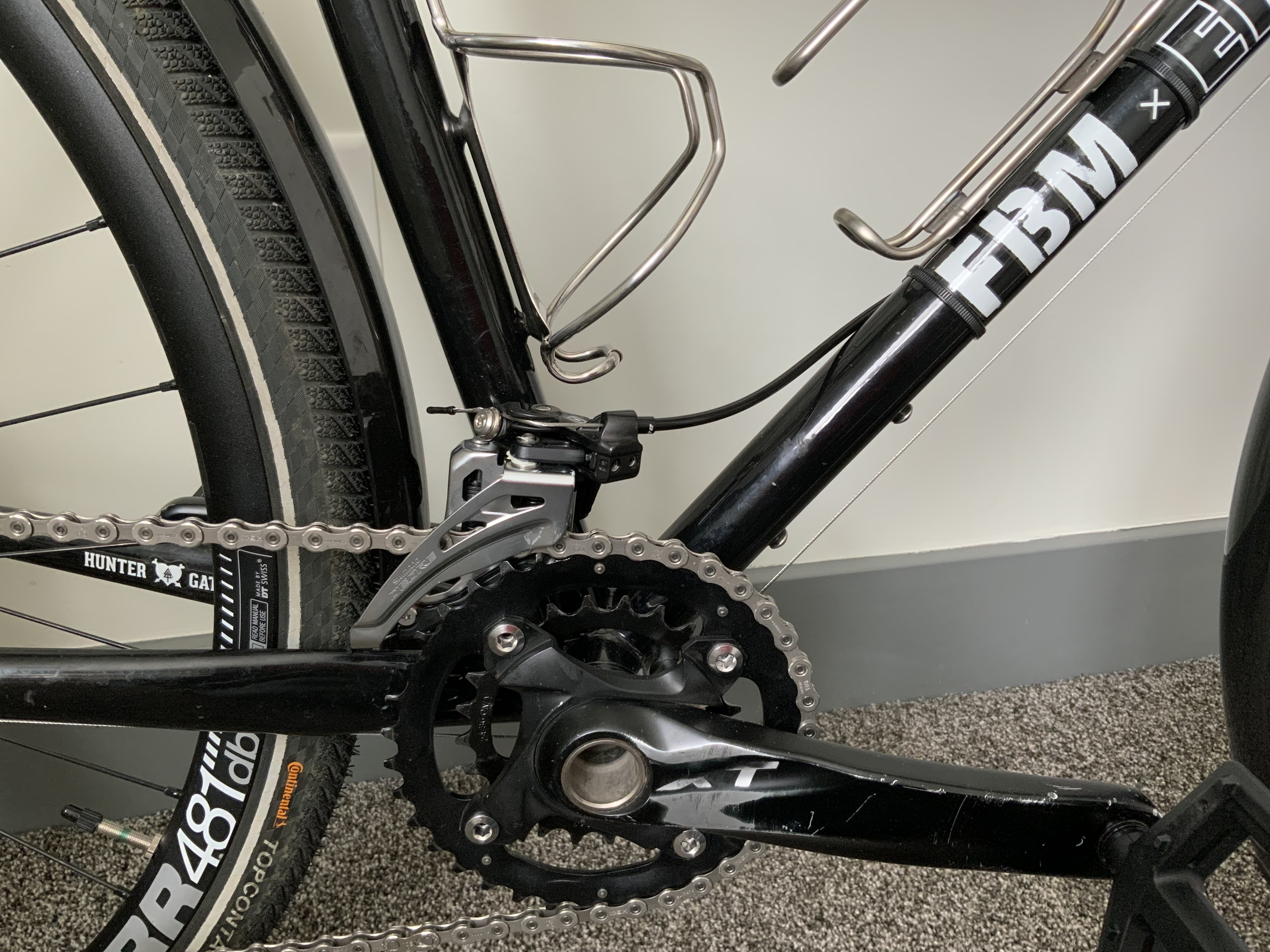

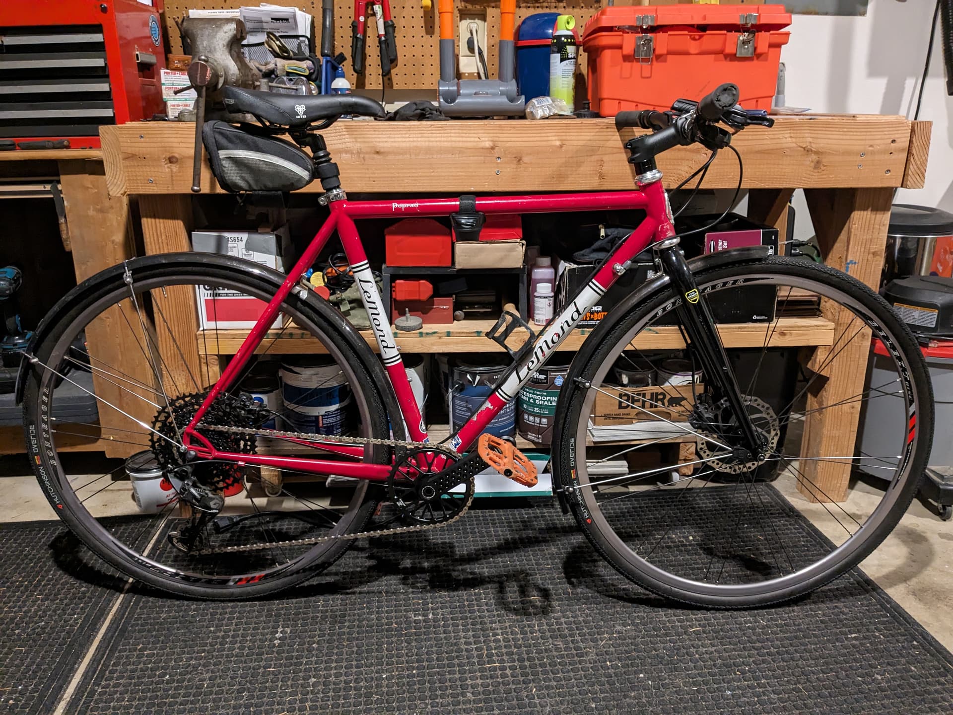

Took a chance on a $15 Deore side-swing pusher for the day ruiner, hoping it would work out for this weird setup and mission accomplished other than the unusual cable run (full housing from the shifter, ziptied to the down tube). It even shifts fine with an old Deore thumbie. I had tried a low-mount top/btm pull version of the same pusher a while back and there wasn’t enough room between the seat tube and the fender for the mechanical parts.
With that done, and a 139 basket installed, it’s all ready for winter commutering now, just in time for a bunch of snow that will probably prevent it from being ridden for a bit.
I absolutely LOVE the side swing Shimano pushers. We built a HG and a couple of Gorilla Monsoon bikes up this way. SOOOO GOOD. It’s like the direct mount rim brake. Shimano utterly perfects something completely irrelevant to 99.9% of riders.
I remember Fred describing it as shifting like Jesus making one set of footprints in the sand.
I’m honestly surprised Shimano hasn’t tried to figure out a way to do this with 12 speed road stuff. A side swing E-type pusher for road/gravel would be super cool.
I hadn’t even considered using one until seeing a video or two on the BikeFarmer YouTube channel. He was setting them up using a Problem Solver cable stop on the lower part of the down tube and that’s when the lightbulb went on for me.
It’s really tempting to buy another one while they’re still on sale.
DQ: does the der cage swing forward as well as moving outboard when you shift to the big ring?
A bunch of the 2x jawns have relatively short cages, where Shimano is conservatively listing them as only supporting a 10T jump

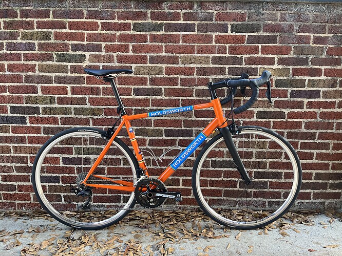

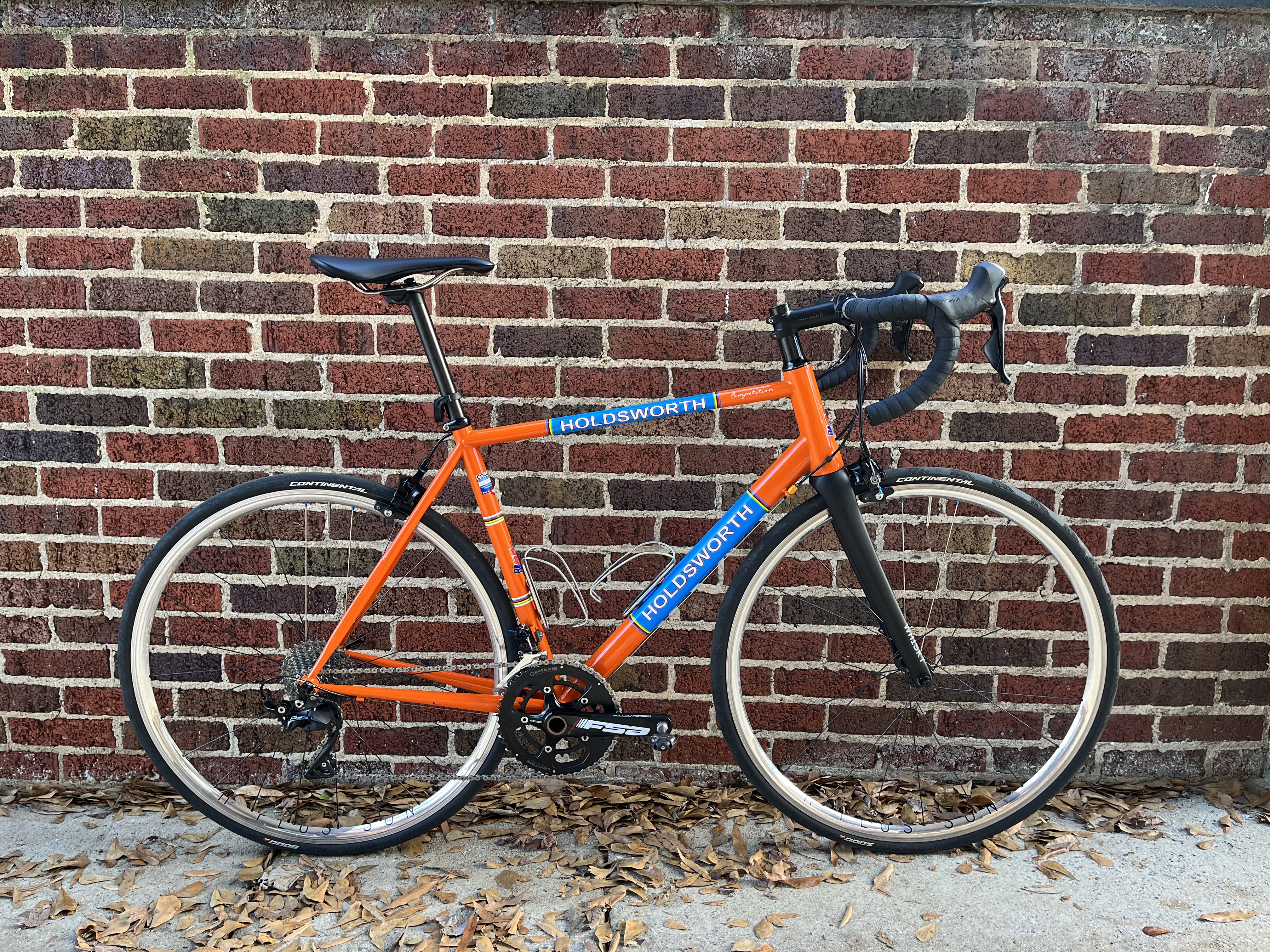

Wanted more steer tube on my road bike so I got a Whisky No7 fork. Ended up raising the stem about 20mm.
Cleaned and waxed the frame and chain, and installed new cables and housing. Also reinstalled a Salsa Guide carbon post to replace a silver Ritchey Classic.
Rode it for 2 hours today and everything feels great. Fork feels maybe a bit more compliant than the stock one but not in a bad way at all.
