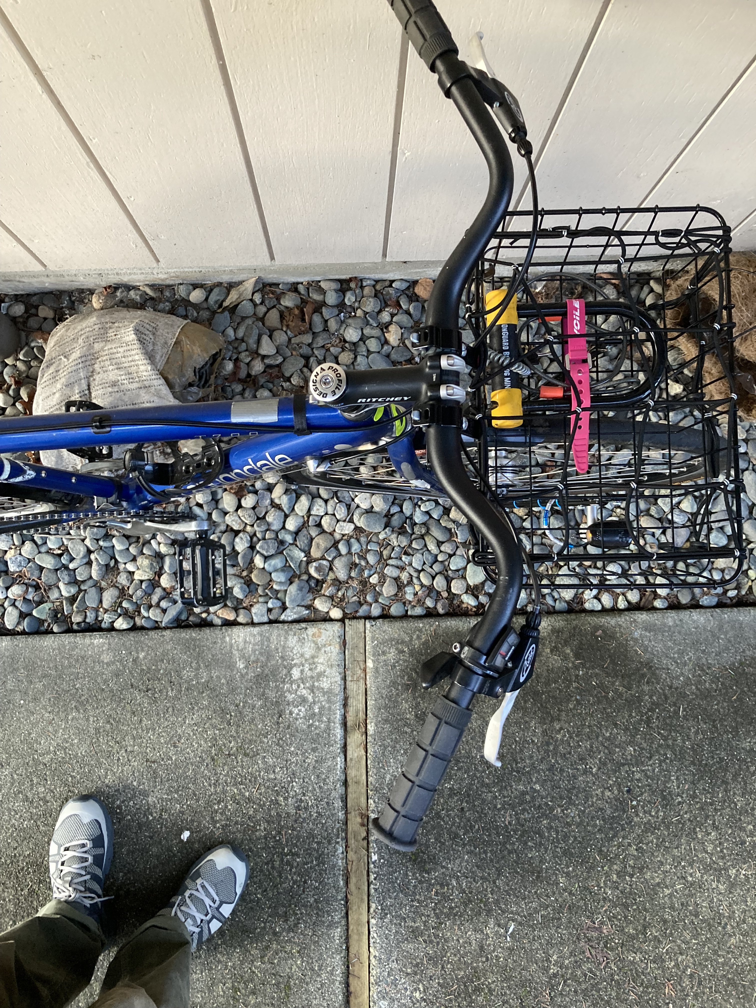

Found a set of new Ritchey Kyoto bars at the coop for $10 so I lopped a bit off each end and installed them on the commuter

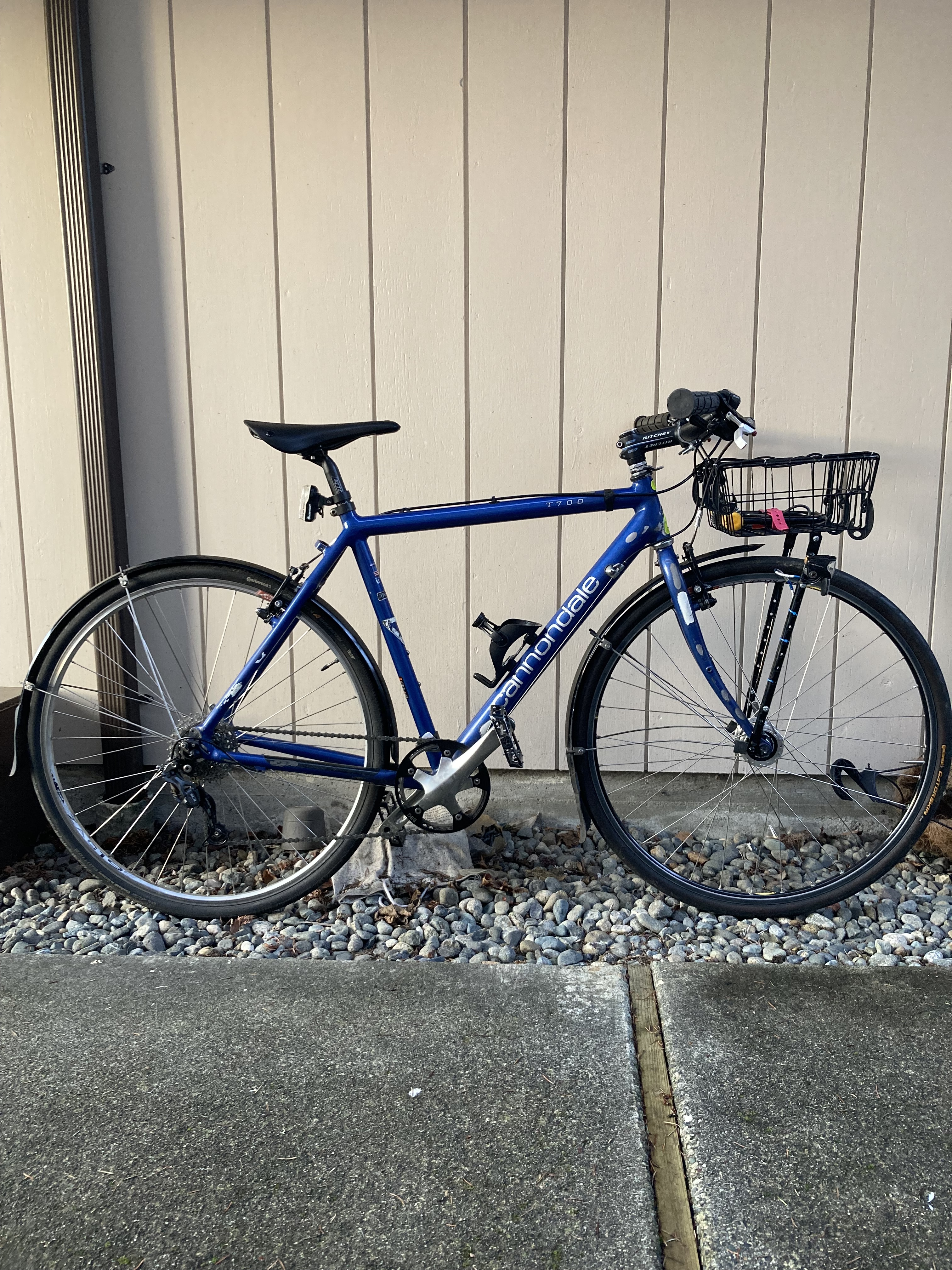

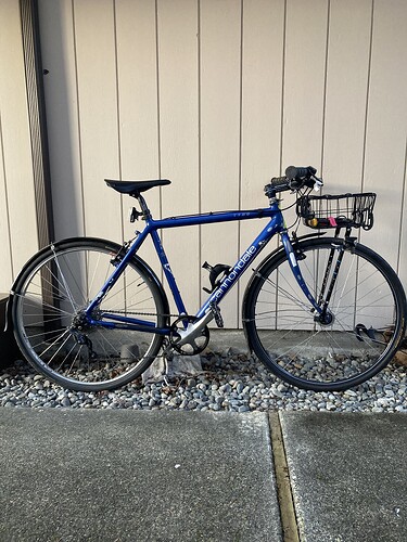

I thing I did to Cornelia’s crosscheck a week ago but was only discovered today:
Last week I reinstalled the fenders on her bike.
Today we’re getting on bikes to ride to the library by way of a French bakery. Her cranks won’t turn. We try lots of things. They’ll drive the chain for a second and then lock up. We can’t find anything at all. Take the bikes back upstairs. I’m expecting to walk or catch the bus but she throws her bike in the repair stand and wants to get it sorted. Pull the wheel, look around, spin jockey wheels, spin freehub, push the derailer side to side. Nothing looks bent. She suggests getting the spare derailer hanger we have. I put the wheel back in just in case something we did fixed it. Then she asks if the chain is supposed to be so close to the frame at the dropout. I look down and notice a fender bolt protruding out the back side of the braze-on that is just close enough to catch the chain in the smallest cog. Took the bolt out and replaced it with a shorter one and everything is fixed.

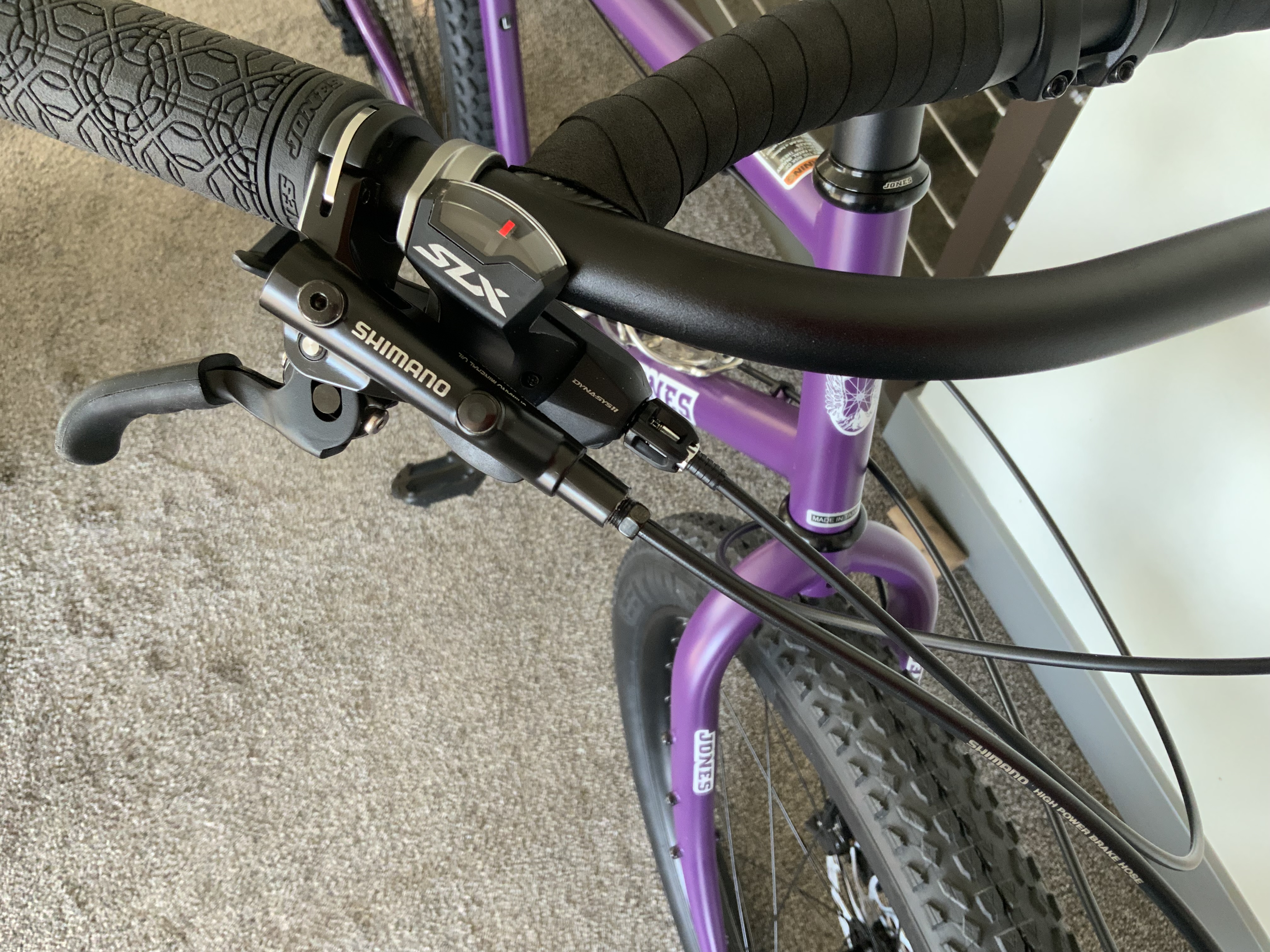

Connected the brake and shift hoses to finish up the unnecessary brake and drivetrain swap on the Jones yesterday. The stock mech brakes felt bad so it’s fine.
And on the topic of mistakes I successfully continued my streak of forgetting the connecting bolt cover on the first brake installed (always the right/rear).
