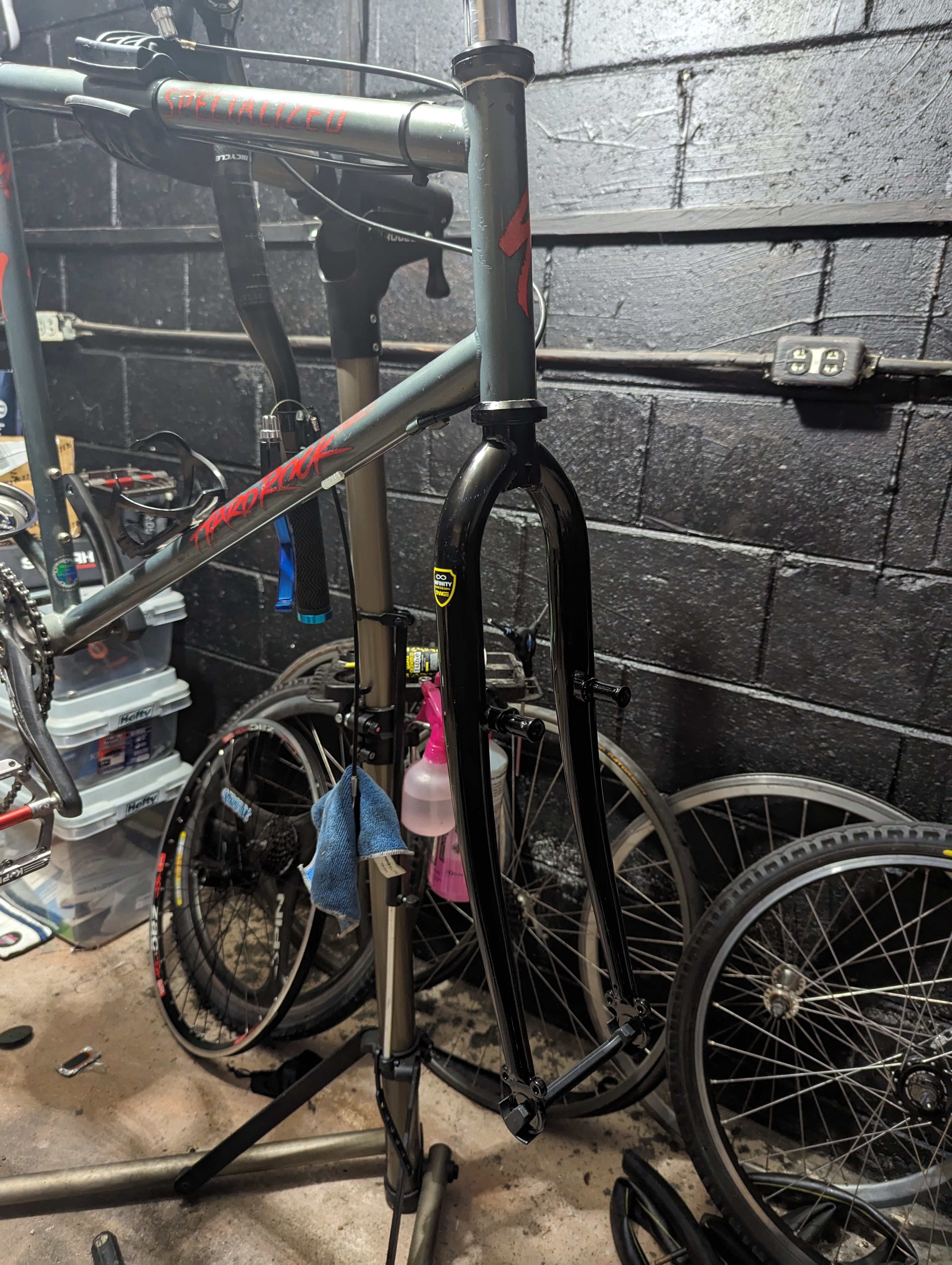

Installed a threadless headset and fork, waiting on spacers to show up

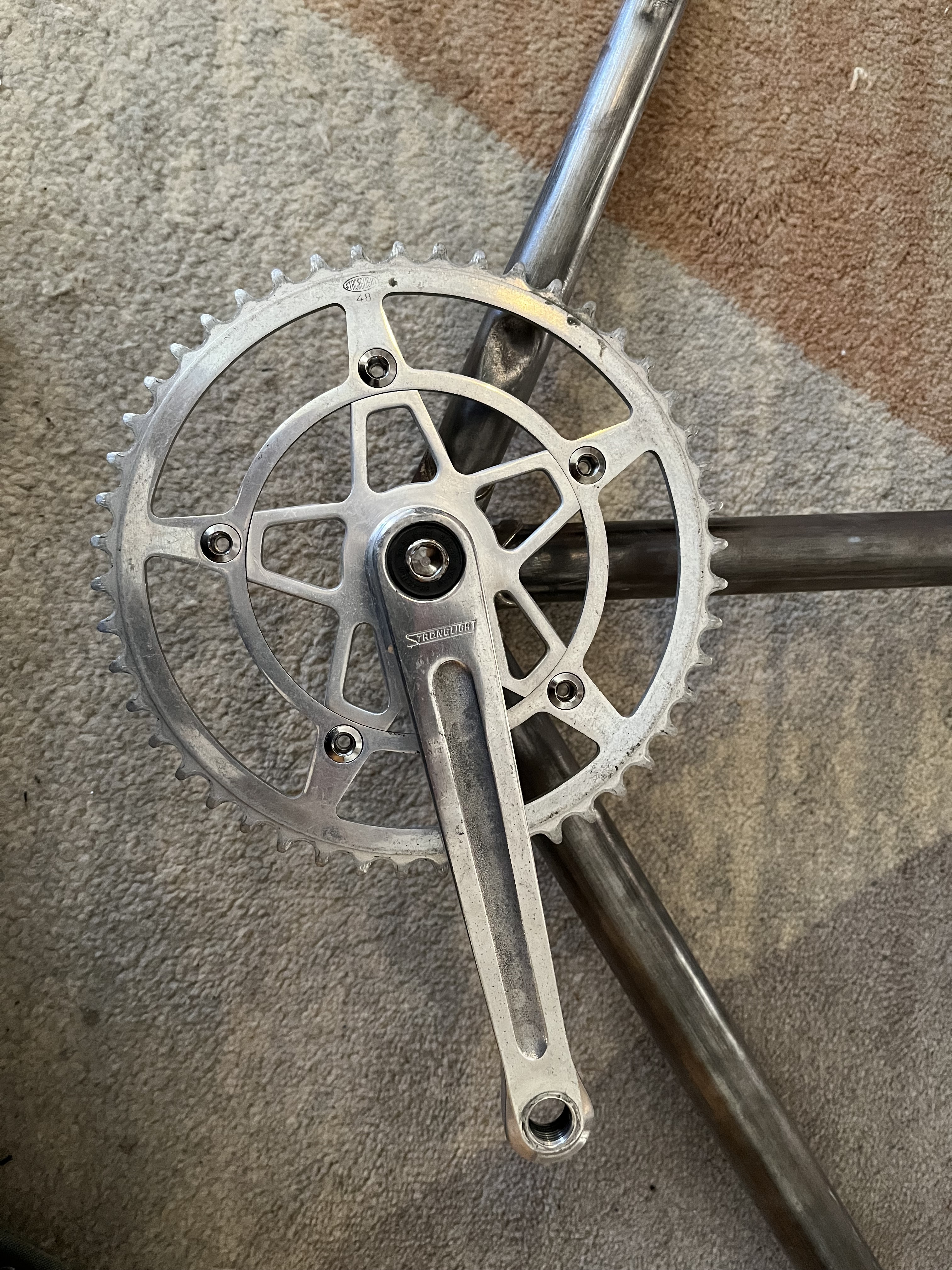

Got my Stein Stronglight puller in today so I could finally see what I needed to do BB wise for this track bike.
HY 42mm chainline with chainstay clearance on the first try!
I feel like @igor needs to reissue these as a gravel compact with 24mm spindle in shortways. that spider is pretty
Or 49d shaped chainrings in practical sizes and with ramps and pins that could fit the existing 50.4bcd cranks. His 46/30 rings shift so well.
my experience with very similar era sugino cranks with an 11s 135 spacing drivetrain allowed for frame clearance issues, chain/crank arm clearance issues, or a little of each. i would very much love a modern equivalent, even if less offensively light

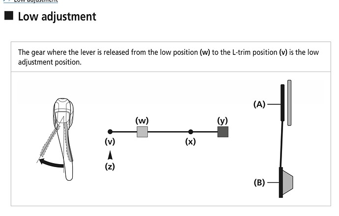

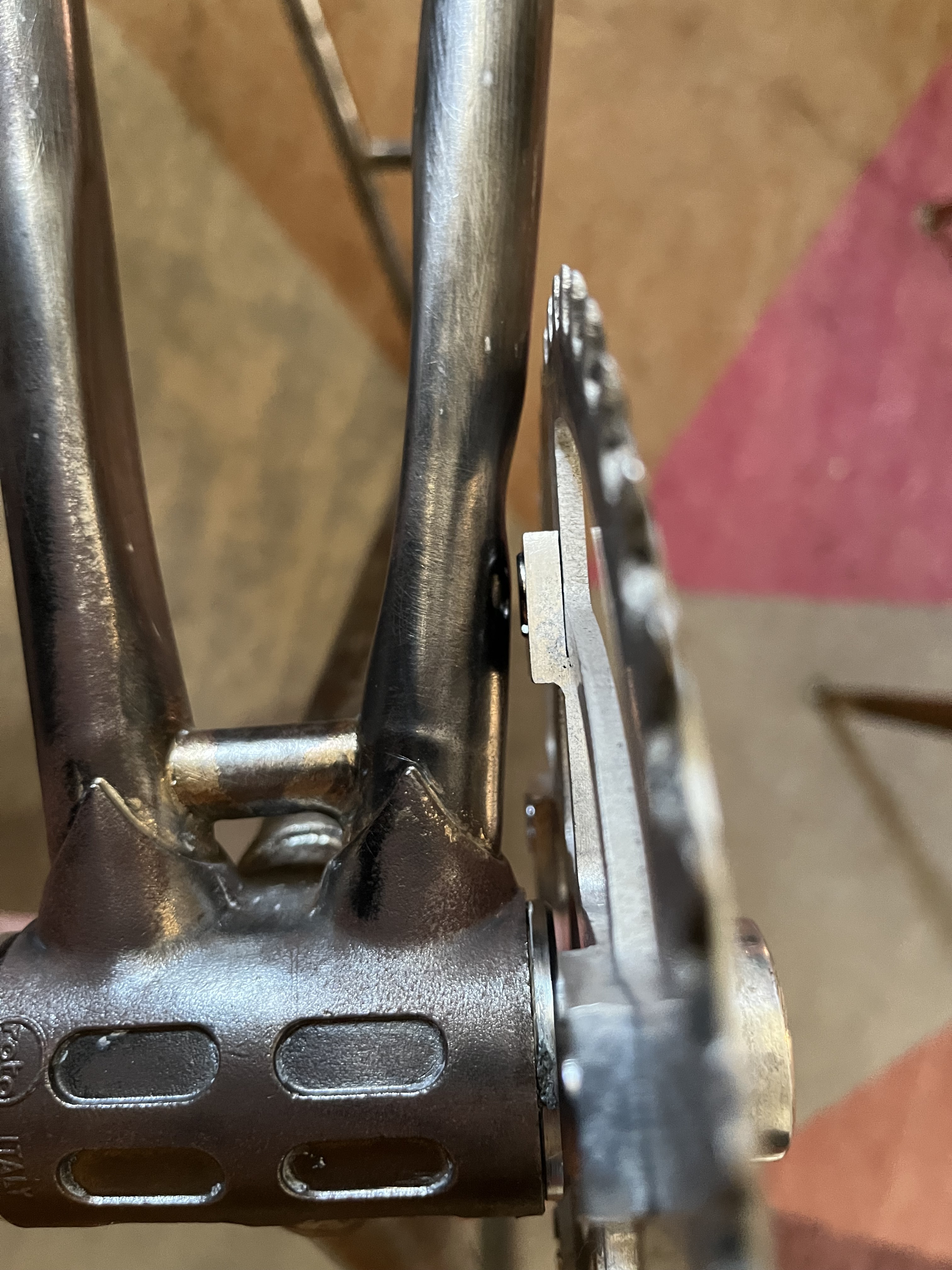

After buying the crank last night I started to get bothered about throwing money at the chain rub problem on the roadbike instead of trying to figure out WTH was causing it. Did a visual check of the pusher braze-on on that bike compared to both Problem Solver and IRD braze-on adapters to see if it was maybe further outboard than it should be and it seems fine. Measured the BB shell width at 67mm and wondered if maybe that was contributing and thought about pulling the crank and BB to see if the faces of the shell were symmetrical with respect to the seat tube (did not do this). Then, figured Iād give one more go to setting up / adjusting the R8000 pusher and now Iām not sure if:
- My brain is too smooth to deal with these pushers, or
- Shimanoās instructions for these pushers is not clear
(Itās probably both)

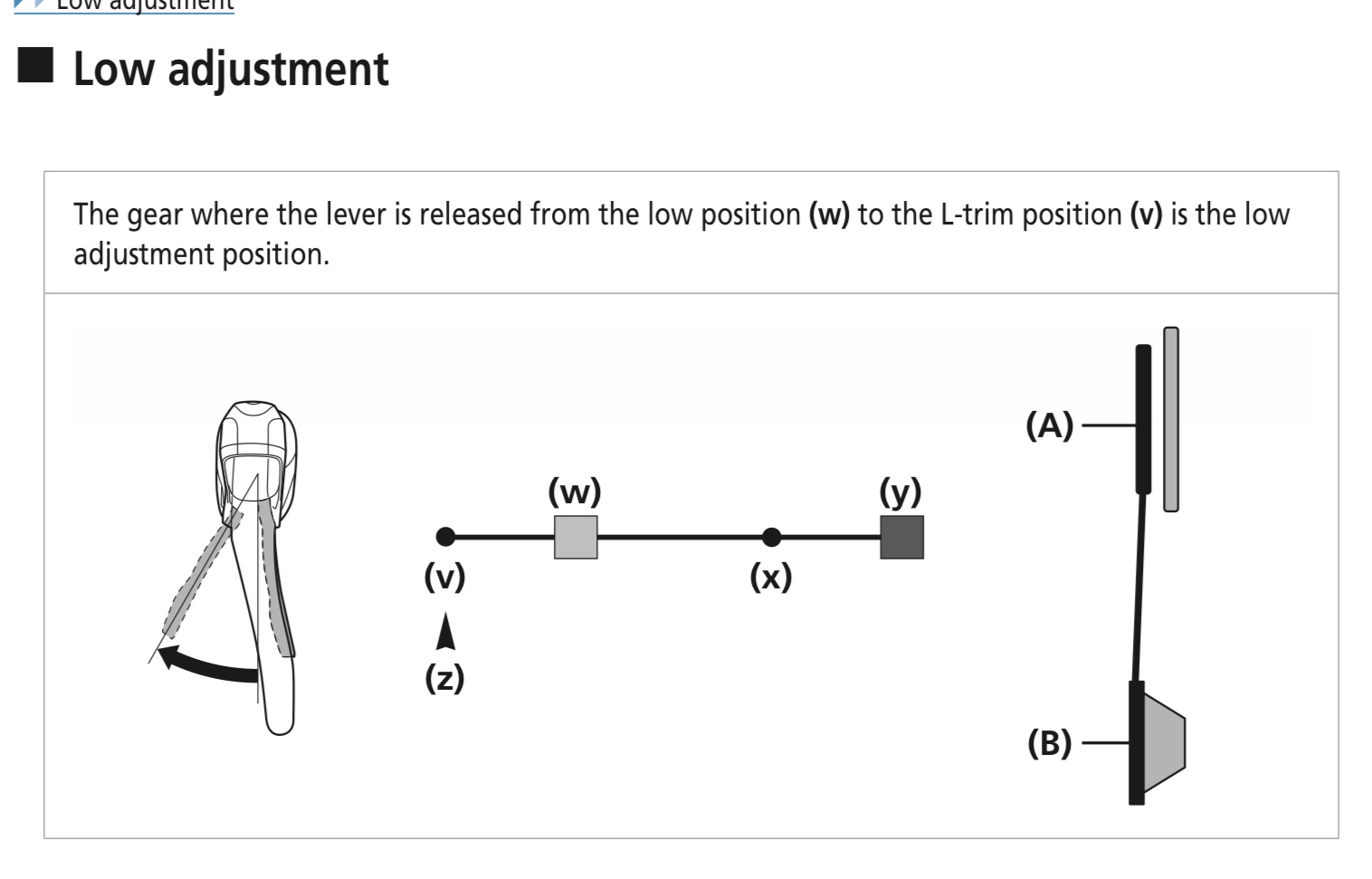

Seems like maybe there was too much cable tension in the system and shifting the lever down into the (v) position where the low limit adjustment is done / comes into play wasnāt moving the cage much. I thought the low limit screw was all the way backed out and it actually wasnāt. They say to adjust the low limit chain-cage clearance to 0-0.5mm at (v) which seems like it would definitely cause minor rubbing in position (w).
So I guess everything is fine even though Iām slightly annoyed at the unplanned crank purchase even though itās a brand new crank and rings for only $45. I might just keep the rings and try to sell off the arms for cheap.
Can you just put a thin shim behind the bb cup or something? Seems like the tolerance is way too tight to warrant a whole new crankset. 0.5mm is almost just slop.
Sir, this is tarck.
I considered that after the shell width measured a little narrow. I couldnāt find any published BB shell tolerance info from Shimano like Iāve seen with Campy, maybe my search-foo was just bad, and figured that trying to readjust the pusher was the easiest thing to try first.
Then thinking through it a little more yesterday, Iāve had an R8000 pusher on another bike and didnāt run into this issue. Then I remembered that that bike was a 142mm rear with an 11-speed cassette, while this bike is a 130mm rear with an 11-speed cassette. The cranks on both bikes have a 43.5mm chainline. So it seems to make sense to me that there would be more angle to the chain in the lowest gear with the narrower rear spacing.
