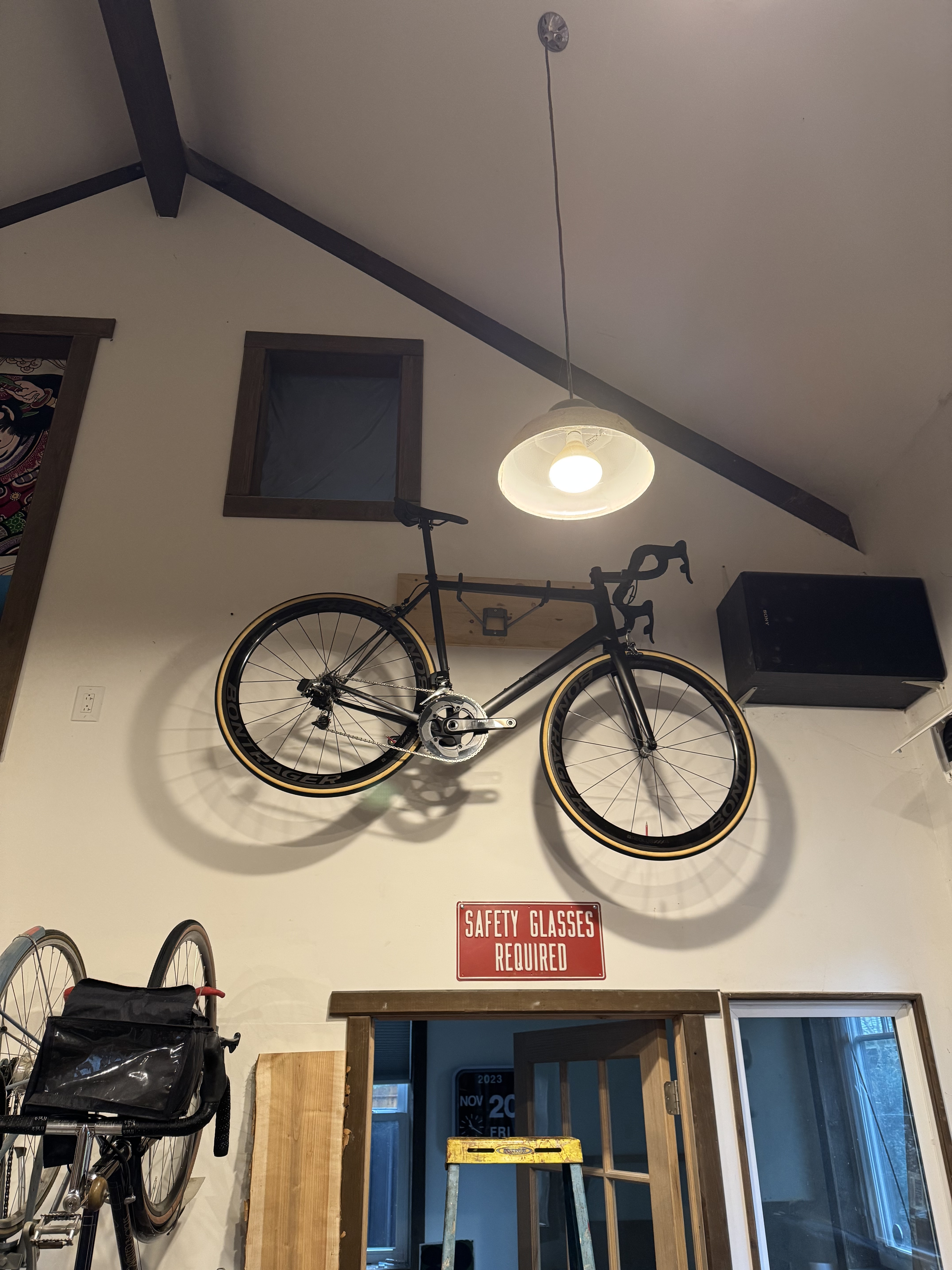

I got to see this bike in person and it is actually more stealthy and black than the pictures make it seem.
Was once hanging in my wall for like 2 months
Obv the clock in the bg is missing batteries
yep matching frame, fork, headset, stem, bars, post, saddle
Already did a titanium axle swap on the PD-ES600 pedals for narrower q-factor and a 52g weight savings
I was expecting to use some hoarded 180mm BB30 Carbon Cranks from Lightning Cycle Dynamics and quarq powermeter on this but the crank offsets don’t work at all here for the axle or chainline or q-factor, so I’ll probably stick with this style of crankarms
The previous owner didn’t use the internal routing in the bars, gonna try some different brake calipers and re-route them using aluminum housing Odyssey Race Linear Slic Kable | Odyssey BMX and maybe some of my hoarded powercordz
F off serious

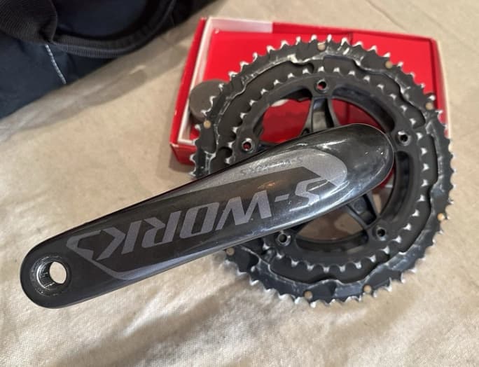

THM never made cranks longer than 175 which is against my principles, though I might get some replacement SRAM spiderless cranks in 177.5mm if they’re cheap enough especially with a powermeter
I’m standardizing on CarbonTi road hubs for this though
Were these S-Works jawns any good?
Those are lightning atmo
I thought the same and was curious so looked up the story. Yep, designed by Tim Brummer of Lightning recumbents, patent purchased by Specialized. Specialized also has their own later patents on it, I presume they changed some details (at first glance the splines/teeth of the spindle joint look different).
With maintenance, maybe? Almost every set that came through the S shop had a seized bolt and had to be chopped out of the BB. A few had crushed or deformed splines. I’m assuming there’s a reason they went back to a one-piece spindle design.
I have a set of the S-works MTB version in 180mm with the hirth joint for the Marino hardtail I’ve been building
And I think the offsets of my 110bcd Quarq spider was meant for one of the specialized variants that kept the same spider interface, not the Lightning original

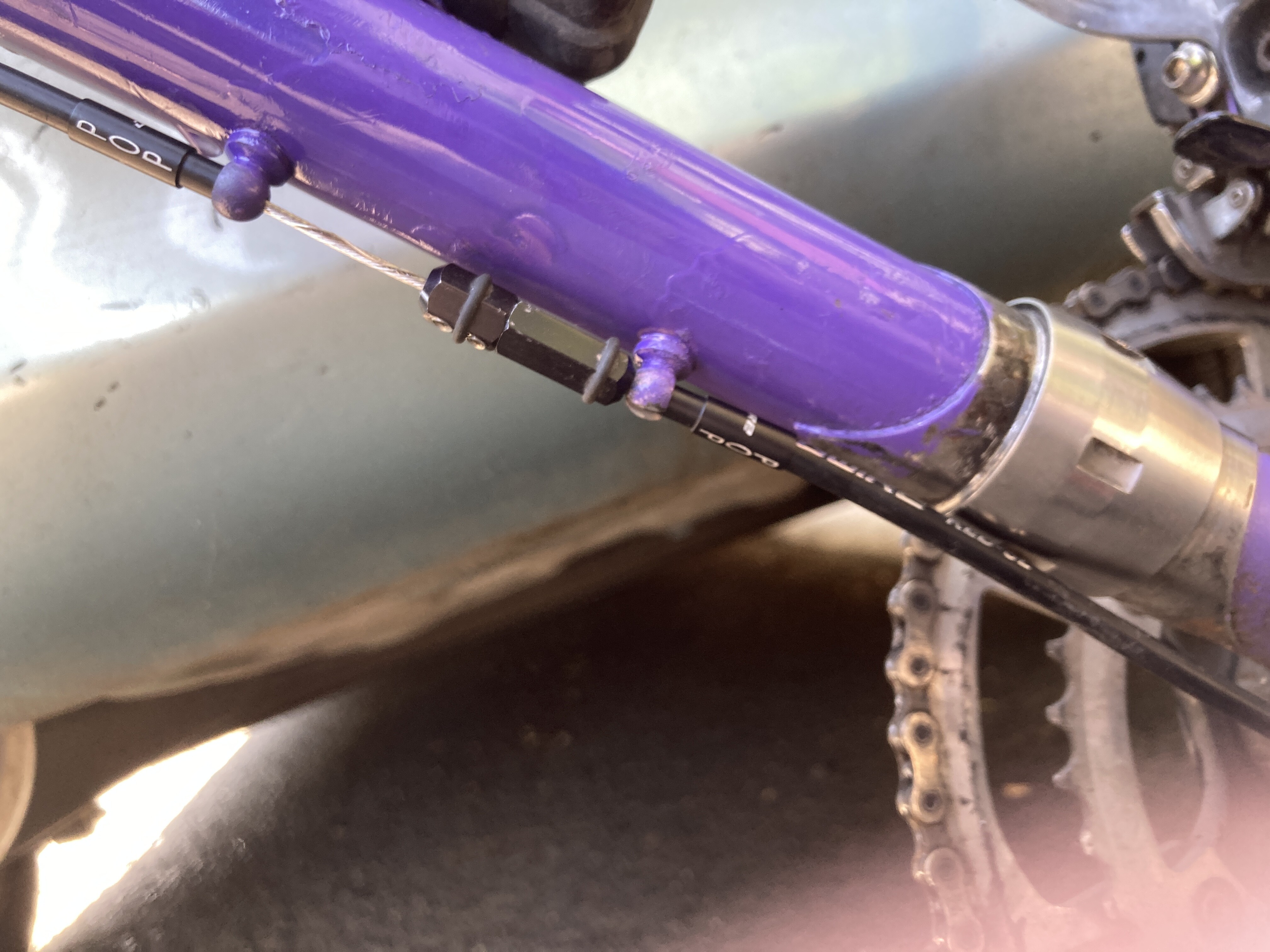

I tweaked the disco travel bike to make it easier to split it and hurl it into a car; my original scheme of puzzle retainers & continuous housing worked well for boxing, but not nearly as well for shoving into the mighty prius.
Does it thunk?
Sadly, the back seats are too soft for a really good thunk.
