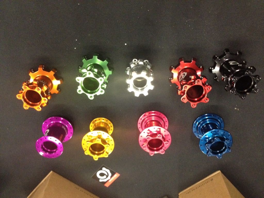

Talked to I-9 bros at frost bike. Torch J bend drops sometime in April. Will be a bit less $$$ than King R-45. Love my kings but I-9’s are sealed better and from Beast Coast.
Fondled mechanism. It’s amazeballs.
those pawls!
Did they give any of the important hub dimensions?
Yeah, it comes in purple

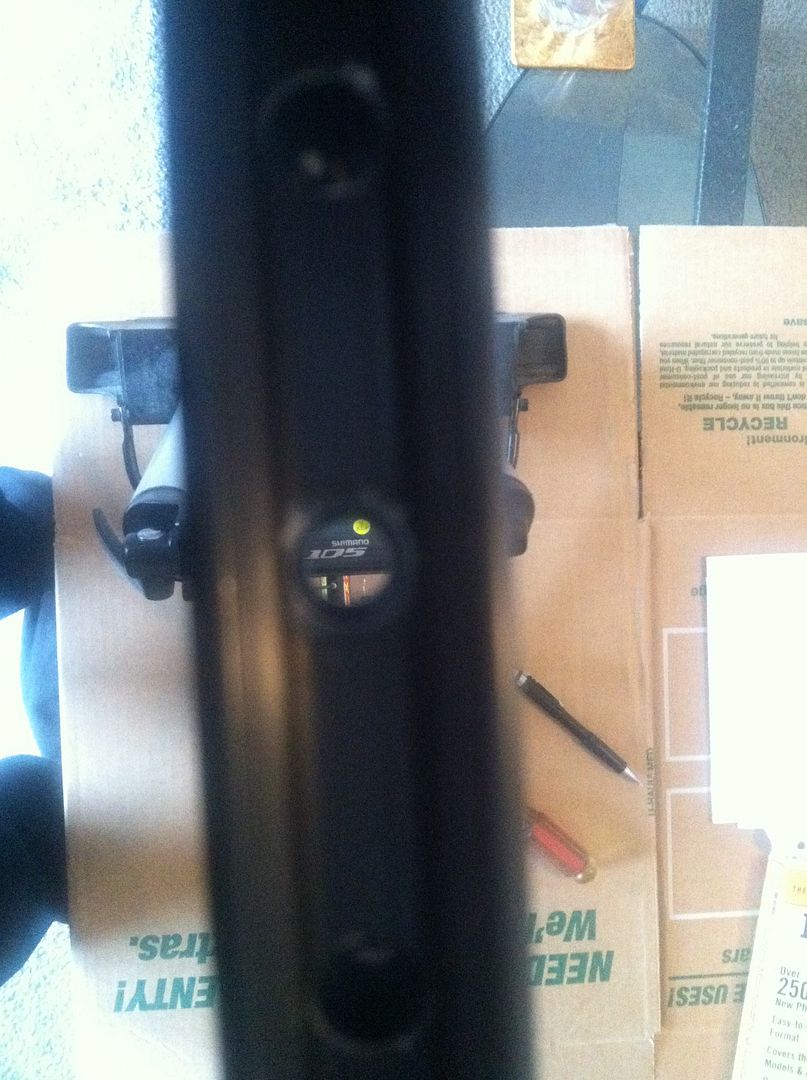

advising a buddy building his first wheelset. He sent me this tonight
so proud
