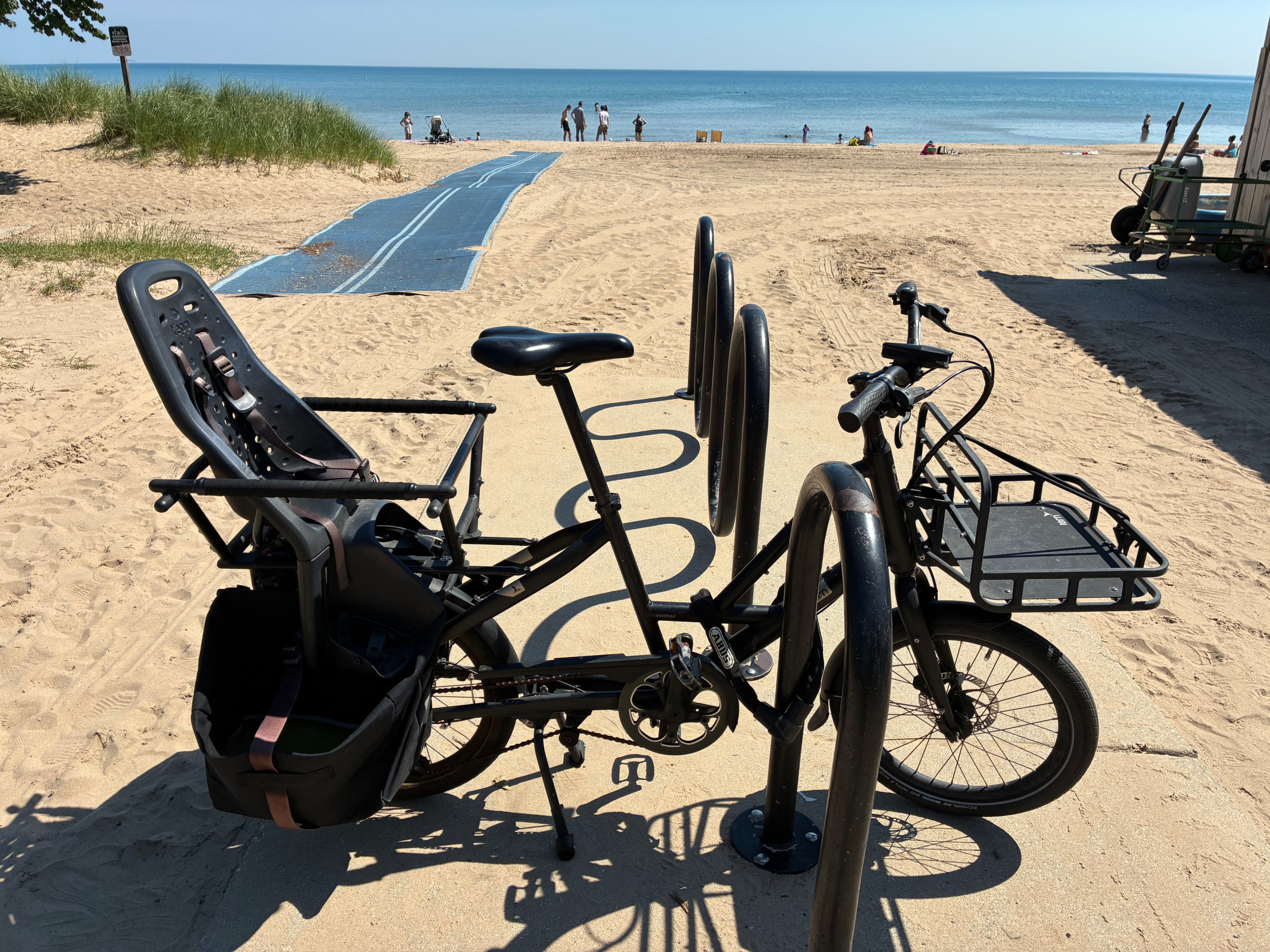

Not much out there in the world of acoustic longtail these days. I was ogling this tern short haul the other day. Seems p sweet.

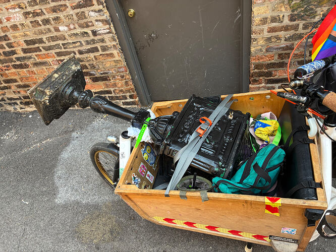

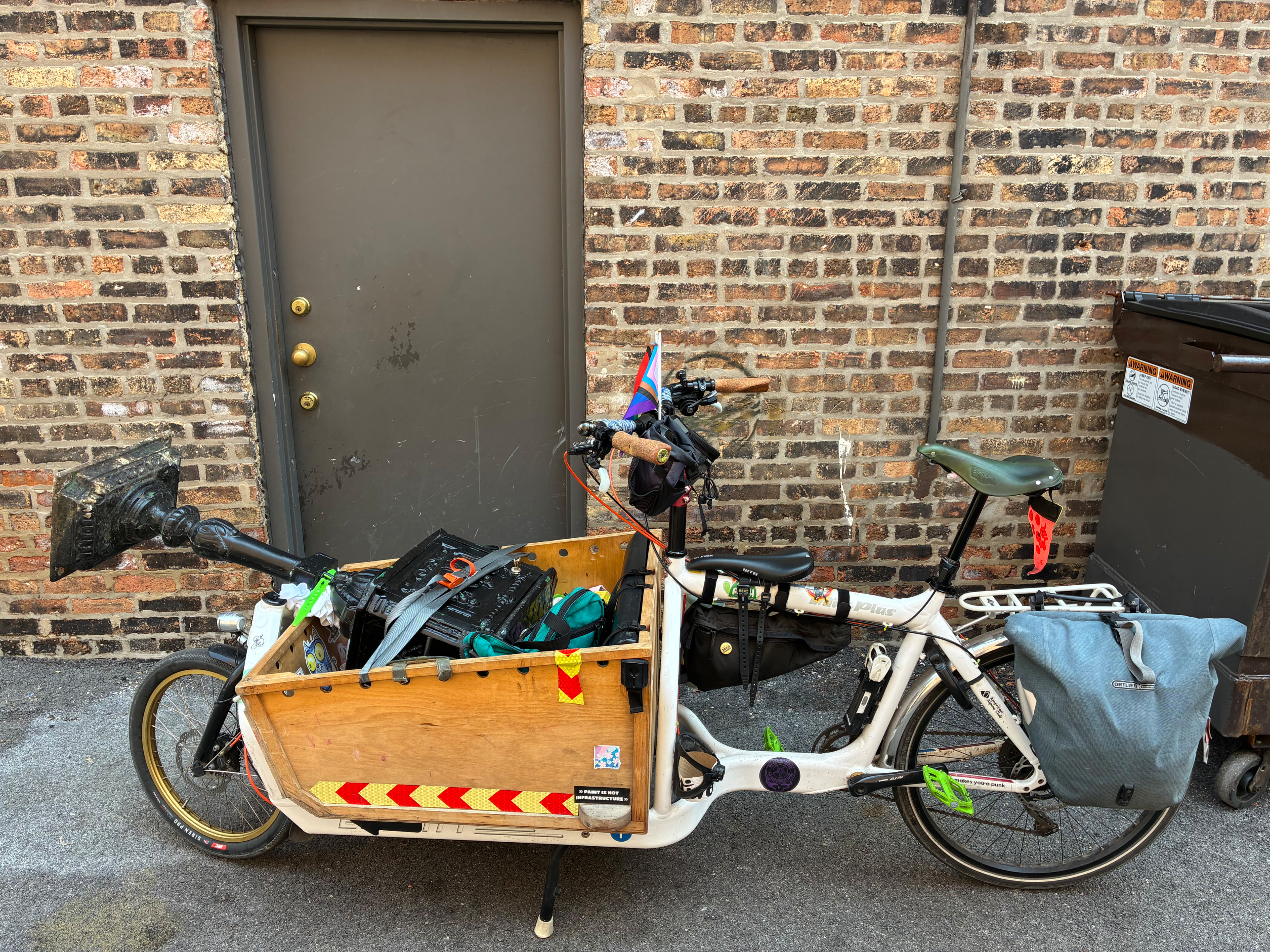

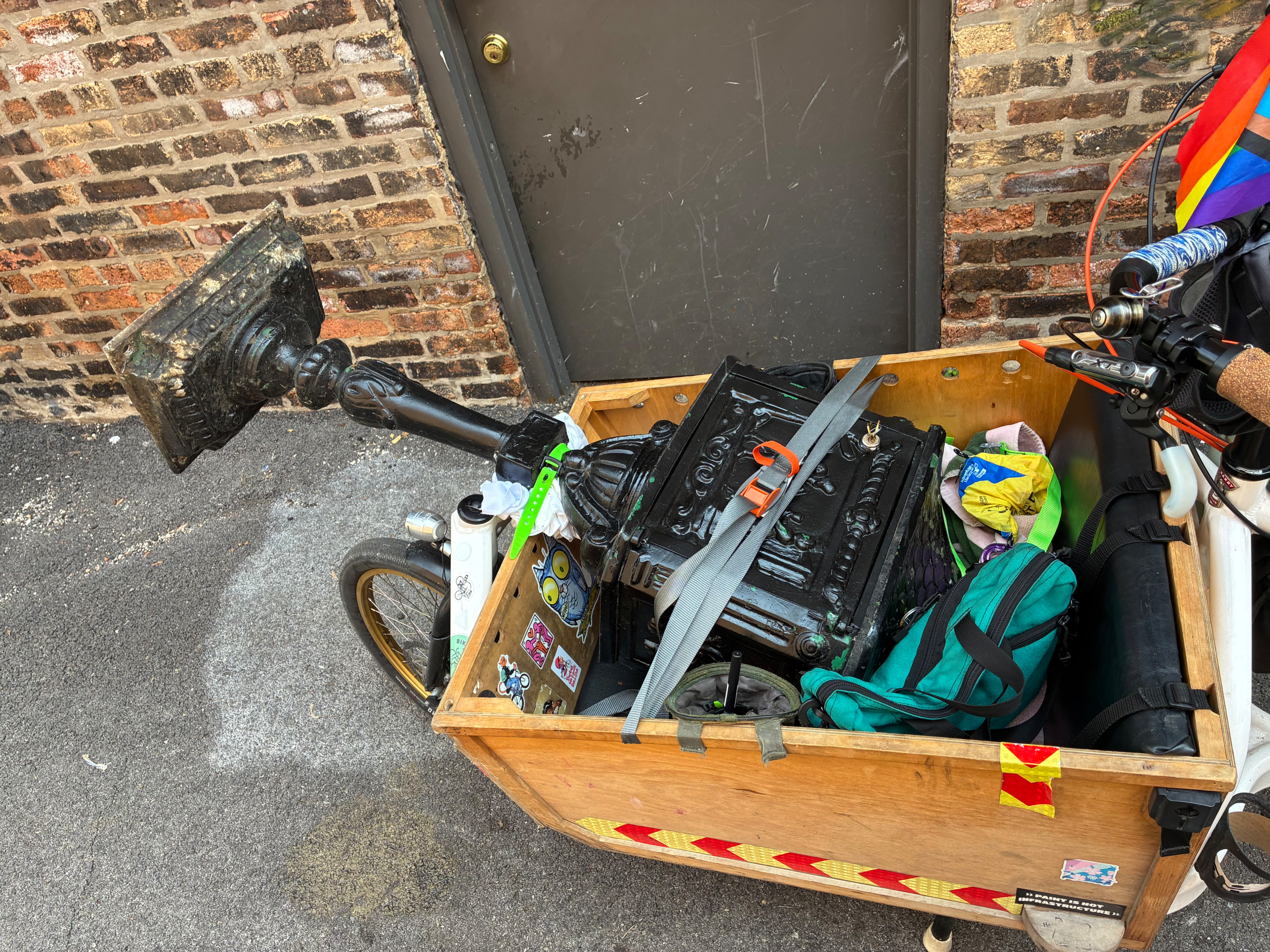

fancy mailbox?
or did you rob a church?
Free cast aluminum mailbox.
