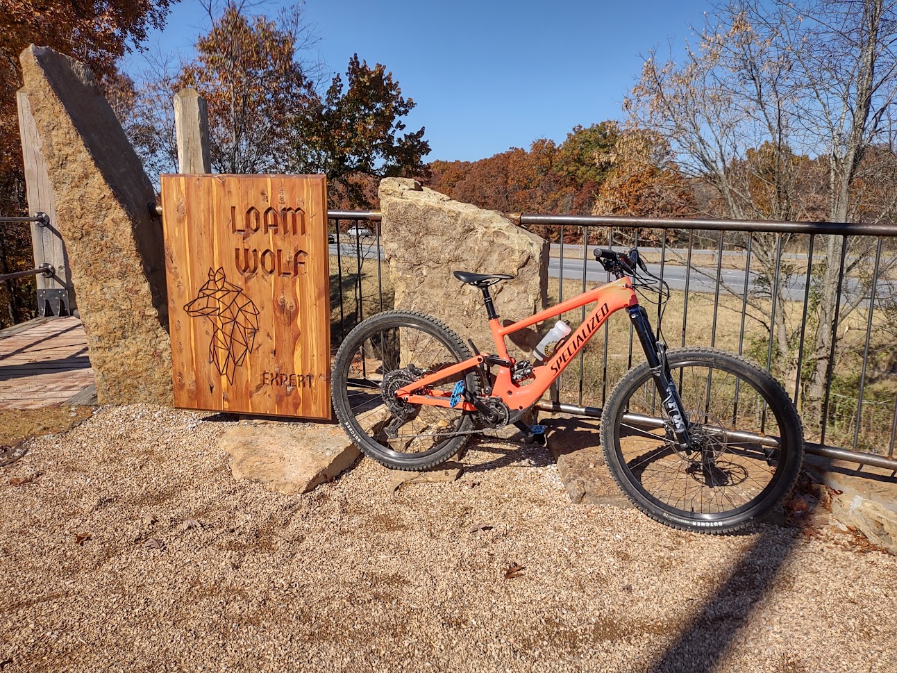

I have both the Kenevo SL comp (that but black) and Levo alloy Comp this week. They both are fun. Yesterday did 22 miles on the full powered levo. Def a bigger bike, you do feel that. Only used full turbo mode to get home before dark. Both are def fun bikes. But I do get the idea that the SL (or any light e-bike) still feels like a regular trail bike while the full powered bois feel different, heavier, still fun, but you gotta be there to push them.

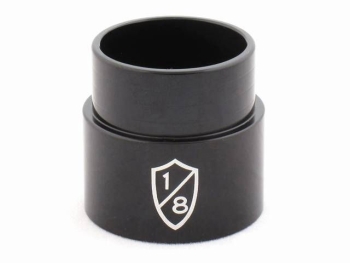

Is there something different about the 9/8" steerer on dual crown DH forks that would mean this won’t work on a “regular” 9/8" fork?
lol that should work on any headset that uses a 45° crown race
but it’s just a tall crown race to artificially lengthen your fork, not an angleset

the other main way is to extend the headset cup itself
pretty sure I have one in a partsbin

I want to experiment with higher trail. It’s a hardtail 73.5/71, I figure the small additional trail will outweigh sta change.
yeah can just slide the saddle forward for the STA, but the reach will also diminish

I’m not sure, I hadn’t considered that. It’s a 2013-era RockShox Recon Silver, which a quick google leads me to believe - maybe? I suspect the $24 spacer will be the cheapest/easiest route for a little more trail but I’ll look into the fork since more travel would be cool too.
I found my headtube extender, you’re welcome to it for free.99
it’s for an 1-1/8 headtube and adds 20mm
