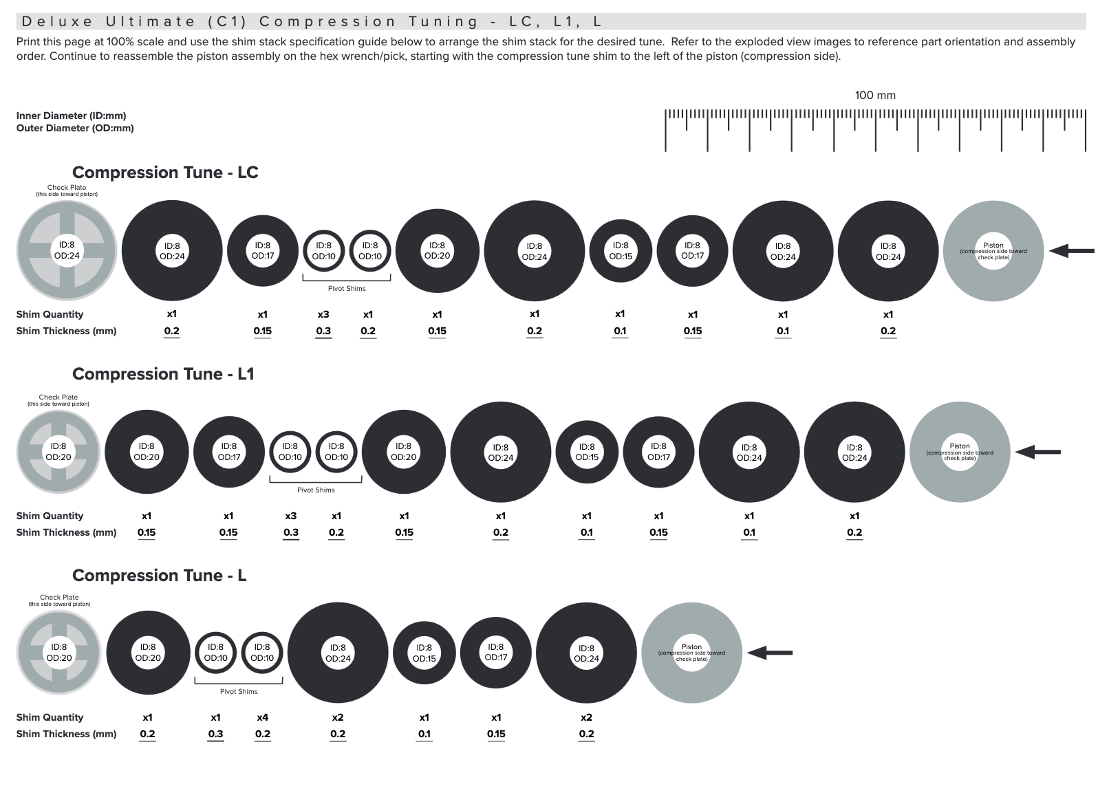

Serial number for my shock tells me:
Compression tune | LC
Volume reducer | 0 Neg 1 Pos
Check Tune | 0 - Light
Seems like this one has a very light tune, which I take to mean not the tune I want for making the trail that I prefer to ride on my bigger travel bike fun on this 120mm bike.

And the new question is trying to figure out what my compression tune is supposed to feel like relative to the other possibilities.
These shim stacks got me like

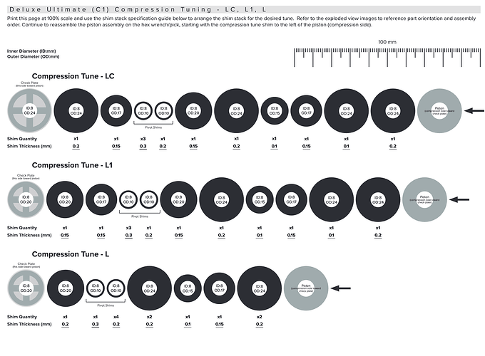

Anyone know what LC, L1, and L mean? One would think this explanation would be in the tuning doc, but it ain’t.
Does this mean anything to anyone?
My understanding is more big shims = more resistance/damping, yeah?

I think I’m just gonna email rockshox and ask what LC, L1 and L mean. I don’t need to get super deep into it.

Yeah this is what made me look at the tune on the shock. If LC is the lightest compression tune in the rockshox deluxe ultimate then it is probably not the right one for me and this bike that has geo identical to my enduro bike but less travel. I remember looking at fox shocks and thinking that the pivot Mach 4 ones would match this bike well, but I don’t think that I ever found a similar bike with this new RS shock. After this ride I think that my fork actually feels fine.

If you shock currently has a L tune from RS, you might try a M tune to get closer to the NS spec.
My anecdotal reading indicates that LC is the lightest of them all. It seems to go: LC, L1, L…
