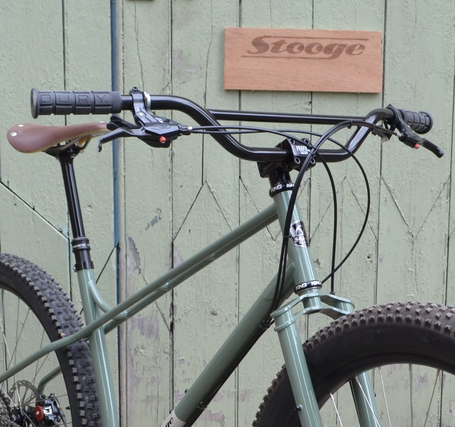

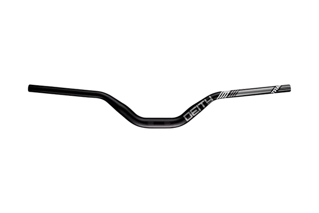

I would not recommend sizing down because you will loose stack. Ride the size that works length wise, then add some riser bars if you need more stack. Stems are all gonna be like 35-45mm on a trail bike so you dont have a lot of opportunity to go shorter.
You can even go full rusty fit with bars instead of a spacer stack.
That’s great, I didn’t realize this was accepted practice for MTB
Just keep in mind that higher bars does change handling a bit, but you’re more dynamic in position on the mtb, so you just need to occasionally pivot forward to grab more front wheel traction on steep climbs and bend the elbows a bit more for front wheel grip on descents.
You can thank Dakotah Norton for paving the way for high rise bars to be cool again.

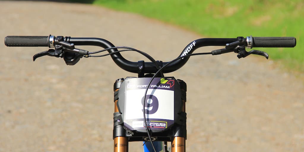

Neat thing too is most of these alt bars have more backsweep, which might even mitigate your reach issues even more.
[edit: I sounded like a dick to amy before]
I have those on my DJ and they’re so good. It really makes it feel like I’m 50/50 on each wheel compared to the stock 800mm wide shorties.
I actually saw those bars when looking to decrease reach on the Endpoint, so maybe.

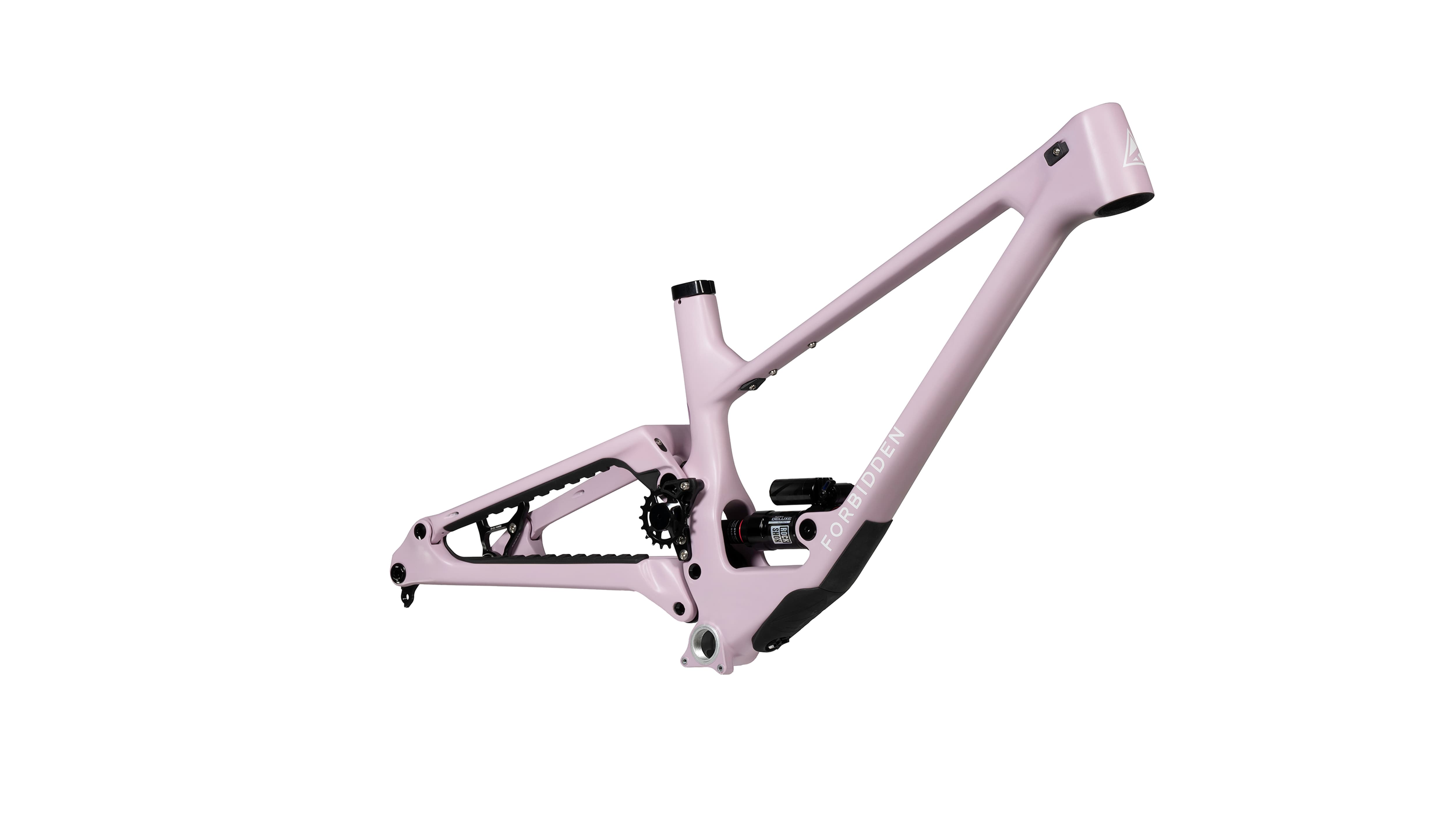

Got this jawn incoming. Gonna move my stumpy evo parts over. But will need new headset and drooper for now.
Trying to figure out how to add a bit of flair. Thinking maybe some turquoise stem and other small accents (already have stem on said stumpy). did see burgtec has turq udh to really balance it out.
Other thoughts were purple, but that ish is really hard to nail down with varying annos.
