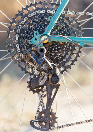

But why does the knucklehead have to adjust the ‘b screw’ ? Wtf is he even talking about. His image would bemefit from omitting all bike mechanic details.

Because he’s using a non-slant-parallelogram, 1x-specific SRAM rear derailleur on what’s effectively a 2x setup.
<gear nerd>
The slant-parallelogram derailleurs that we’ve all been riding since Suntour’s patent expired in '84 are designed such that the angle of the parallelogram is what keeps the guide pulley tracking close to the cassette cogs through the entire gear range. The guide pulley is very close to the cage pivot (and on some newer designs, actually concentric with the cage pivot), so that the pulley position doesn’t really change when you shift into a different chainring and the cage pivots to a new position. This allows the derailleur to properly operate in all of the cogs in each of the chainrings.
(Aside: The angle of the parallelogram is the main defining difference between traditional “road” and “mountain” derailleurs. You could put an extra-long cage on a road derailleur body, and the guide pulley would just run into the big cassette cogs. Similarly, put a short cage on a mountain derailleur body, and the guide pulley will be floating in space way away from the cassette in the 25T “big” cog.)
On SRAM’s 1x system (and the new Shimano XTR 9100 1x derailleurs), the parallelogram isn’t slanted anymore. Rather, the guide pulley is highly offset from the cage pivot - so the rotation of the pulley cage is actually what re-positions the guide pulley into the correct location for each cog. It should be obvious why this won’t work with multiple different-sized chainrings.
So that’s why he’s twiddling the B-screw when he shifts with a stick.
(But for fuck’s sake, he’s friction shifting the rear already. He should just throw a Shimano slant-parallelogram derailleur on there; I’m sure an 11-speed XT long cage would work with 12-speed chain and a SRAM 10-50 cassette, and then he wouldn’t have to twiddle with the derailleur every time he wants to be in the other ring)
</gear nerd>

Interesting. Thanks for clearing that up. I got out of wrenching before all the 1x so I don’t know much about it. It also compound his dipshittery, which is a plus

. Looking at this photo really illustrates these concepts. You can see how shifting into a smaller chainring would cause problems

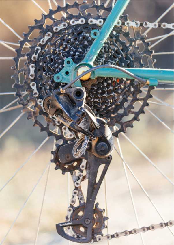

That’s curated bullshit; it took many years of practice to artfully make your POS fopmobile look like it’s someone’s first attempt at assembling a bicycle.
It’s extra in case the cable breaks; it’s effortless trolling; he couldn’t find the clippers so said yolo; it’s conscious dgaf; he finds purity in unbroken things; it’s a koan
And it complements the cancerous growth of fender eyelets on the rear dropout!
If you leave extra cable
The probabilistic distribution of cable breakage is spread beyond your derailleur
The possibility that the cable will break in the unused section reduces the probability of the cable breaking between shifter and dangler
cable arbitrage
