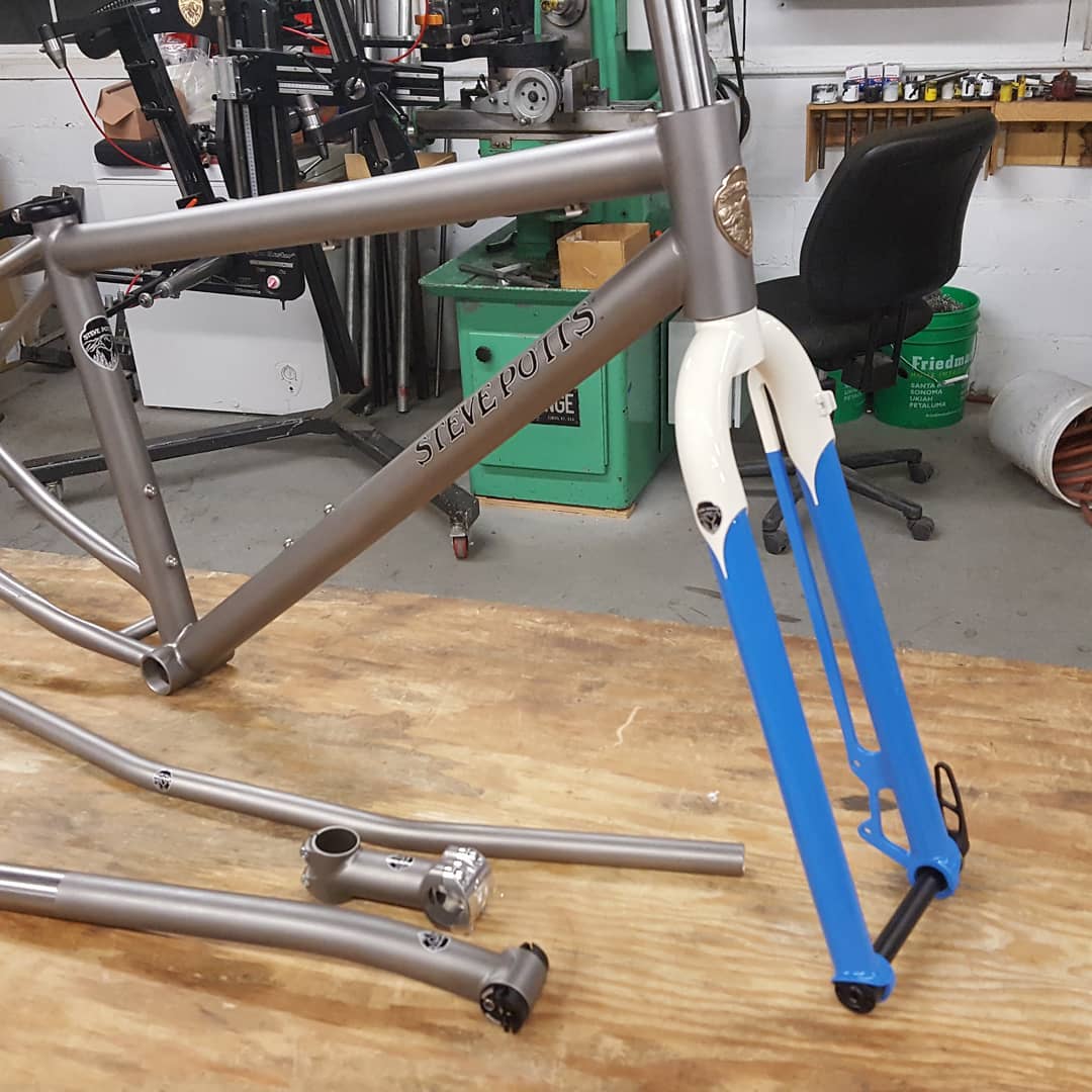

Take a look at this Steve Potts fork:
why does it have a straw from the disc mount? does it get thirsty for hydro fluid?
It’s for on-the-fly bleeding of SRAM brakes.
Anti-jackknife, I’d guess, though the fork blade seems stout enough to get away w/o it?
Mountain bike forks see a lot of deflection under braking, even with large tubes. If that helps any, I’d say it’s worth it.
Steve potts probably knows how to make a fork.
Also it’s $1k+ so I’d rather buy another bike
