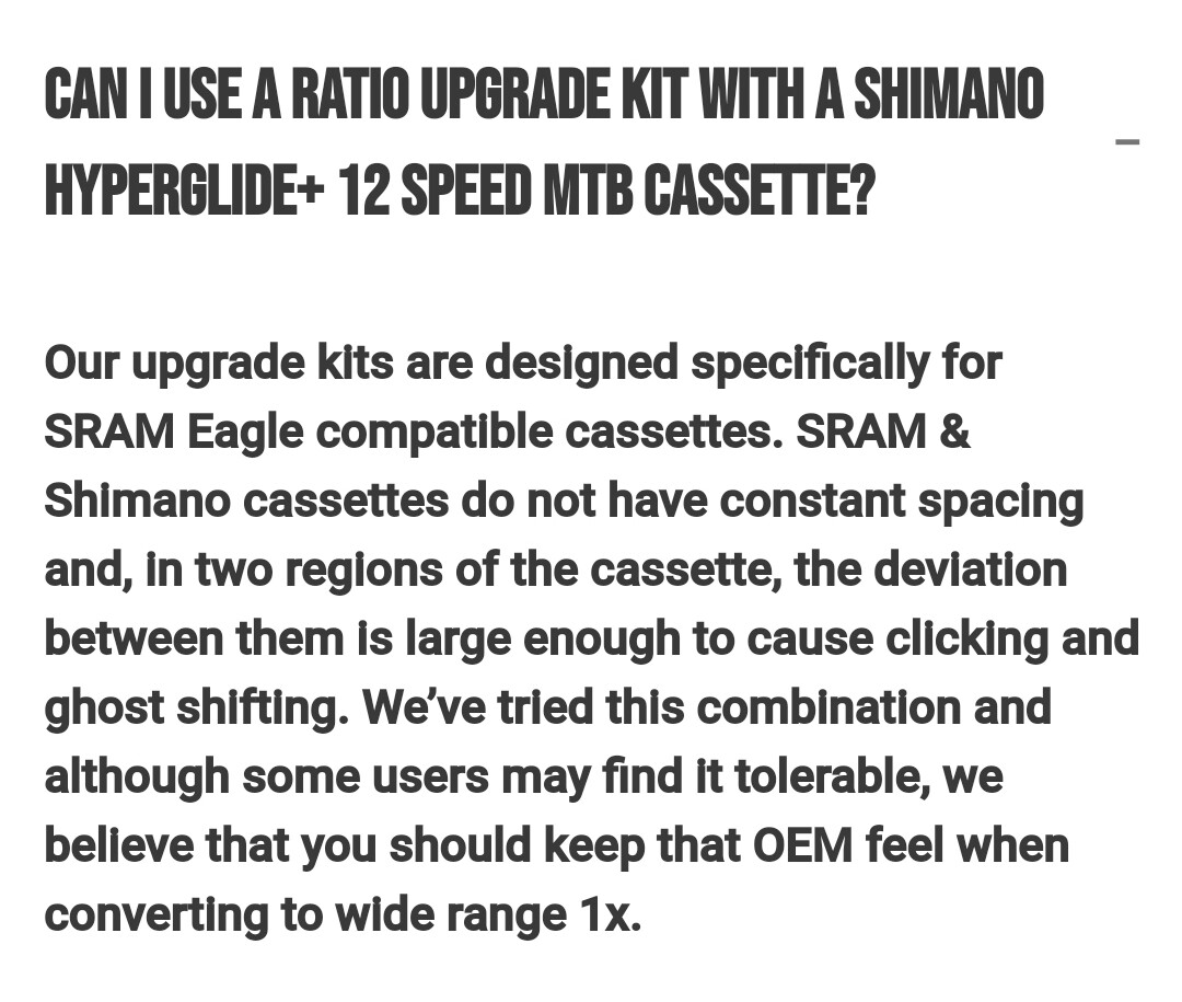

Some peoples who I normally trust suggested that the 12 speed Shimano chain’s power-link is problematic on sram stuff. But you can mix and match cassettes, but this is not what the Ratio Tech folks say. Has anyone run 12 speed Shimano cassettes on sram danglers or vice versa?
The Ratio faq has some interesting stuff in it.
