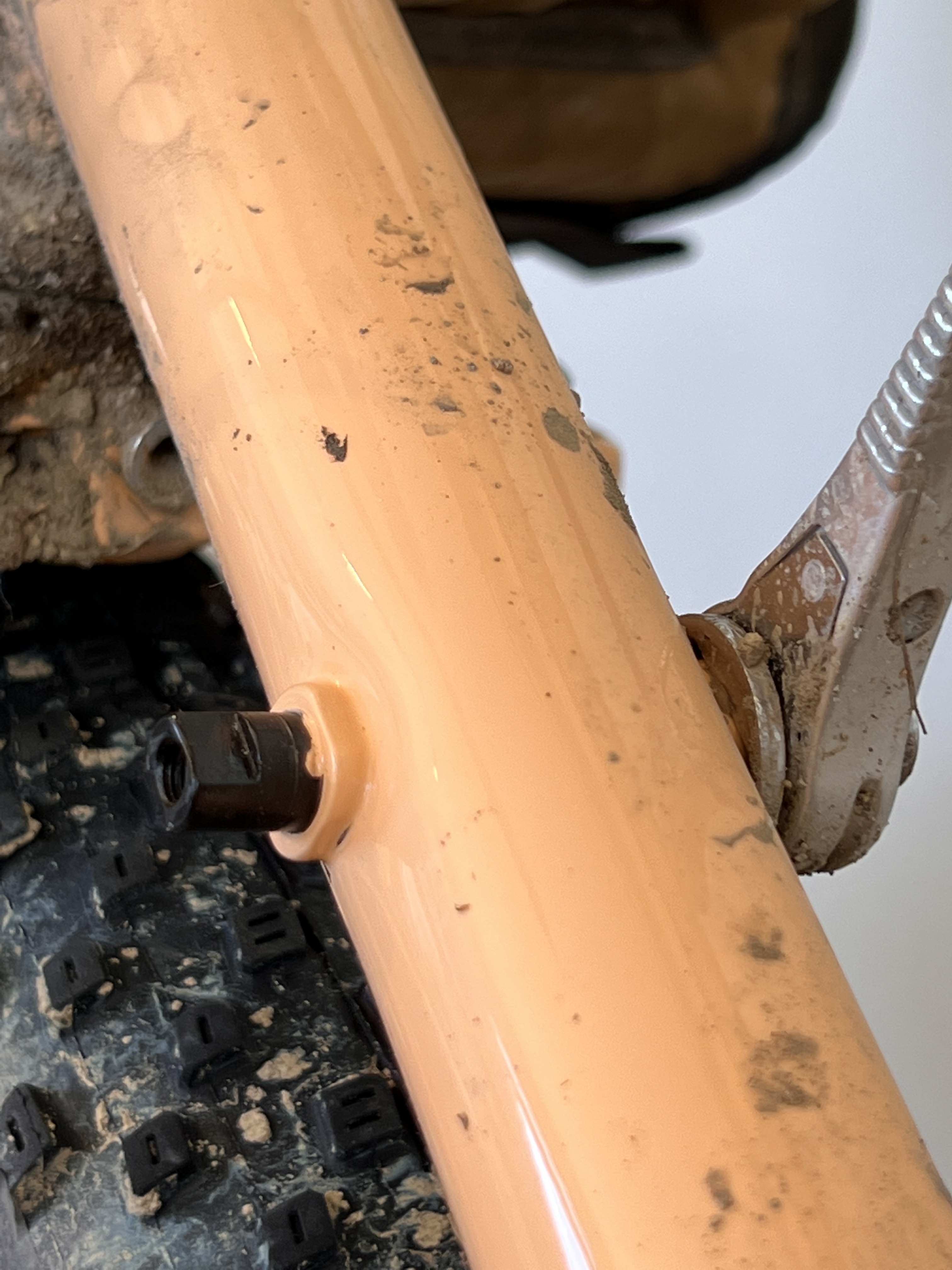

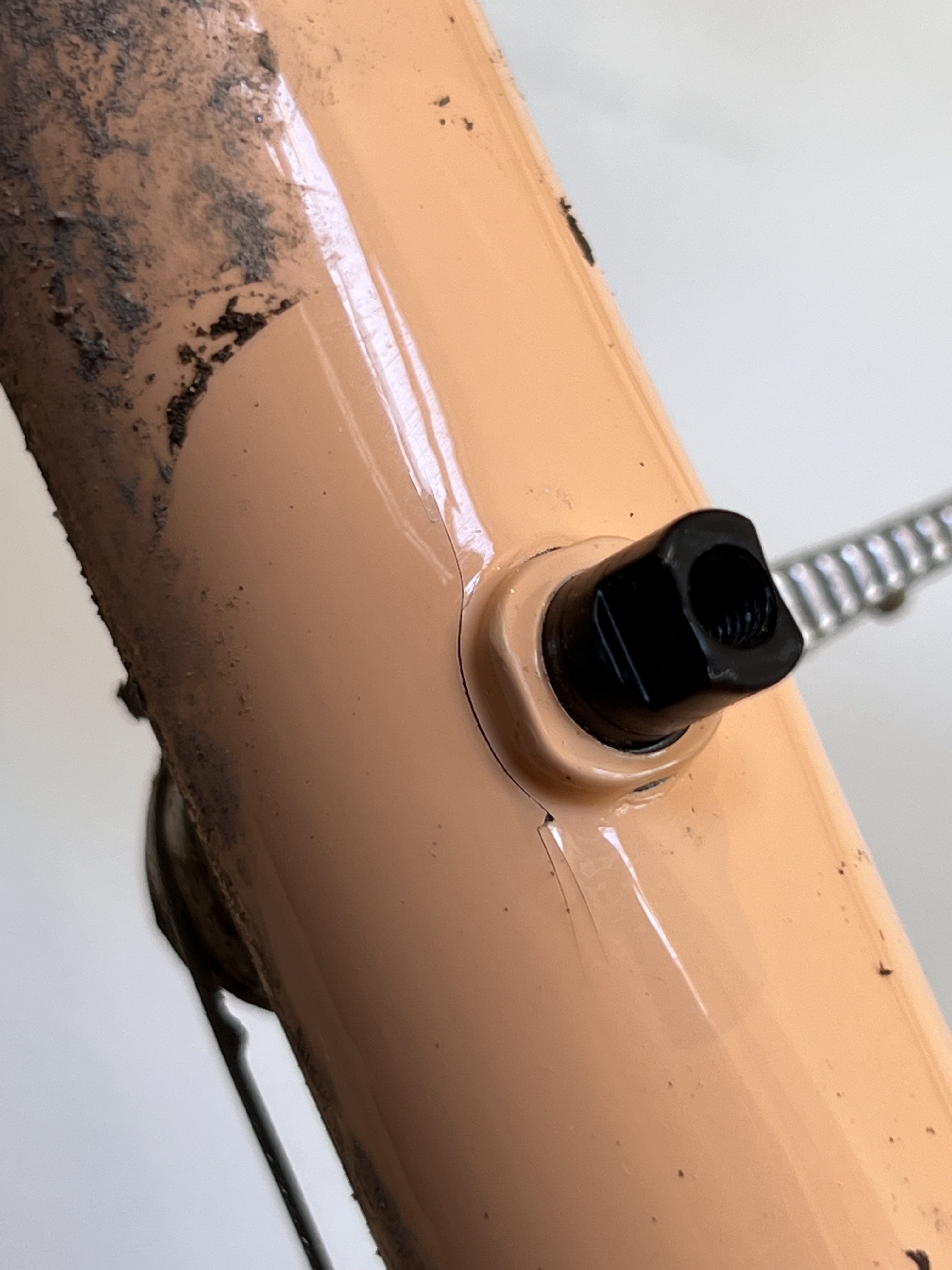

Crashed my new bike and dented my left down tube shifter boss in. Small crack not sure if just paint or the steel too. Tarck what would you do?
I believe it’s Reynolds 853 tubing if that matters…
I am anxiously awaiting the diagnosis I see Jimmy typing
Oh buddy that sucks. I’d watch it like a hawk.
If you can swing it, get a replacement frame now, ride borked frame until you feel it’s time to let it go.
IMO manufacturer sympathy is likely highest right now, when you just got your shiny new bike built up. Also much better chance they have a frame in stock. I’d see if they would give you a discount on crash replacement frame or if they have a blem or something else.
Unfortunately I wouldn’t be able to swing replacement frame anytime soon. This was supposed to be my ā€œforeverā€ bike after all.

Looks like just a crack in the paint, can investigate witb a sharp blade to be sure.
Please explain
scrape off paint. Is crack in metal? bad. Is metal ok? less bad.

I’d throw an M5x.8 screw in that boss and give it a tug and see if I could get the dent out. Otherwise:

Yeah I don’t think I’d be bothered enough to stop riding it. I know it sucks to crash a new bike and see a fresh dent, but if you can still mount a dt shifter and use it then you’re good, atmo
