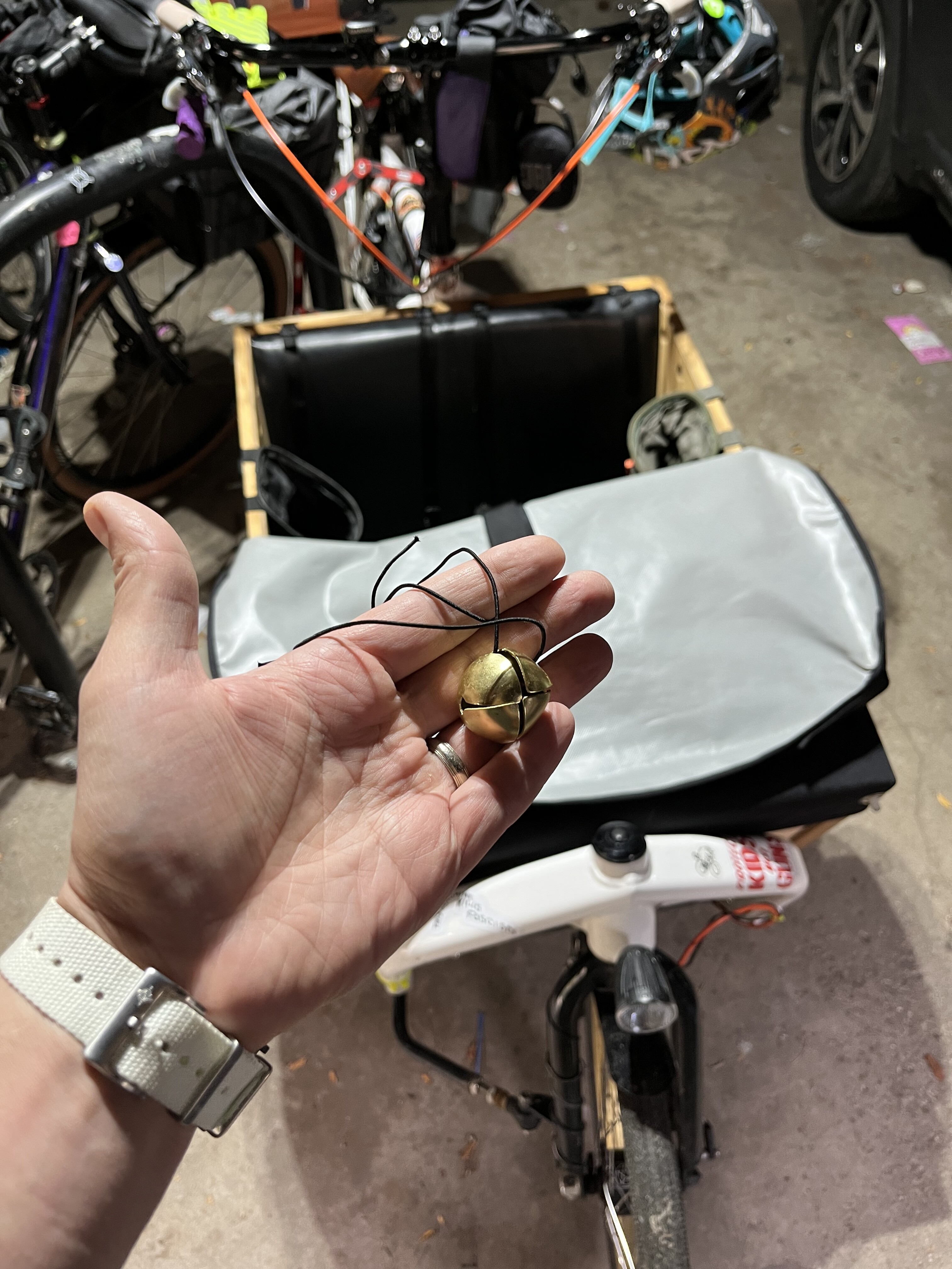

The other day I was chasing a strange creak/click on my Bullitt. Turns out it was another goddamn jingle bell! This is the second time this exact thing has happened to me. Could it be something totally random?

are you haunted by jingle bell gnomes or something?
