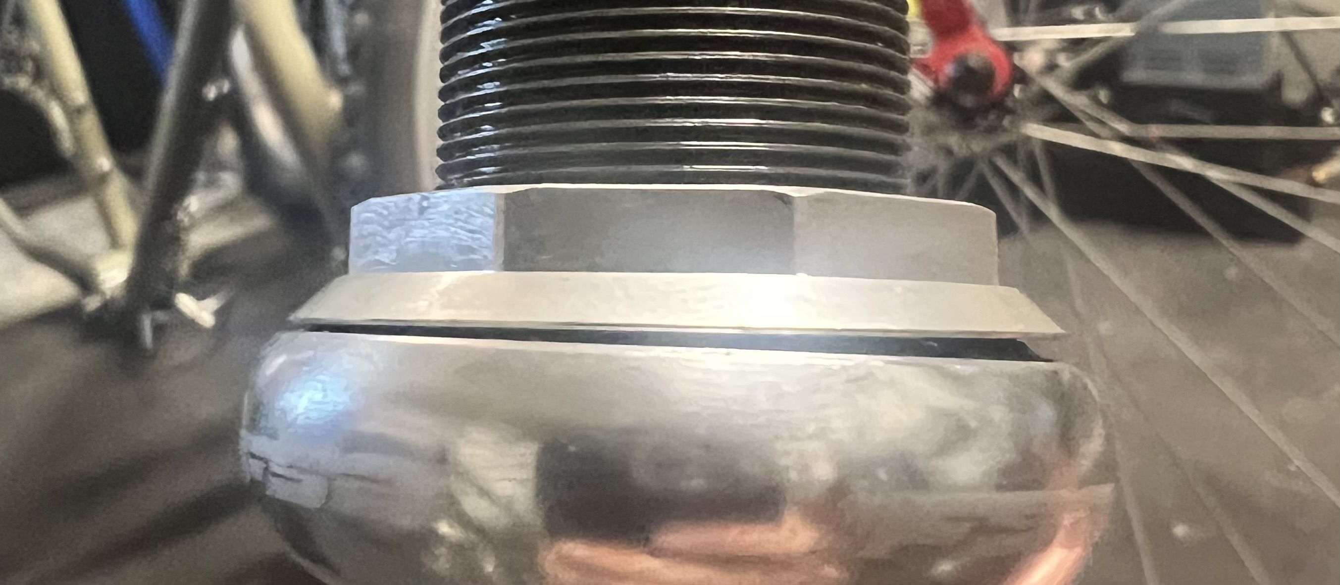

Is there a chance that it is me, and not the frame? I feel like no because there’s no way cups made of alloy would have deformed a steel head tube.
It is not the crown race because turning the fork doesn’t change the “lean”. I tried a known good fork and headset (popped these out, pressed in other ones) with same crown and still the same
Face and ream time?
Yes
Do you have a set of calipers long enough to put along the head tube? Would let you eyeball how off square they are

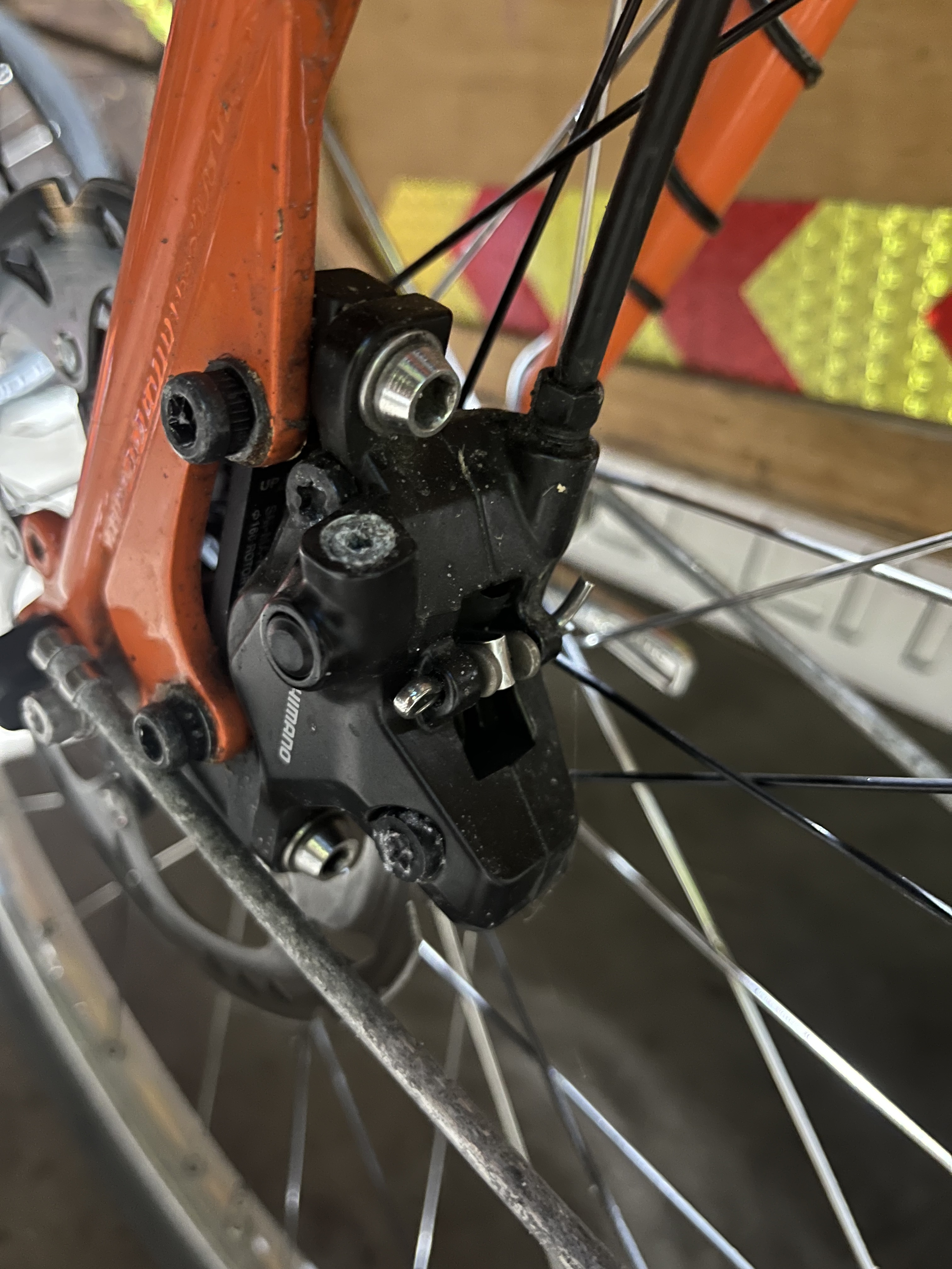

The front brake on my Soma feels really really stiff and has hardly any lever pull before full engagement is reached. The rear brake feels normal.
Is the front over bled?
How do I walk that back?
Just open the bleed nipple and the lever and let a few drops fall out?
Open the lever and suck up a few drops?
Do a full bleed on the system?
In the Shimano tech doc, there is a step where you close the reservoir at the top and do a gravity bleed from the caliper. I usually skip it, but it might solve your issue.
Basically, open and quickly close the caliper bleed nipple a few times. Eventually, the amount of oil that comes out will be very little.
Thanks. I’ll give that a shot.
I’ve read some say not to push hydro pistons back when system is sealed (ie do it with master cylinder open) to be kinder to the bladder etc. Is this a thing? Do the pro mech’s here care?
I don’t. Sometimes I’ll cup bleed a shimano lever after a pad change but it usually just feels fine without.
I’ll open the reservoir cap when resetting pads sometimes. As a treat.
But mainly when I find a bike that was cup bled with old pads installed.
Wait a sec, where’s the bleed nipple on this caliper? Is it the corroded ass allen screw opposite where the hose attaches?
This thing is different than other shimano calipers I’ve messed around with. I think the others all has a bleed nipple with a little rubber hat that you opened with an 8mm box wrench.
Yeah, the corroded thing is the bleed screw. You can find the bleed port if pop off the little rubber cap next to it.
