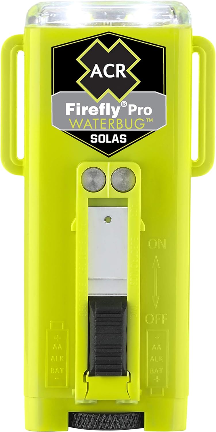

blinking or strobe for daytime is way more visible than a static light, especially now that LED DRLs are so common. at night they become harder to judge speed and position vs static and can disorient other road users
Just don’t hang out on coastlines or islands at night with your bike or you may get a grumpy visit from the USCG.
Seizure info I’ve found online seems to say that the image has to occupy a large part of the person’s vision, and flash at a higher frequency (10-20 Hz). That’s a lot different than a blinky light, which is why I asked.
PDW danger zone has a slow pulse which I like to use because it’s not flashing but it is changing so can catch the eye for similar reasons. also has a flashing mode and solid, runs on AAAs.
Conspicuity is a giant complicated topic. There are answers to your questions but they aren’t that easy or simple.
I think it’s ok doing something that helps you feel safer. Additionally, ambulances and fire trucks rely on a lot of solid conspicuity research and definitely use flashing lights.
My buddy who works for the fire dept somehow got a tail light off a fire engine and wired it up as his daily commuter light. You really could see him for kms.

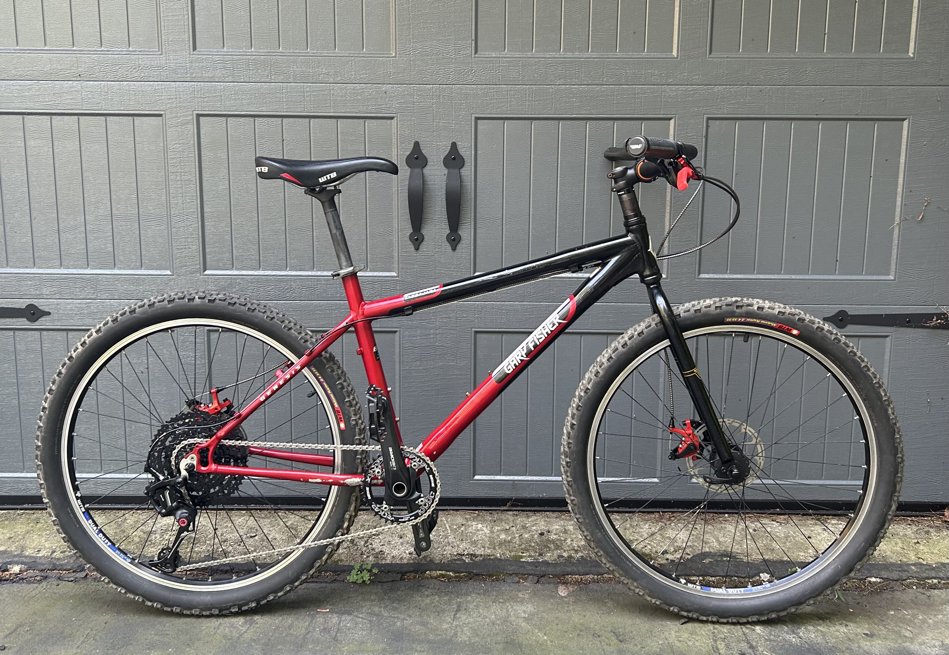

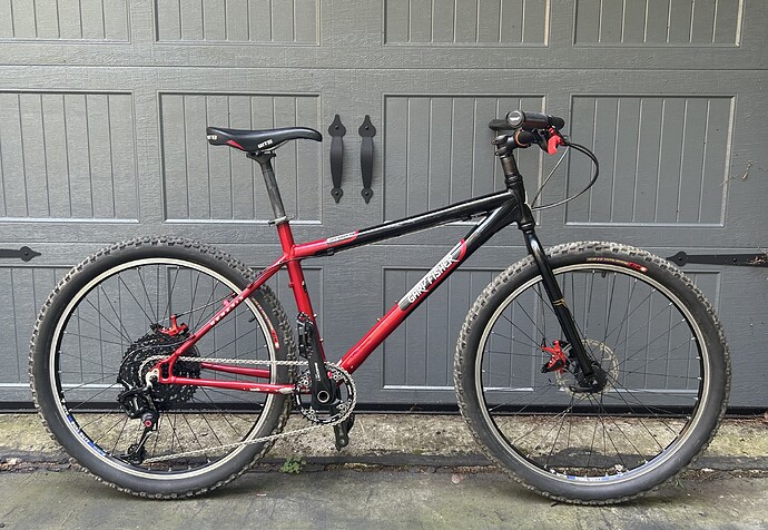

I built this up for kids. Swapped out rim brakes for discs, put Kona P2 26ā€ fork on instead of suspension fork.
Angle app on my phone says 75 st 73 ht. Should I put an old qr Salsa 29 steel fork I have on instead? Old, has no zits, doesn’t seem that much longer than the 26, and might get the angles more normal?
Dither away but how likely is it that your kids notice the angles being a little steep?
They just know whether it rides good or it feels off. Up to me to know why.
That looks like a non suspension corrected fork. Might need a suspension corrected one. Or the 29er.
