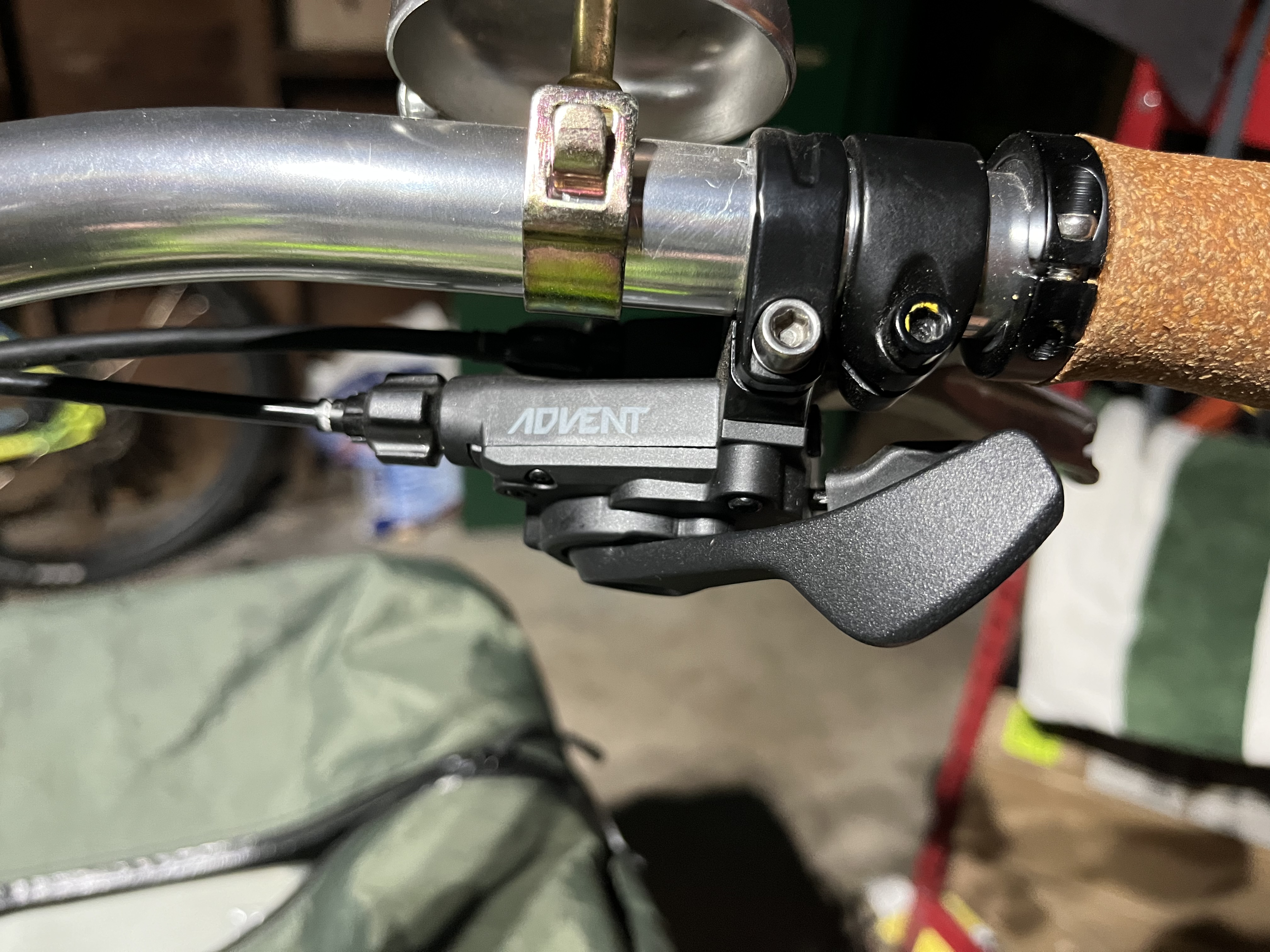

I want to get some chains for Ash’s ebike to keep in stock for when they inevitably break theirs because they refuse to shift into an easier gear when coming to a stop. Should I buy $18 basic sram chains or $39 shimano ebike chains? Probably sram right?
What’s the drivetrain exactly tho?
It’s 9 speed microshift gears with a bafang mid drive.
Edit: is this micro shift? It doesn’t say micro shift anywhere on it. Shifts pretty nicely.
Yeah, Advent is their 9-speed mountain bike line, Advent X is the 10-speed.

Shimano LG chain will run fine on an Advent cassette. Allegedly more durable.
