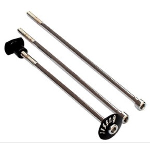

Get some m6 threaded rod, run it from the top cap and out the bottom of the steerer, put a large washer and a nut on each end to apply force to the fork, apply preload and tighten stem, remove threaded rod assembly.
