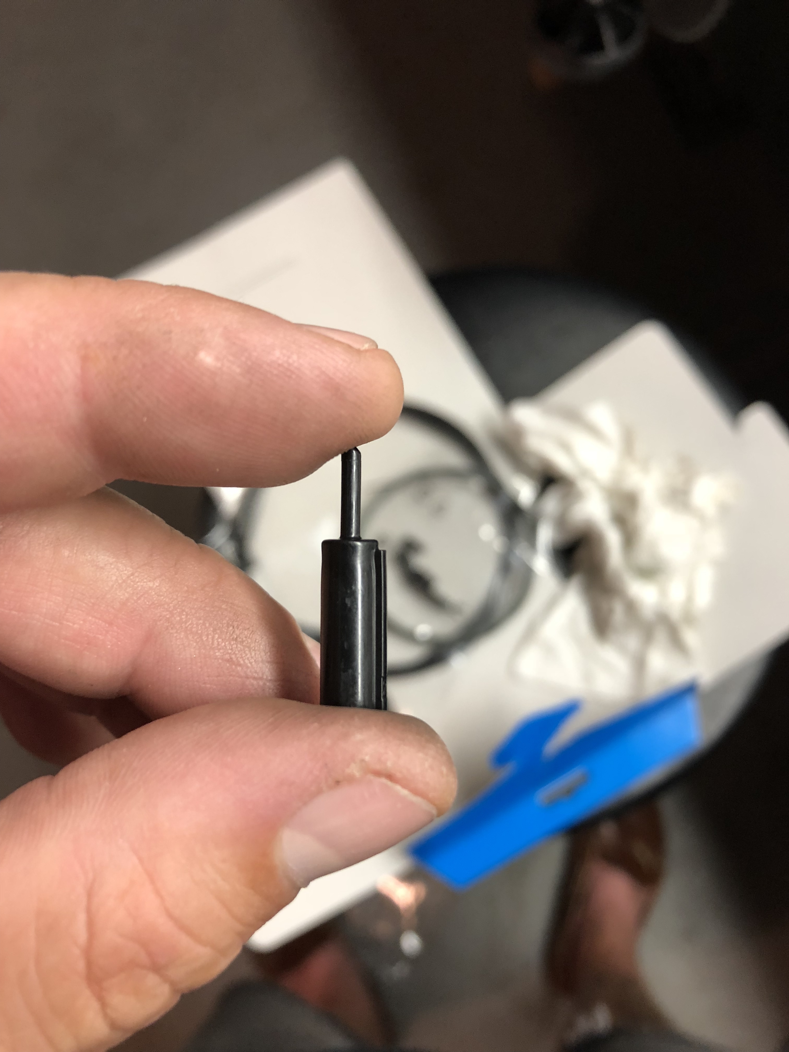

I bought a shimano shift cable kit. Where the hell does this thing go?
Between the shake and the cable housing
Lol well I sure didn’t put it there!

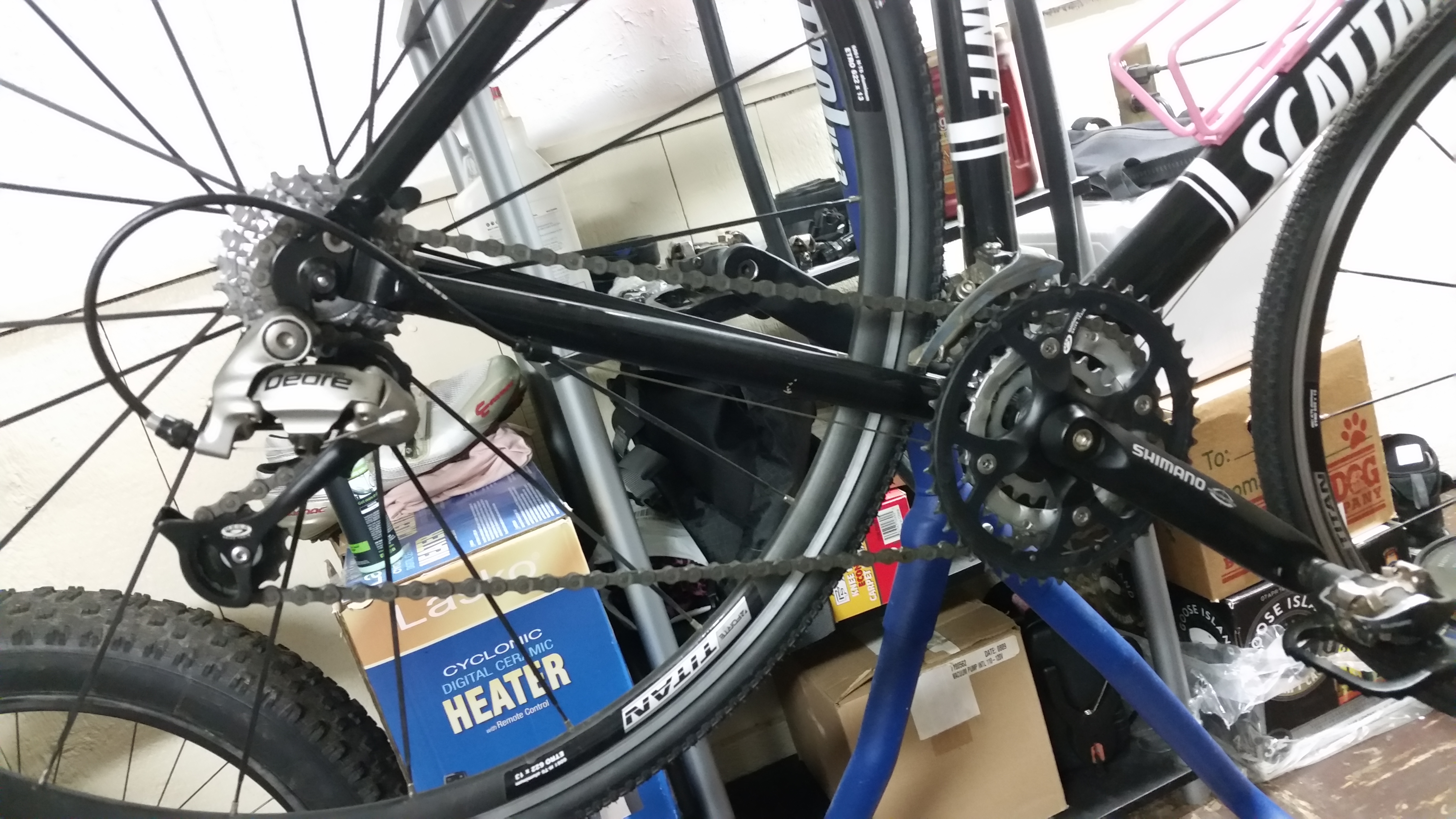

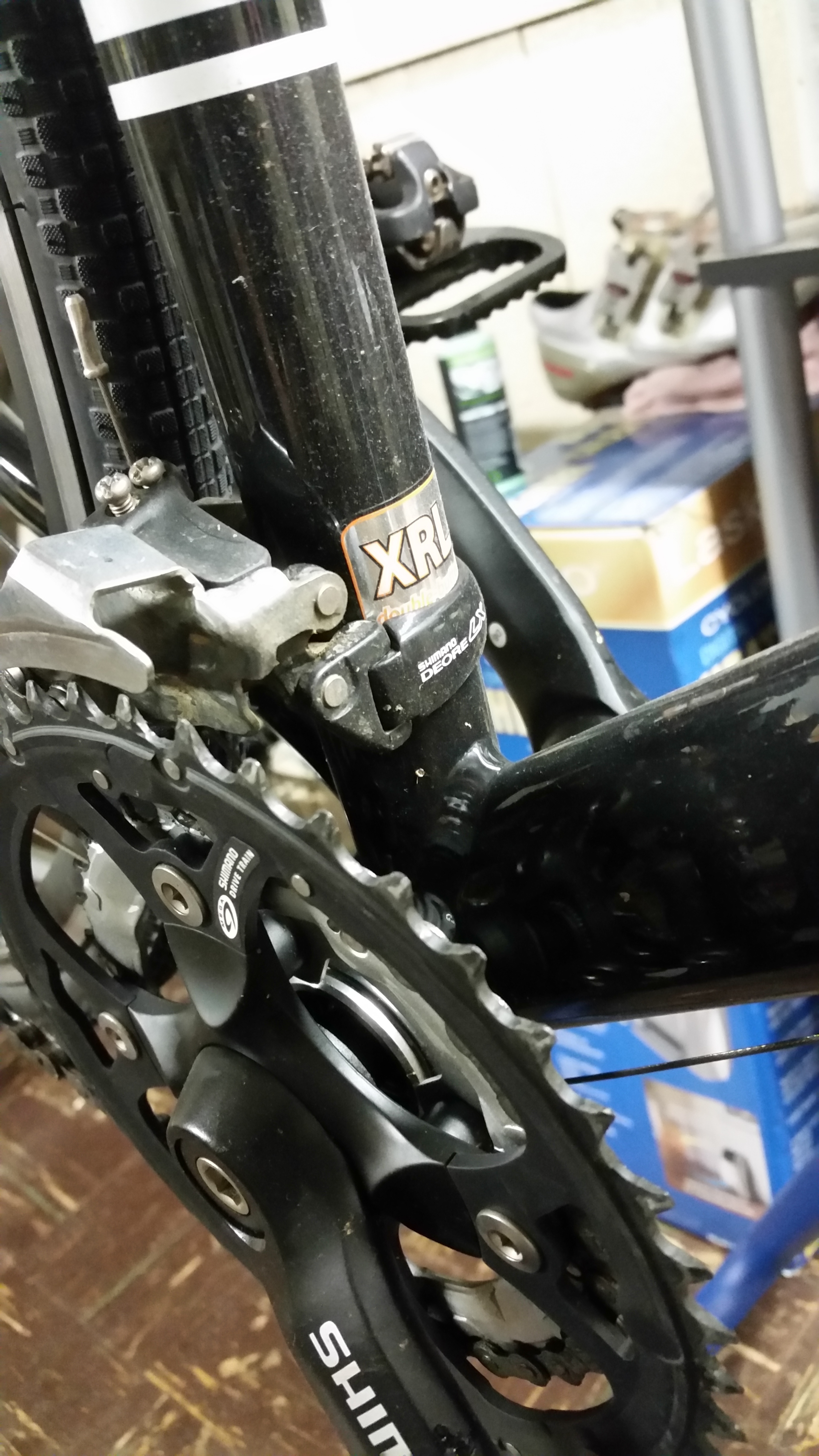

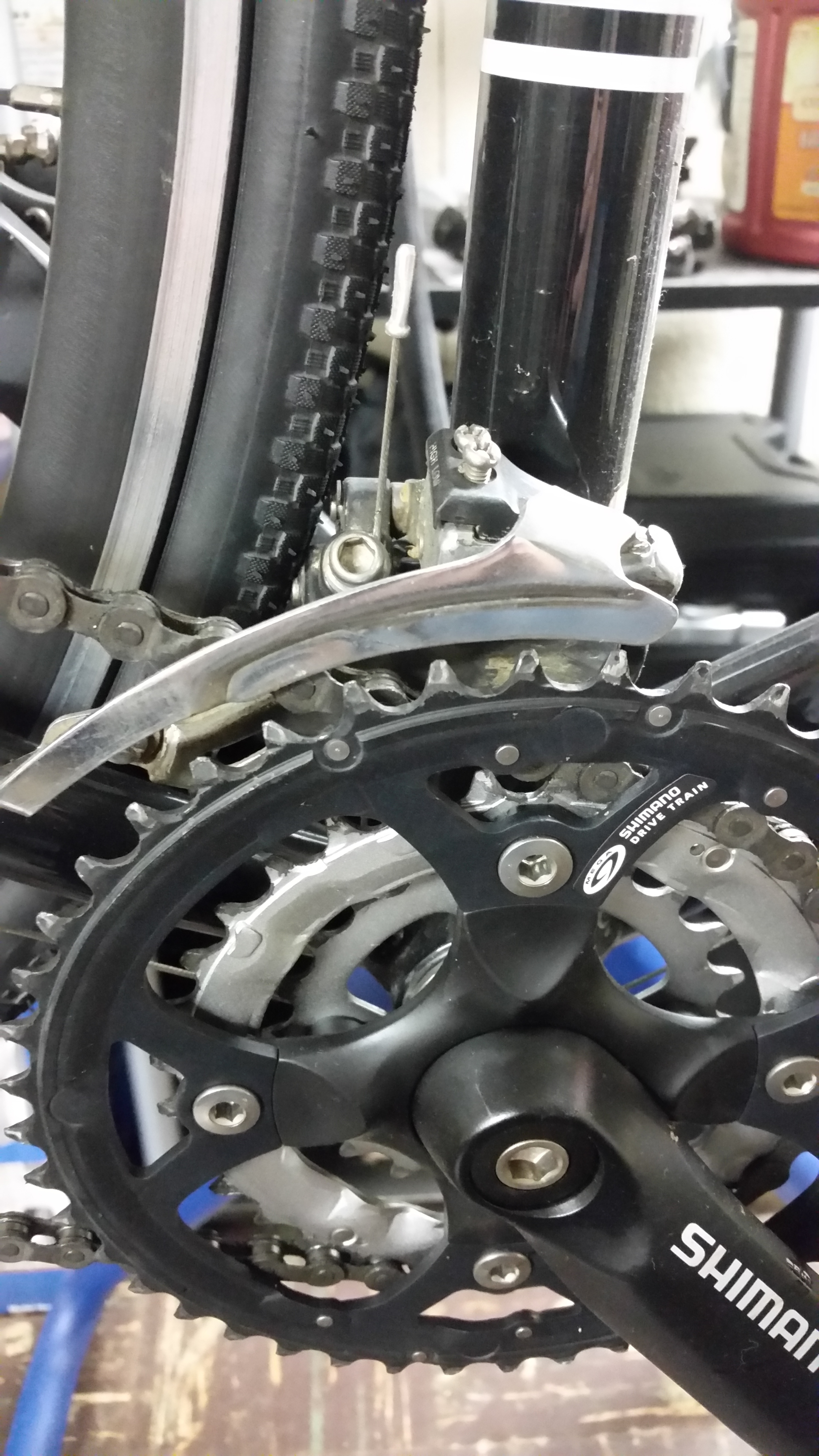

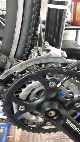

Years ago, flat bar road bikes weren’t quite a thing yet, so I pieced one together for my wife. I just swapped her tires from 23s to 28s, and the rear tire is buzzing the pusher. Anyone know which bottom pull 3x9 mtb crank compatible one I could swap in? Current one is an ancient LX.

The newer stuff like this is a bit more low profile. Something like an Altus M313 may do the trick.

The little raised part fits comfortably into the groove of any modern Shimano shifter.

Cool. Works with bottom pull?
