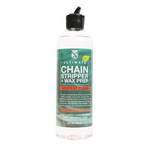

for cleaning the new one an ultrasonic isn’t necessary. Just get some silca chain stripper, it takes five minutes and is super easy. If you are careful it’s easy to filter out the chain goop and reuse it lot.

My girls aged out of their childhood Redline Pitboss and so I replaced a bunch of things and gave it to a neighbor kid . I cleaned the (new) chain with Stripper and added drip wax just because it’s super fast and easy, and because i fanatically hate the goo that comes on chains. probably they will blast it with wd40 later on but i can only control some things in this universe.
Some great reviews on that one but oof, the price. I also can’t get it locally it looks like, and I “have to” get this done before tomorrow (critical mass), but I will keep that on my radar.
Was just gonna use mineral spirits to get the factory corrosion protection grease off and then give it an alcohol rinse. A writeup from Silca also mentioned blowing it out with compressed air which i’ll also do.
mineral spirits totally works but it takes a while to do perfectly and is stinky.
The Silca stripper stuff is spendy but much quicker/less stinky than the multi-step process. I don’t have parts washer so no idea how it compares to that.
