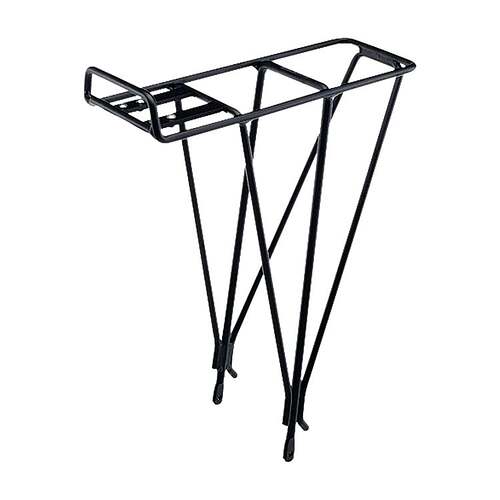

That’s $50 so not a huge investment if you hate it. It would also work with mini panniers.
