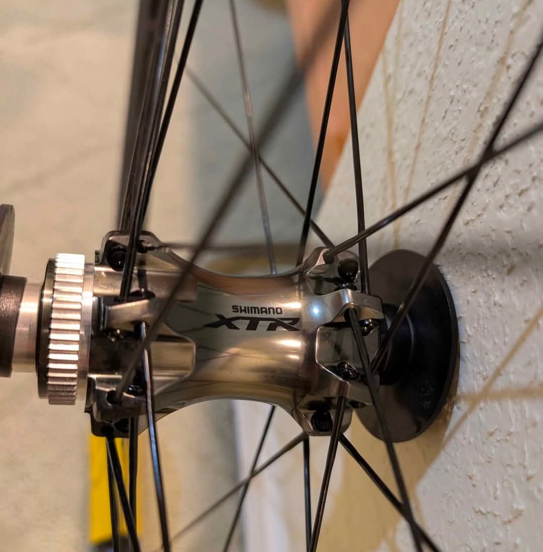

anyone know if I can convert these hubs to QR 135mm?
aren’t they boost?
I would assume so. I just can’t figure out if Shimano makes swappable end caps for these hubs (or at all?)
But if they are boost they’re too wide to fit 135
ohhhhh
that makes sense. thanks
Actually, coming back to this, I don’t know what I was thinKING. There’s only one real choice, considering the current hubs and headset.

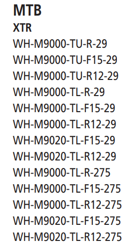

actually boost 26" would be really weird wouldn’t it? ask him for a pic of the shimano code on the other side of the hubs
yeah 26 + boost did not overlap at all, but those look like M9000 era hubs?
in which case they wouldn’t be 26" because those were only made in 29 and 27.5
so they are def not boost, but also not 26" ATMO

ah, I guess I was looking at the m9000 and not 9020.
kinda forgot there are always two lines of xtr.
shimano isnt, however, particularly known for the ability to swap endcaps.
good find. looks like they’re actually aluminum based on that ebay post too.
sounds like i will pass

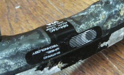

it looks like they are aluminum wrapped in carbon fiber and he is probably assuming they are 26" because he knows they are not 29" and doesn’t know that 27.5" is a thing
ok so i was thinking i was crazy earlier, but there is indeed no 26" variant in the shimano manual.
those ebay ones are rotten as hell, wtf, but they are 26"
so it looks like it would say on the sticker
