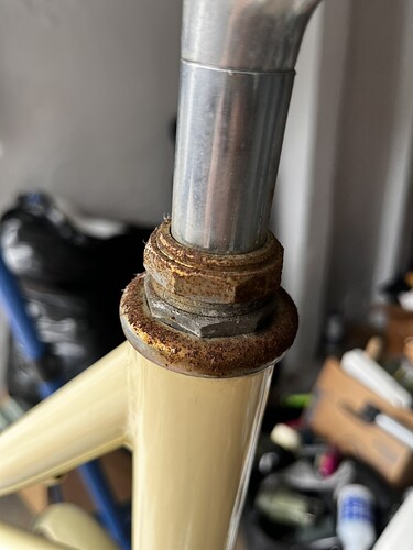

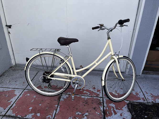

Been fixing up the bike that Kat has had sitting around for years, a Critical Cycles step through that I think is the 6 or 7 years ago version of this Retrospec with basically the same stuff on it but with some absolutely hateful mid-V rims that absolutely hate holding tires. I think I saw a Breezer at Sports Basement with basically the same frame and slightly better components.
We agreed that we didn’t want to do more than tires, chain, cables, brake pads for now, after which point it would just make sense to buy a better bike, since this is a $300 bike from 6 or 7 years ago.

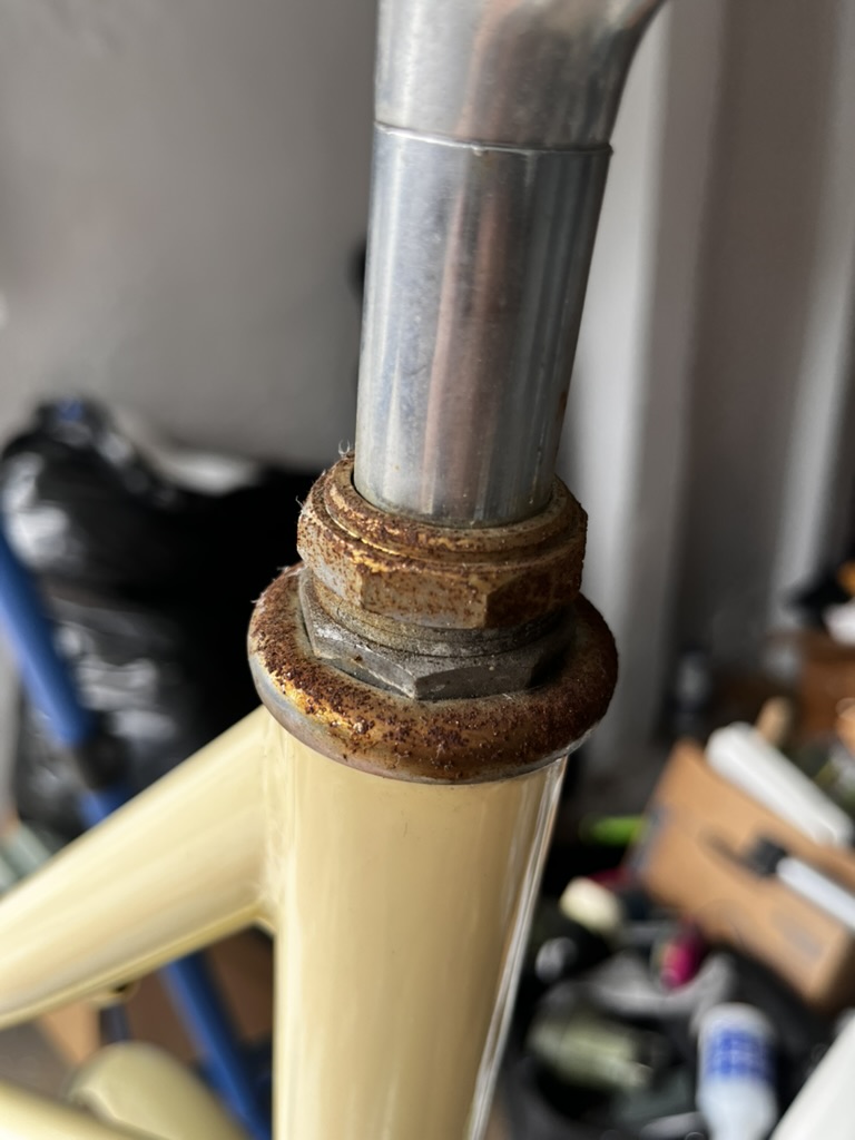

It has lived outdoors or in semi-enclosed places not far from the bay for all of its life until it made it to our garage, so there is a shit ton of surface rust on the formerly chromed bits like the headset and rack. The headset turns freely and doesn’t feel notchy or friction-y at all, so I’m inclined to say that this is just surface rust. How do I get that rust off? Do I? There is no way we are doing a new headset for this bike. This one probably isn’t going to explode on us, right?
The rack I don’t care as much about, since if that’s fucked, we’ll just get a new rack from VO and call it a day. That will move to another bike just fine.

Yeah, that’s what I did, I didn’t describe it well. Headset is fine though.
