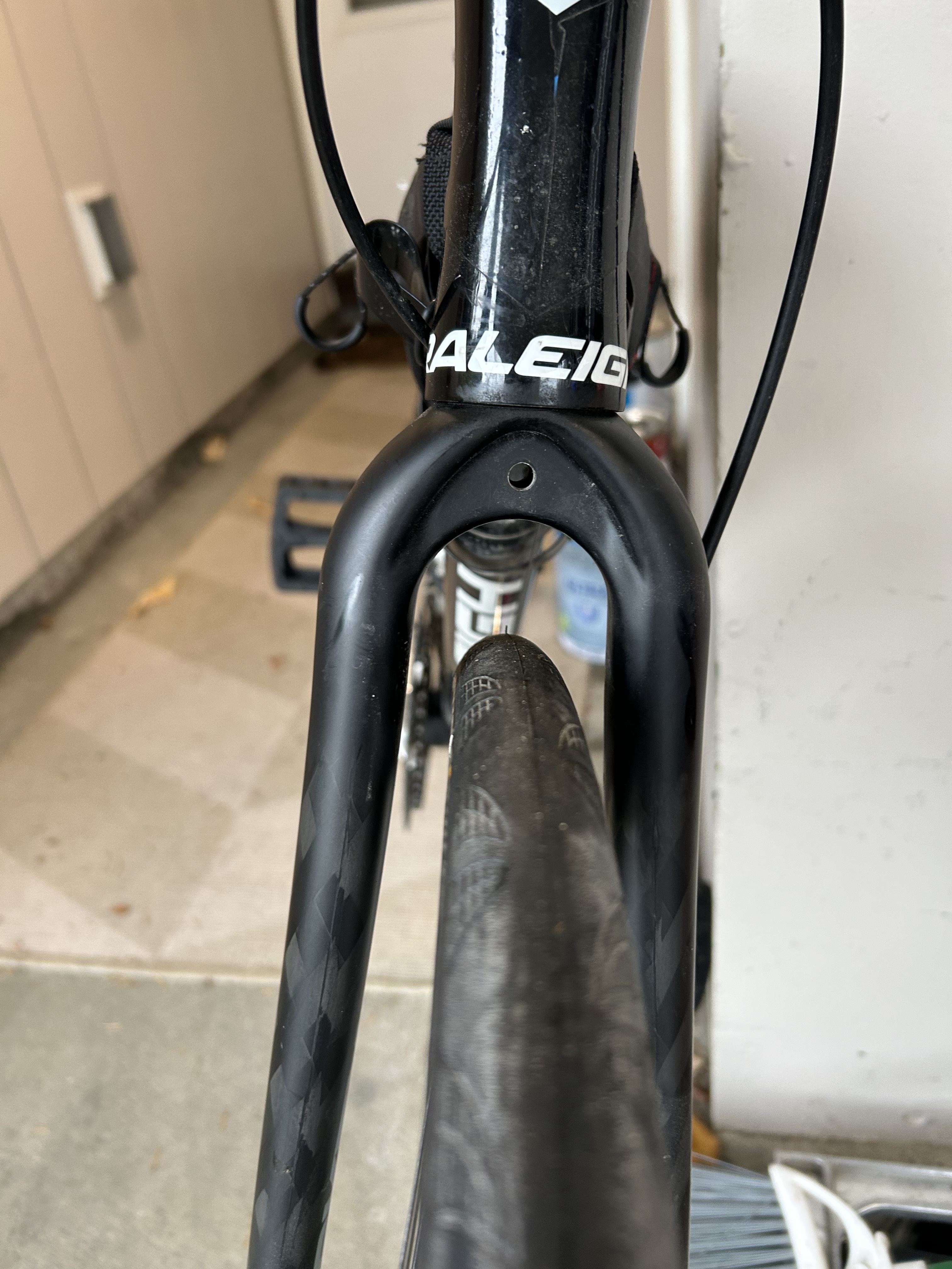

Least dithery fender for this fork? Tire is a 700x28.

SKS or PB would be fine but you know the real answer already:
Trying to keep it cheap since this bike will live in the bike room at a university.

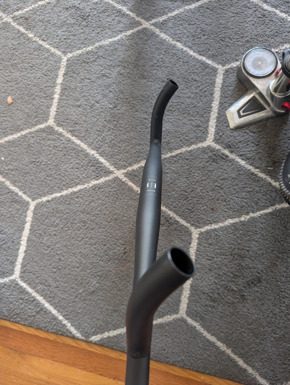

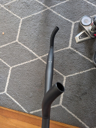

Did Velo Orange ever make the crazy bars with 0 rise and no branding? i think i got ripped off on a craigslist deal.
I gave up and used the PB ones I had in the shed and some random bits and bobs to space the stays out to not interfere with the brake.
Good choice.

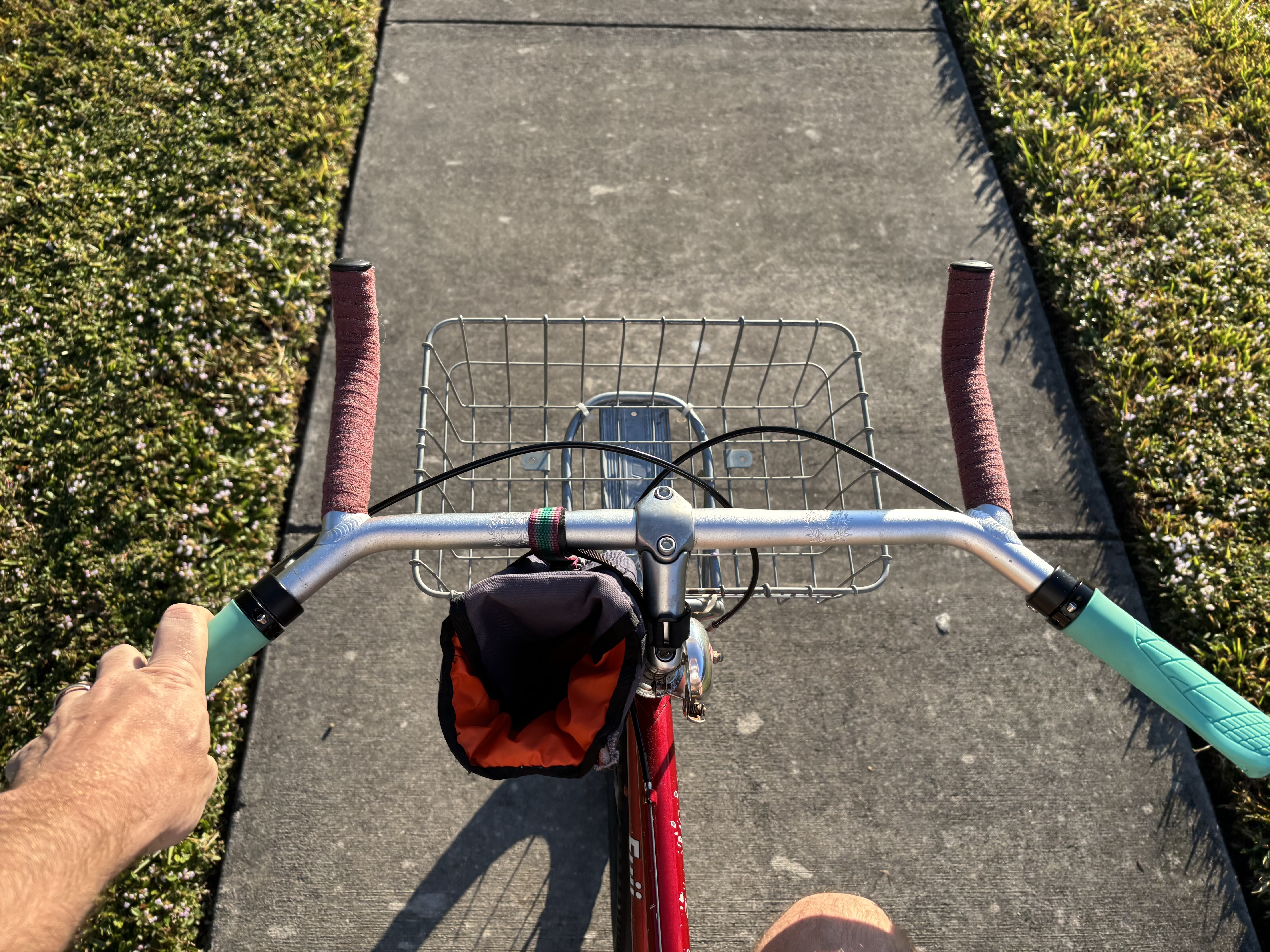

I have an early one (25.4 clamp) that looks like this:
ok, so i did get ripped off
more like lazy bars amirite
looks almost like this ali copy, but different: https://www.aliexpress.us/item/3256809749947940.html
(lol that most of the product pictures show it upside-down)

Could be Koga Denhams?
FS: Koga Denham handlebar | Mountain Bike Reviews Forum
yeah, that’s definitely them. so not a total ripoff, just misrepresented.

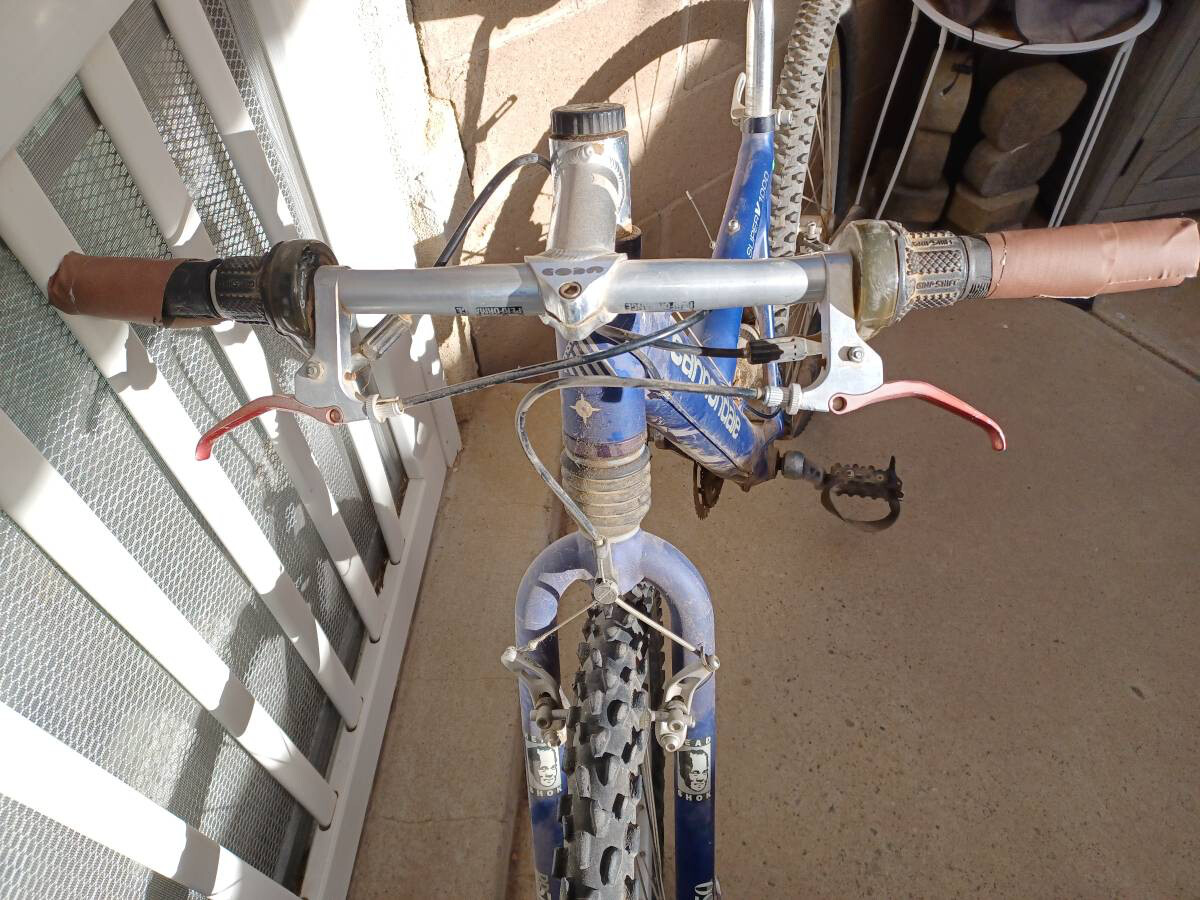

dq what levers are these?
look pretty similar to kooka rachas, real designs, love levers but can’t quite put my finger on it.
“Joe’s”
