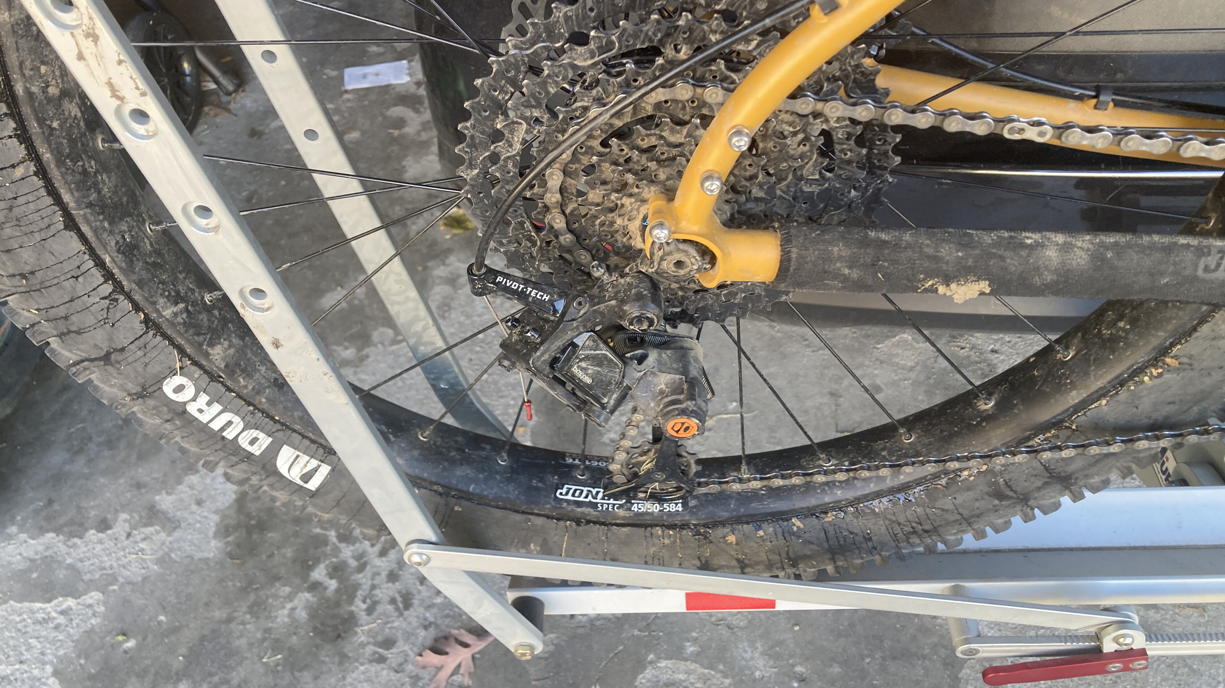

Tubeless DQ:
This bike is riding just fine and I’m happy with the tire pressures I’ve dialed in. I have not noticed any burps or undue air leakages, but why sealant splatter only on drive side? Tell me it’s the because my legs are super powerful and not just because I’m substantial and put too much Stan’s in there.
Tires move on hard brakes too
the signs of centripetal force rather than gravity says it happened on a ride. you got a little burp and it resealed. drive side is just random
