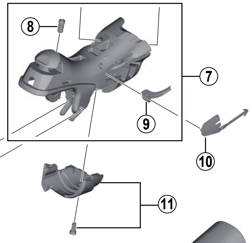

Bugger. Yeah, dental pick sounds like the best approach. Lots of jiggle.
Is the little lever getting hung up on the inside of the pulled forward hood? Sometimes that happens and you cant get the lever to click. Check that and pull tension on the cable while shifting down?
Yeah, I’ve fallen prey to this in the past.
Did you open the little door (part 11) on the bottom and look from that direction?
Oof. You win. I lose for doing bikes at 10pm
