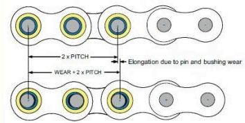

isn’t stretch actually wear? the plates aren’t getting longer, but the interfaces between links are all wearing and causing the overall chain to be longer
I don’t know what you mean.
the pins wear down and the chain gets longer
it’s not actually stretching causing longer length, it’s wear on the pins *and bushings
How does the pins wear down make the chain longer? I’m gonna fight you all.
https://bike.bikegremlin.com/733/change-chain-bicycle/
nothing is actually stretching. the chain becomes elongated due to mechanical wear
How much lube is even getting in there? Also that’s a bad drawing
So the pins wear down from the inside where you can’t see it
Sheldon told us all we need to know:
Cyclists often speak of chain ā€œstretchā€, as if the side plates of an old chain were pulled out of shape by the repeated stresses of pedaling. This is not actually how chains elongate. The major cause of chain ā€œstretchā€ is wearing away of the metal where the link pin rotates inside of the bushing (or the ā€œbushingā€ part of the inside plate) as the chain goes onto and off of the sprockets. If you take apart an old, worn-out chain, you can easily see the little notches worn into the sides of the link pins by the inside edges of the bushings, or the formed side plates of a bushingless chain.
