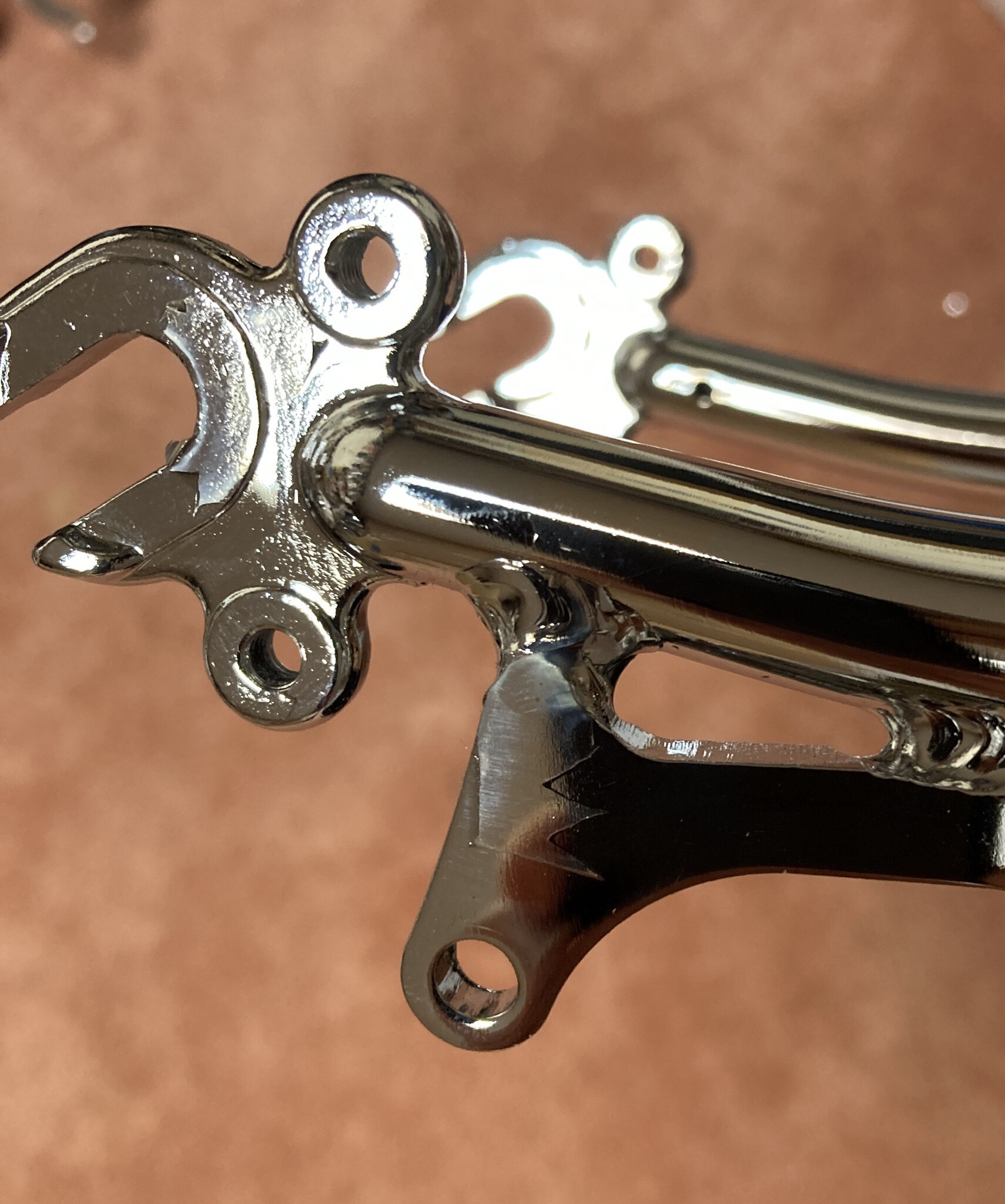

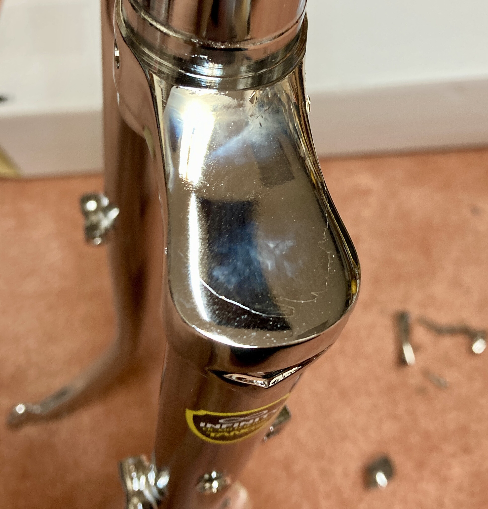

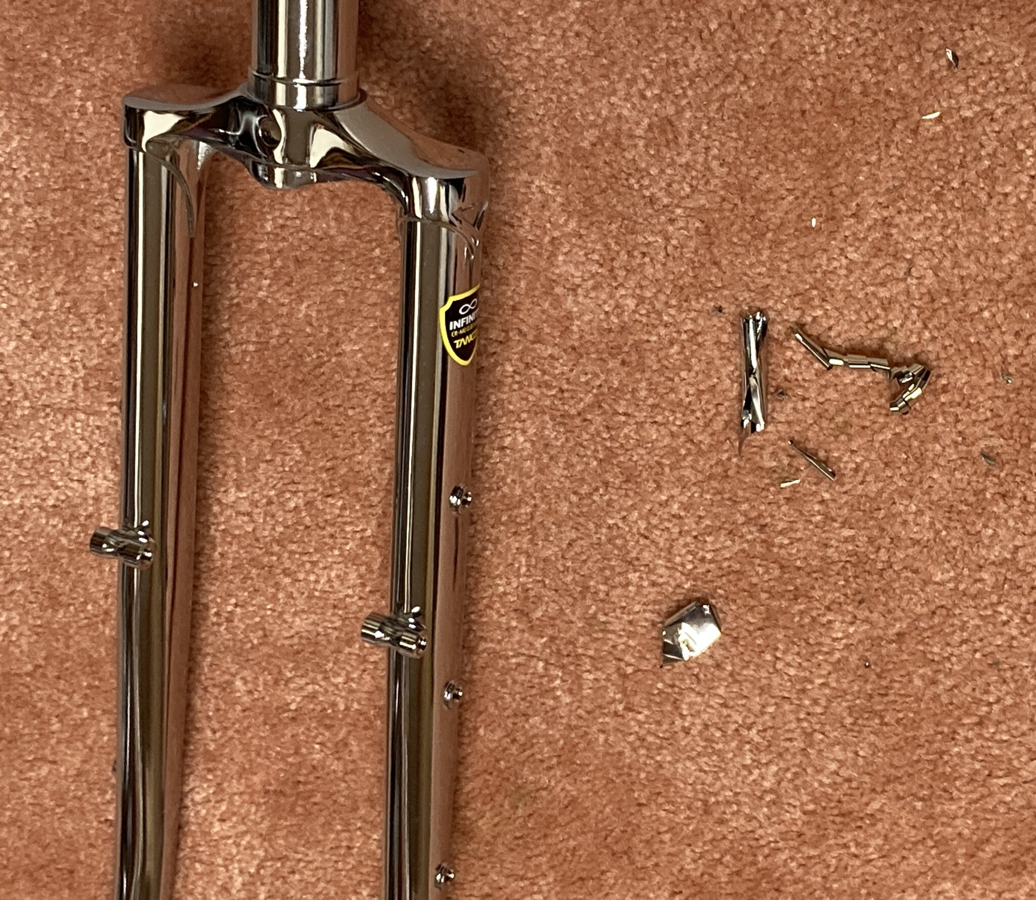

The chrome plating on my new discount Soma fork is peeling off in big pieces. Cosmetic issue or sign of a serious structural problem?
The next layer appears to be another chrome layer and is well polished but cloudy in places. It peeled from the dropout all the way up the leg to the crown in one piece but the leg section is practically invisible.
I don’t remember if soma was the one with disc forks crumpling or it was just karma for that guy but I would probably send these pics to soma QC and be like “hey I guess I understand why these were on sale is this going to cause me any undue harm earlier than expected?”

IMO. bad adhesion of the top layer to the lower plating would be a plating problem not an issue with the metallurgy or geometry of the underlying object. That lower, less shiny, layer is probably nickel and there’s probably a layer of copper under that.
