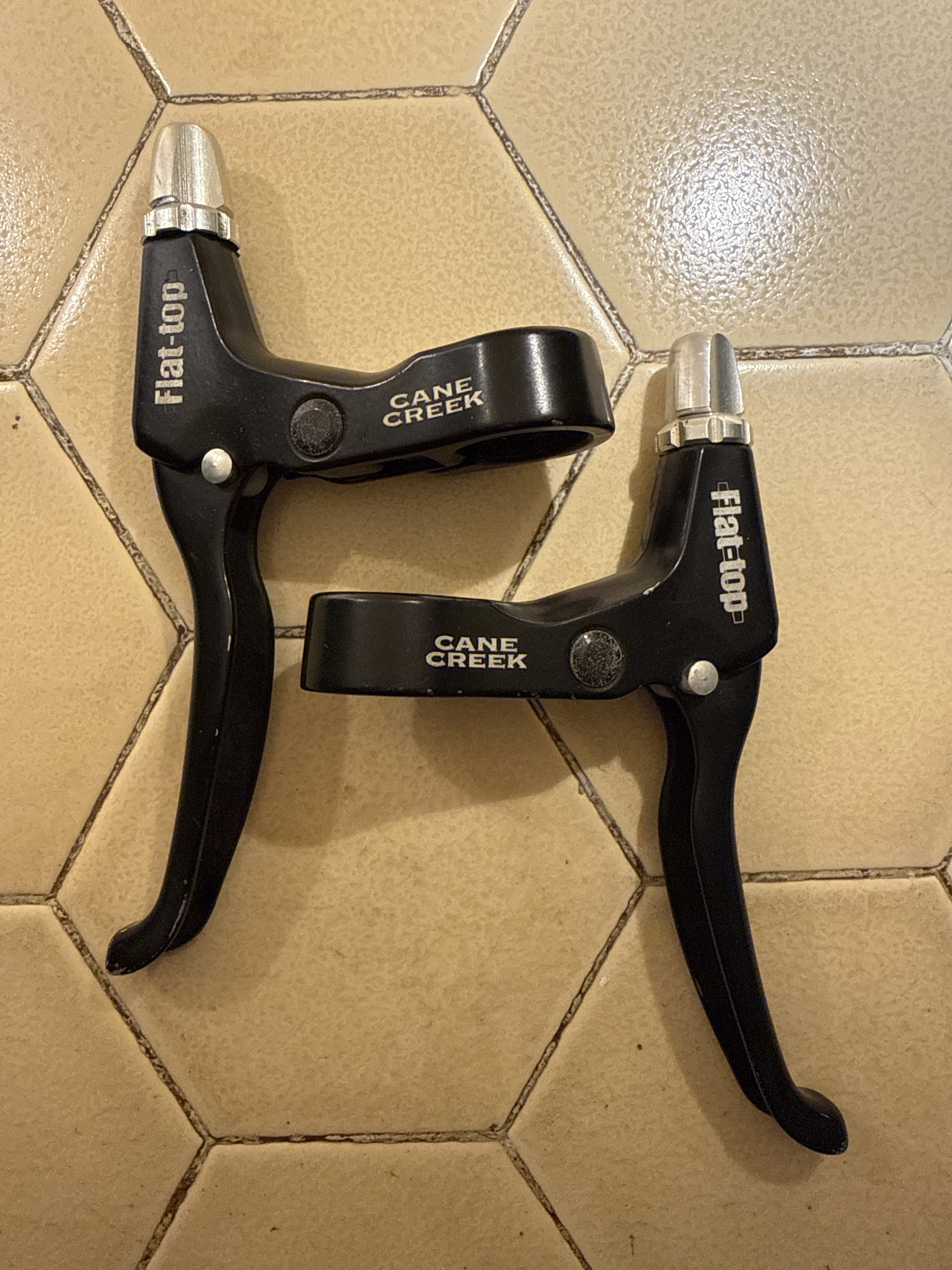

I have a set of these short-pulls if you’re not going hydro

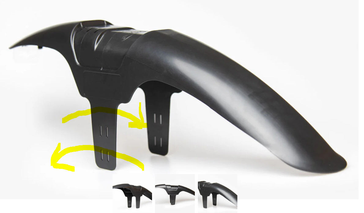

What fenders should I put on my unit? Full fenders like bluemels or more of an Andrew Major style situation? Assuming some moderate singletrack and perhaps an overgrown road or two?
Are there options for shorter fenders with stays? I have the mounts. Should I chop some bluemels? 2.6 tire width.
Do you want to be able to rip through blown-down sticks and small branches without thinking about it? Are there a lot of leaves in your area during fall/winter?

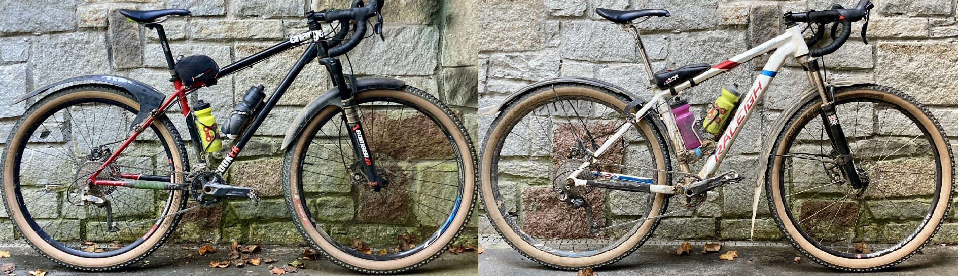

I have an MTB in each style and the Mudrocker/MudHugger bike is less of a hassle. Never any issues with sticks or leaves and almost no rub except the roughest surfaces. The fenders are great for wet and mud but not something I’d want to ride in full-on rainy weather mixed surface.
Regularly pick up sticks and leaves with the full fender jawn. Not enough to do anything other than rattle or catch in an out of the way place but more annoying and I always have to check up where there’s a lot of forest clutter. Much better for riding around in the rain.
IME full fenders with hard attachment rattle/rub more even with extra stays and wide clearance.

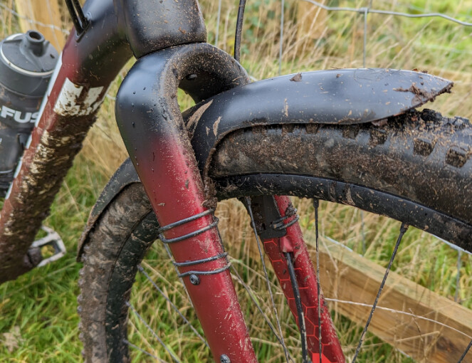

Im having trouble getting a sense of how well the mudrocker/hugger front would attach to a rigid monocrown fork- do you have thoughts?
With no attachment to the crown itself like how their gravel fender is fit?
I ran a version of this on my gravel bike and it was fine, did not seem much less rigid than when used with additional zipties to a fork arch. Putting something around the legs or between the fender extension and the leg to increase grip and tension helps eliminate possible rotation. I used silicone tape and never had an issue.
This would be the rotation issue with no arch support up top. Zipties can get tight enough to keep it in place.
