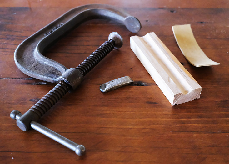

A block of wood shaped to fit the outside of your stay to prevent any clamping from crushing the wrong side, a 10mm socket placed where you want more room on the inside, and a standard bar clamp will do the trick. I did it many years ago on a trashed frame to see for myself how it worked and it was pretty easy, but also pretty easy to too far once you’ve started the crimp. A little goes a long way,
My crimper. Keeps things centered and aligned. Squeeze it with a big c-clamp

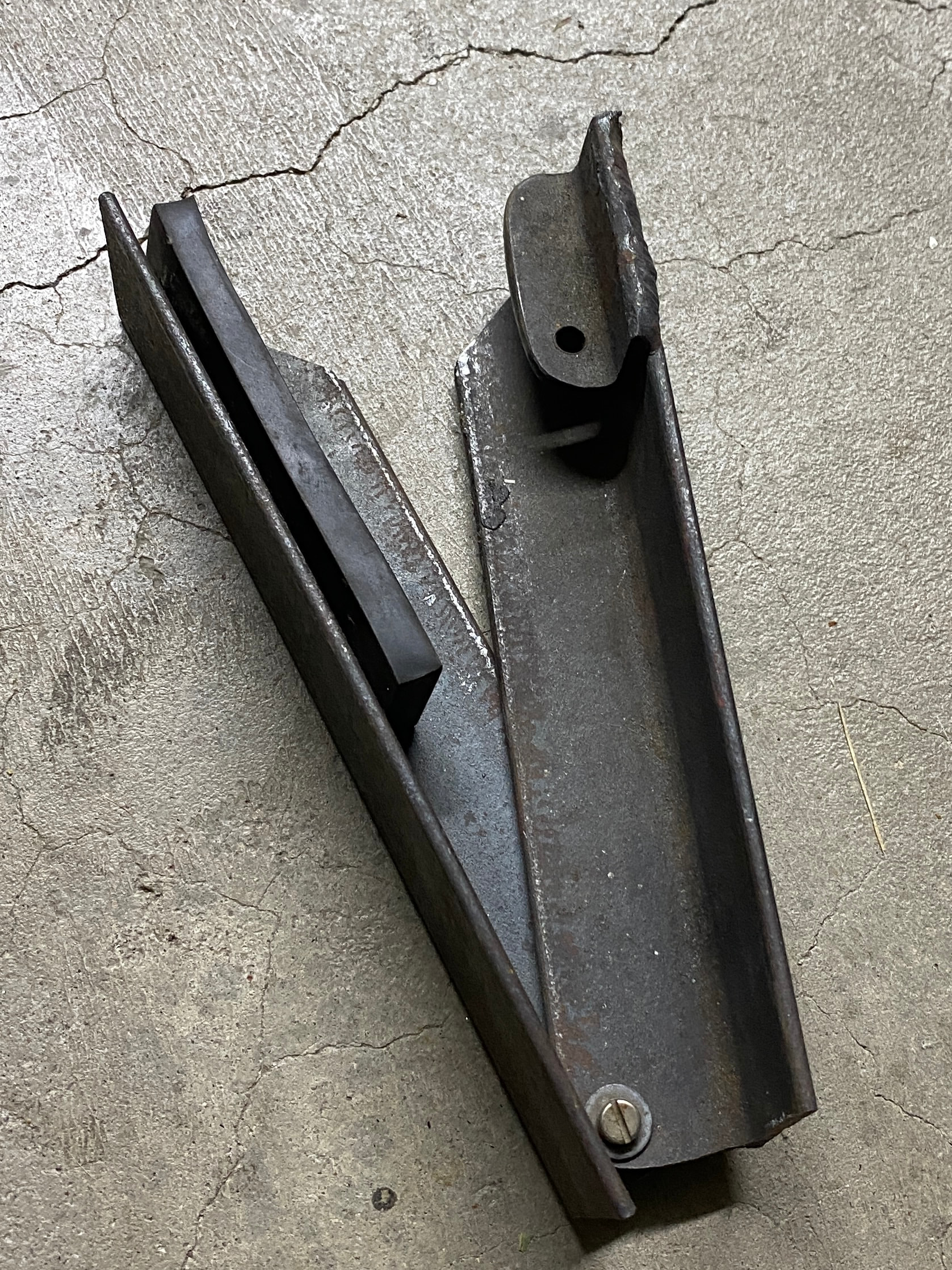

I don’t have a good pic of mine but it’s just a form welded to a c-clamp. I’ve used it on heat-treated JPN Tange Prestige and boy was it a workout to get 4mm/side but it came out nice without hardly even any paint damage.
Compared to 1990s Tru Temper ??? which was like butter in comparison and felt like I could have just used my fingers with IMRON paint flakes shooting everywhere.
I’ve thought about offering to send it around but it’s like $15 each way shipping and I think most people could have one made up for about that much.
I cut off part of this and then welded it to a C-Clamp:
Even if you had to buy everything including a hacksaw and pay to get it welded, it would cost like $50 at most.

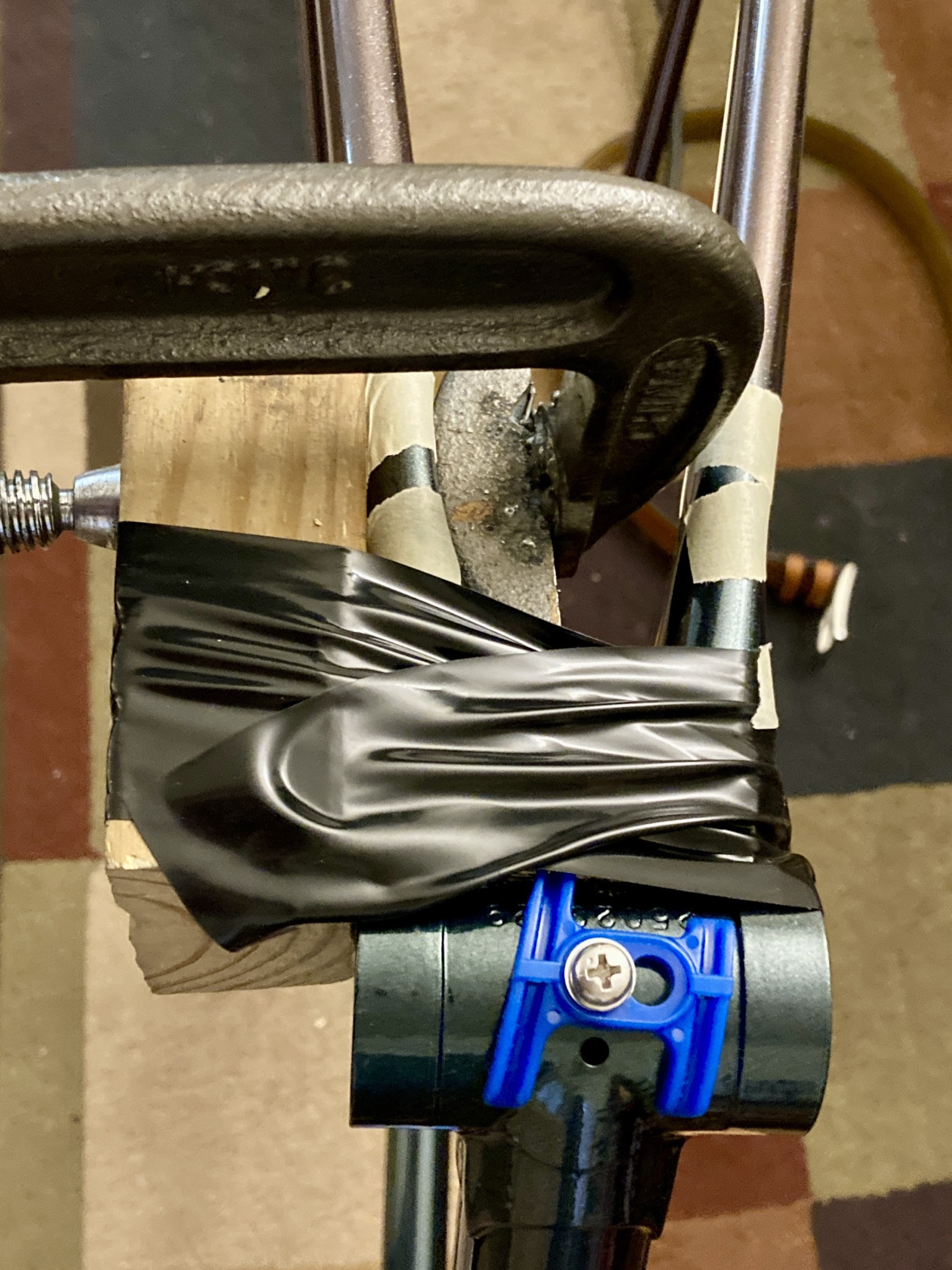

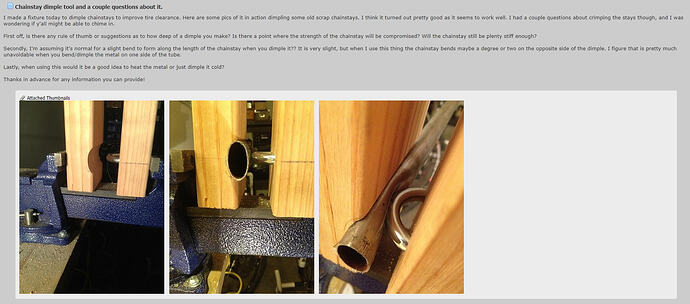

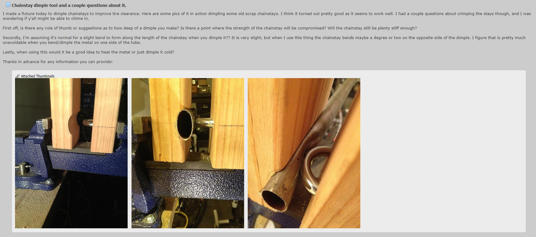

The biggest process thing to pay attention to is the keeping everything straight and level, the first few practice times I did this the clamp wanted to rotate both axially and vertically even with someone holding it in place. Go slow and check fit as you go, be prepared to open back up the dropouts and check both dropout and chainstay alignment. Mark Bulgier has a ton of posts about this on IBOB but they’re not particularly helpful if you’re more YOLO and less compulsive research until the last minute like I am.
Some inspo if you need it:
This isn’t mine but I tried it and it’s so fiddly to get everything aligned and through the process I gave up. IMO the form really needes to be welded to the clamp but others have had good luck without I guess.

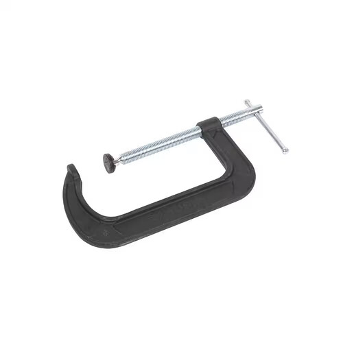

What kind of clamping force is needed to crimp? I don’t know the tubing, probably nothing exotic, the frame is unknown and not high end, very average lugged steel. I have a trigger clamp that is ‘300 lb’ of force. Feels like it would be easier to control than a c clamp.

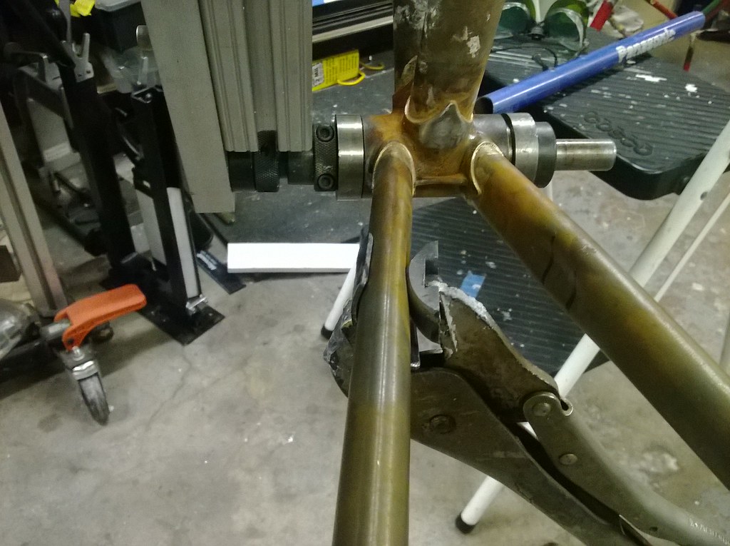

Seconding c-clamp over trigger clamp. Depending on how tight it is between the stays, I have also seen people use large vice-grips with welded-on outer cradle and inner form.
With c clamp it’s easy to dial it in very slowly
