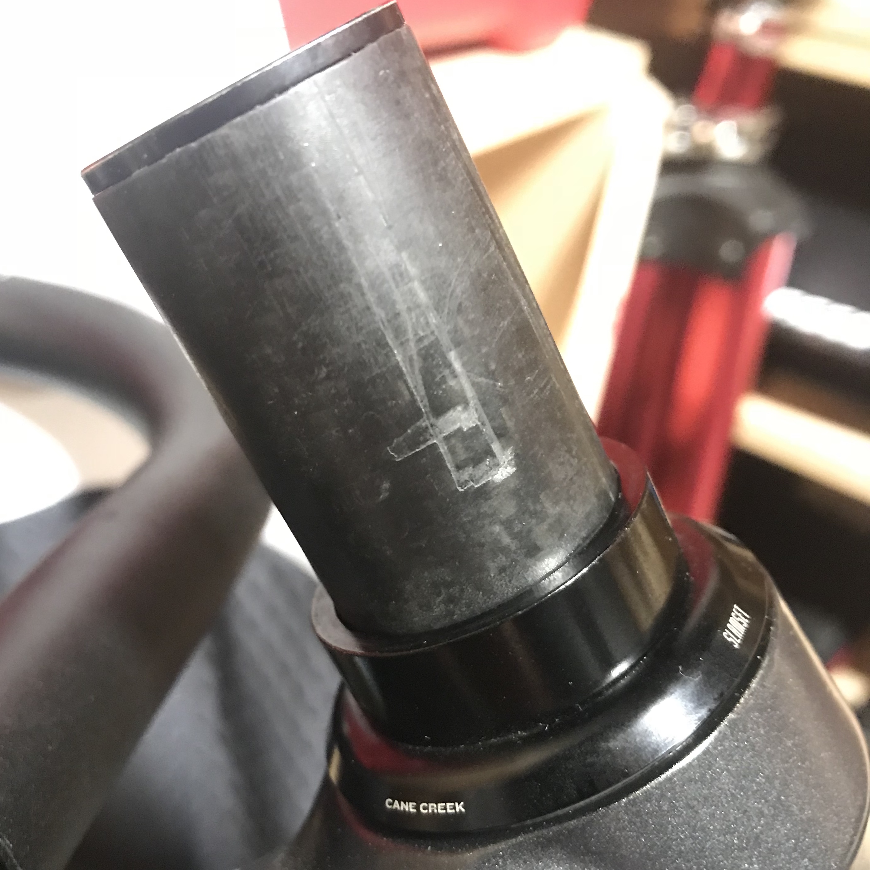

I guess one of my stem swaps gouged my steerer. Whoops. I have no recollection of it happening. Should I bin it? It’s centerish of the stem currently.
I cannot imagine that failing if it’s under the stem clamp. There’s no appreciable load there. If it was under a spacer I might be worried.
