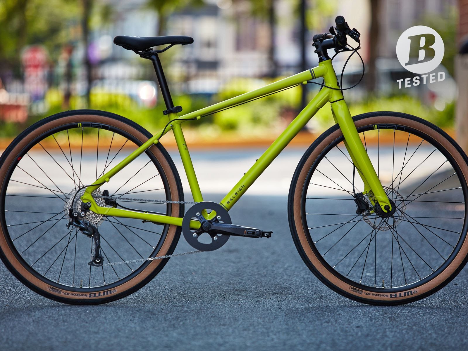

Best front rack for this?
It has front caliper brake hole and fender eyelets. Non thru axel.
Trick question?
A rear rack!
That’s where babby goes.
HT Skip rack and further BasketChat dithering and just get Wald basket with struts
