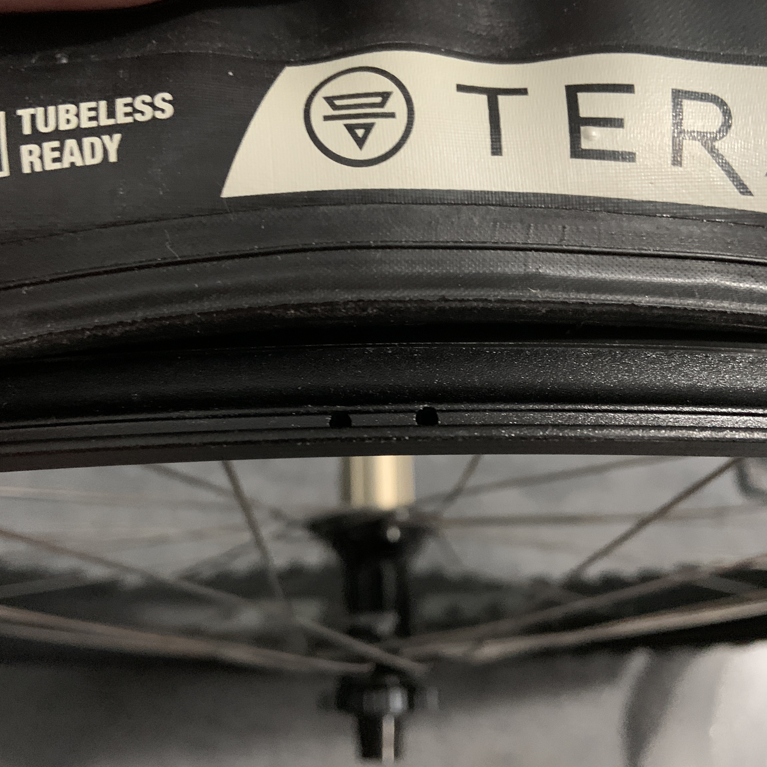

New wheels came with tubeless tape installed over the WTB nylon strips. Tape is approx 25mm wide, leaving the holes in the bead shelf exposed. Should I remove the existing tape before installing 48mm tape to cover the holes (rims are i45).
leave the strip in an use the correct tape.
Thanks. Seemed odd that they would use such narrow tape and leave the holes exposed.
