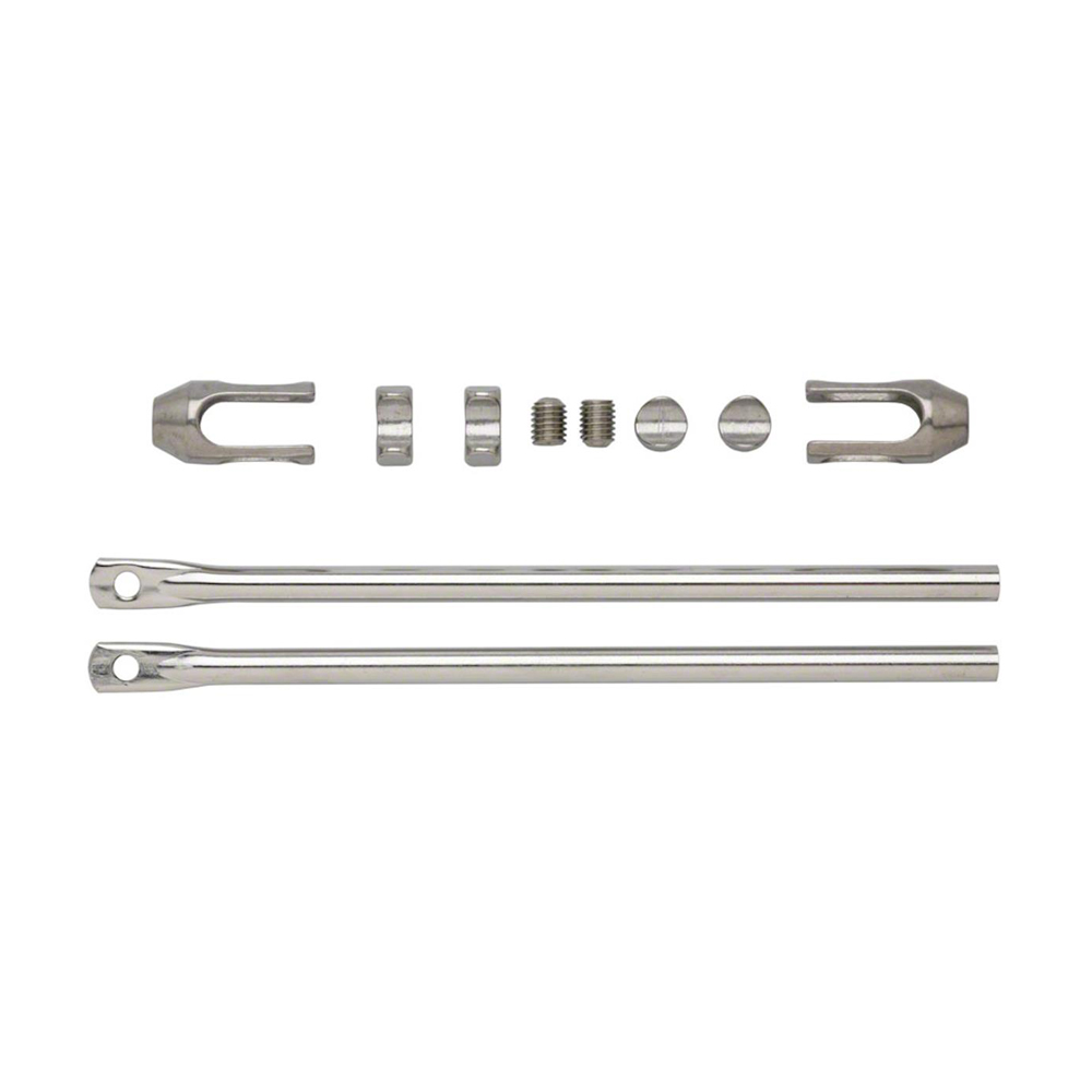

Are the Blackburn Local Deluxe racks worth messing with? I’m trying to find a rear rack for the Lorry and hoping to find something that doesn’t sit super high (because of high lower mounts) and can deal with really low seat stay mounts. It being a bolt together rack doesn’t excite me, but it’s only $50 and has mounting flexibility that other cheap racks lack. Bonus is that it’s really heavy at 2.3 lbs, which would push the bike even that much closer to weighing 80 lbs.
https://www.blackburndesign.com/p/local-deluxe-front-rear-flat-bike-rack/
Alternately, I could spent 2x as much on a Tubus and hope that the stay angles would work, or that it’s robust enough to handle using the Surly upper rear hardware from the parts bin.

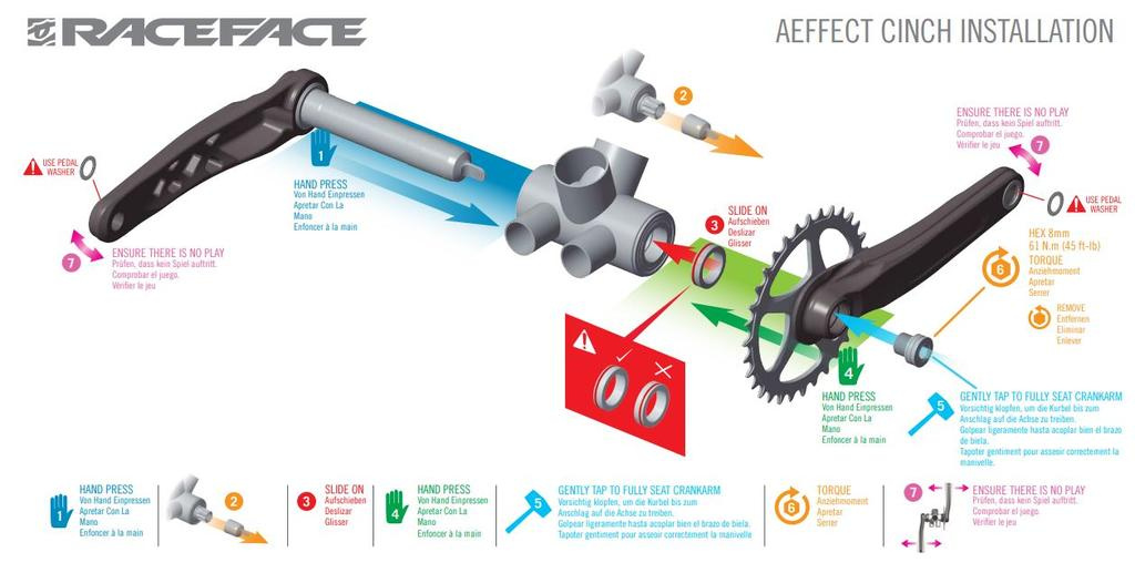

Are these bottom brackets fairly interchangeable? Like can I get a 30mm spindle BB from some other company?
I don’t think so? I’ve only ever run Race Face bottom brackets with Race Face cranks.
I kinda hate my 2016-ish RaceFace cranks. Turbines? BB has always had play, center mounting bolt is pointlessly oversized.
I should Shimano that business
The sense I get is that everyone hates RF cranks. They were fine until this last time I crashed and now something ticks! At least I just realized they’re 24mm not 30mm. Almost as simple as can be, I guess.
After I clear our refinancing, I’m going to ditch the Dub BB in the Instinct and put XT cranks on it.
Then I can Stages all the things!
I love my 2016 turbines. Had zero issues with them, pretty sure they’d last for ever if I keep fresh grease in the bb.
You can run Aeffect 24mm cranks with a Shimano bottom bracket, just don’t botch the install because its easy to knock the drive side Shimano top-hat seal loose when tapping in the Race Face crank.
As a rule when swapping any direct mount ring I wick a little green loctite into the splines before installing the lockring with grease on the threads.
Also, washers can also ward off oxidation where the pedal would otherwise contact the arm. I’ve seen PLENTY of cranks with various levels of corrosion here and the nicer washers seem to prevent that.
