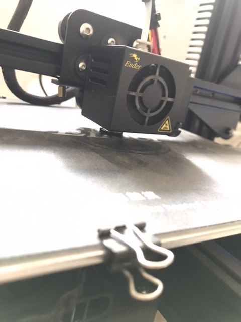

Also: goddam additive manufacturing stealing our jerbs
3d printer go brrrrrrrrrrrrrr
