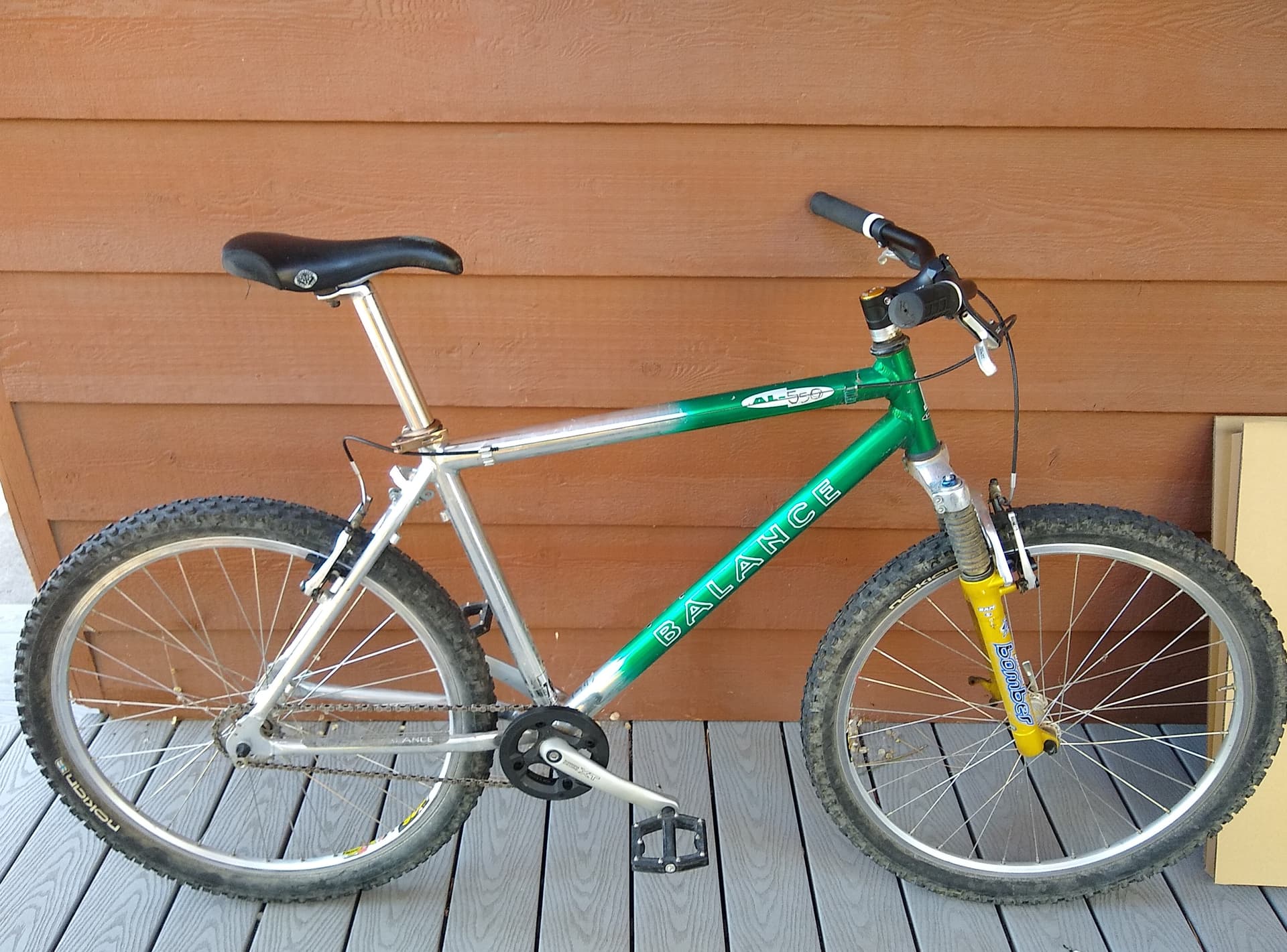

I still have that Balance AL550 frame I’ll send you, just say the word! 1-1/8" steerer.
That Alpinestars uses a 1-1/4" diameter steerer. The steel frames (Cro-Mega) seem to hold up much better than the aluminum. That said, anecdotally the AL-Megas generally hold up better than aluminum e-stay frames from other manufacturers. Stem, front derailleur, fender mounting can be challenges. Taking this chance to post my old Cro-Mega to inspire myself to pull the frame out of storage and get it built back up.

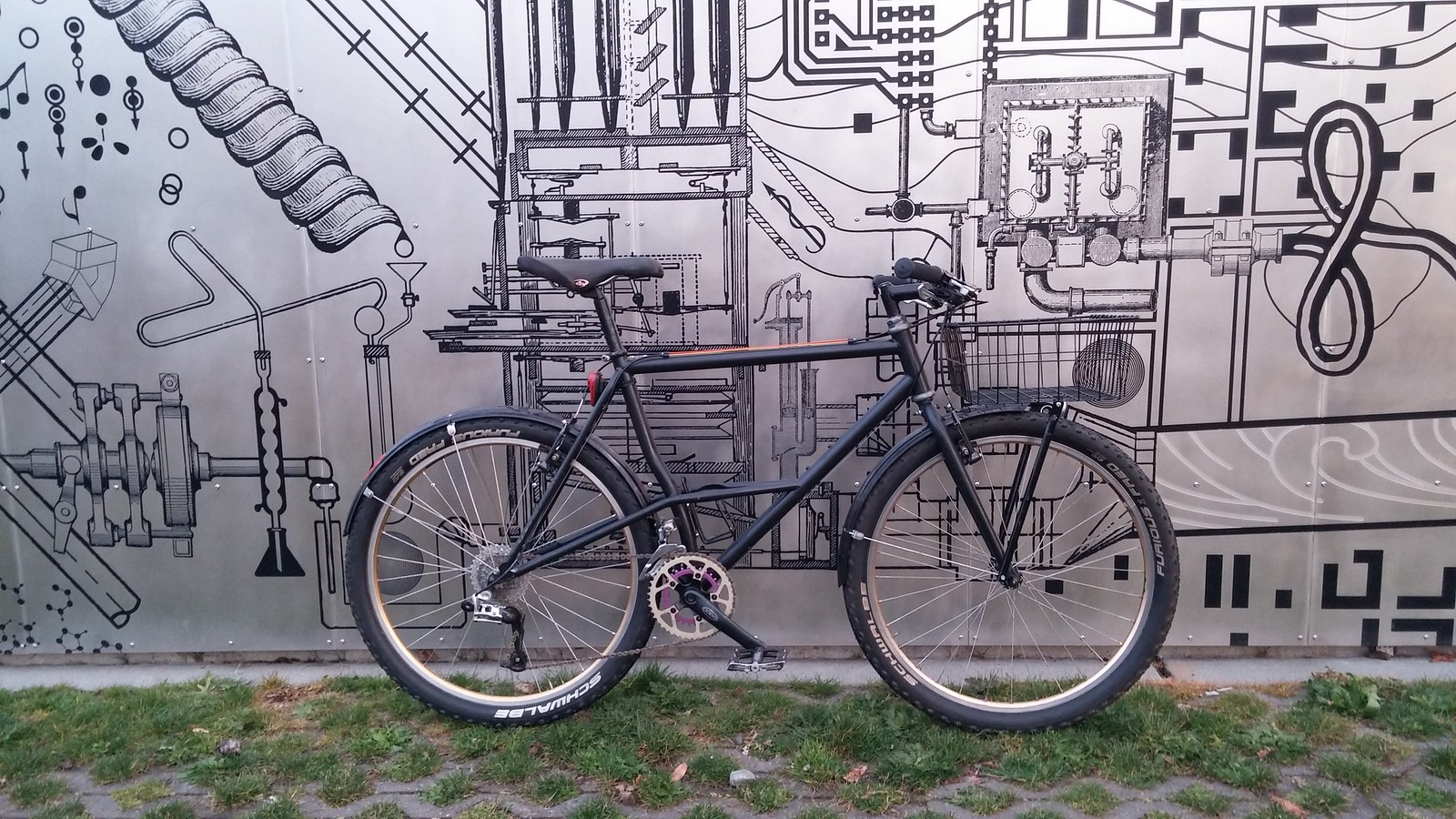

which one of y’all had that bike with weirdly v-brake-ish set up cantilever brakes? with a pulley and cable hanger? I absolutely cannot find this thing. @drwelby perhaps?
