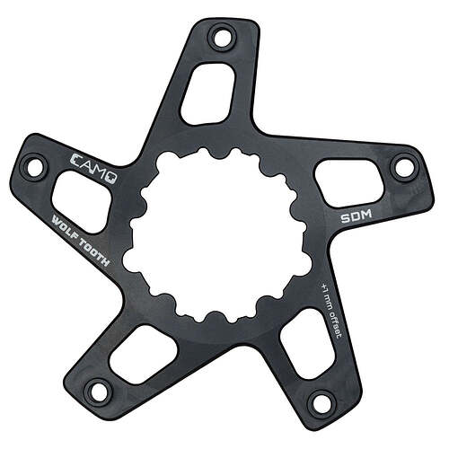

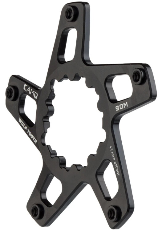

I’m wondering if one of the Wolf Tooth CAMO 110bcd spiders could work for you, perhaps the “boost” one?
I forget exactly how the bikinggreen chainrings work, but I assume you would need to drill out the threads on the CAMO spider, and possibly file off the bosses to get them to fit.
looks like you could flip it to push the rings out

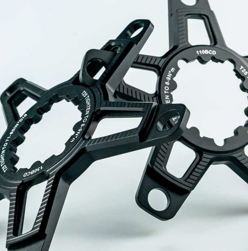

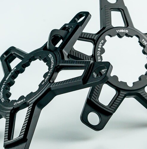

I’m just eyeballing how the aliexpress spider the chainring tabs are offset inboard from the splined spider mounting face.
Vs. the Wolftooth spider where the mounting face(ignoring the threaded bosses) is level with the splined mounting face.
rival cronques.
bikingreen inner ring has a stub that has an offset threaded hole that receives the screw from the outer and also sticks into the chainring bolt hole
