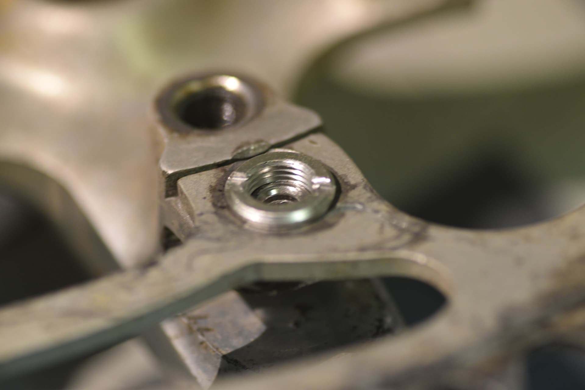

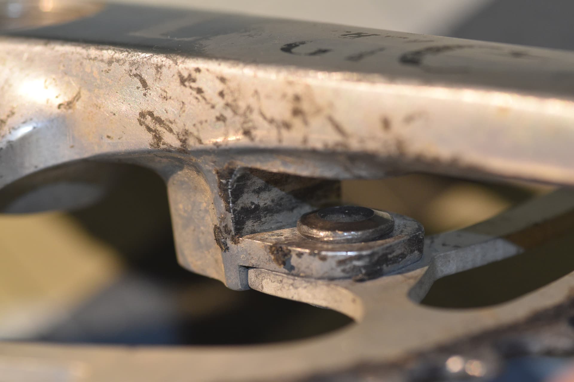

Winter dither season is in full swing, Ritchey logic triple has been nerdcrank’d as 46-30 double into a respectably low-Q situation. However, the gap between the face of the chainring bolt is uncomfortably narrow - previous attempts to torque with finger or sculpted eraser have produced an insufficiently torqued bolt (A) . What is best practice to get some purchase on such a bolt?
Should the smooth-faced externally threaded (m) “bolt” still face out or should internally-threaded (f) “nut”, unlike the other four bolts on the crank (B)
Hidden bolts get flipped, you can spin the chainring with just the hidden nut in place.
Thanks, I’m still unclear on how to turn the bolt if its flipped with slotted side towards the arm
There’s a tool for that
