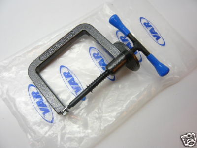

I remember coming very close to picking up one of those fancy VAR tools before just c-clamping the Sugino version of the little wrench to the back of a particularly stuck bolt.
