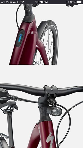

Can you put a standard fork into a headtube designed for their “future shock” thing?
definitely also still pending verification.
from what I can tell the Vado SL doesn’t have the sproingy steerer? the 5.0 SL has a “carbon rigid fork,” it could even be tapered? who knows.
P sure it’s gonna have future shock.
i honestly did not expect an answer in the manual.
not the best photo comparison cuz mobile but one of these has futuresproing, the other doesn’t. you can tell by the boot and the 2 piece dust cap.
i haven’t touched anything futuresproing but that pic leads me to believe that you can put a reg fork in but you’d need to track down a correct dust cap
ymmv

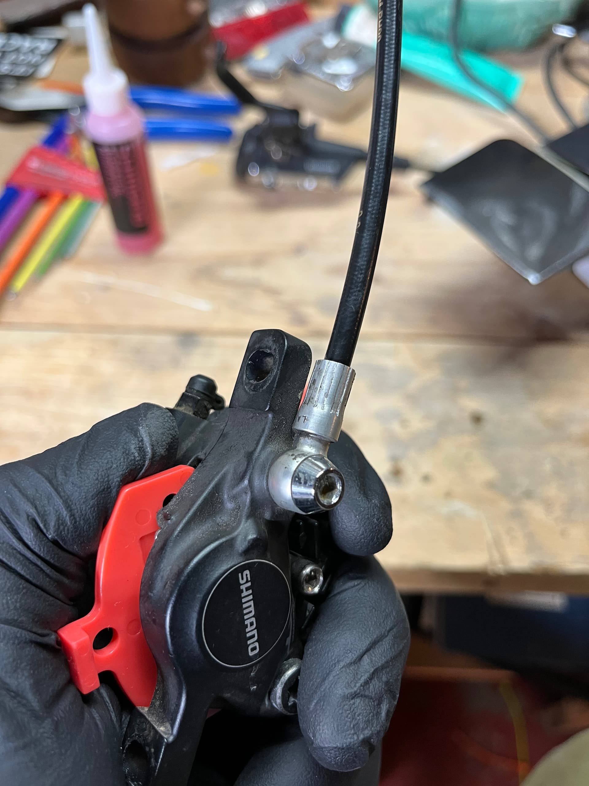

Hello, I’m trying to replace a (perfectly good) hydraulic hose with a new (colorful) one. Internet is telling me that I can reuse the banjo, but my new hose has a quick attach at the end and the banjo doesn’t look like I can detach it from the hose without destroying it.
This is the quick attach end on the hose:
Anyone got a link to which banjo to buy to connect to the jagwire hose?
