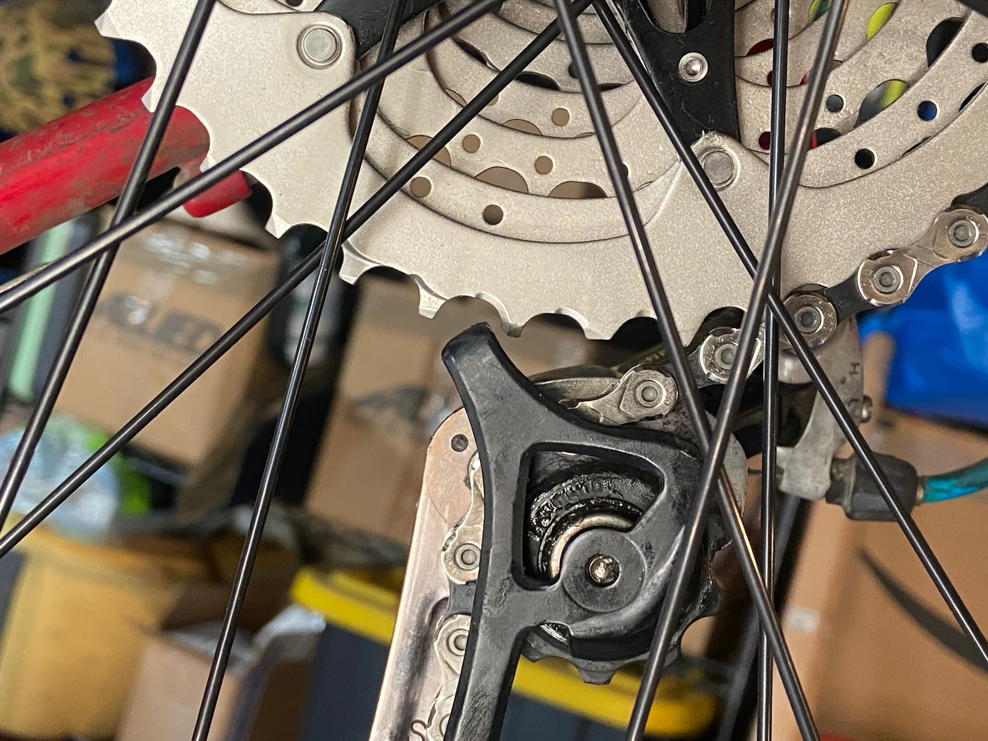

I’m trying to 11-42 with a tail hook lengthener on my Bridgestone. Even with a longer b screw the cage on my dangler is hitting the big cog — am I doing this wrong?
Tempted to just dremel off part of the cage
longer chain?
I measured it the typical way — two links longer than the wrap around ring and big cog
Otherwise it shifts through everything just fine!
Looks like whoever last poked at that rear derailleur put the inner cage on upside-down. That tab on the black part should be at the bottom of the dangler cage, not the top.
