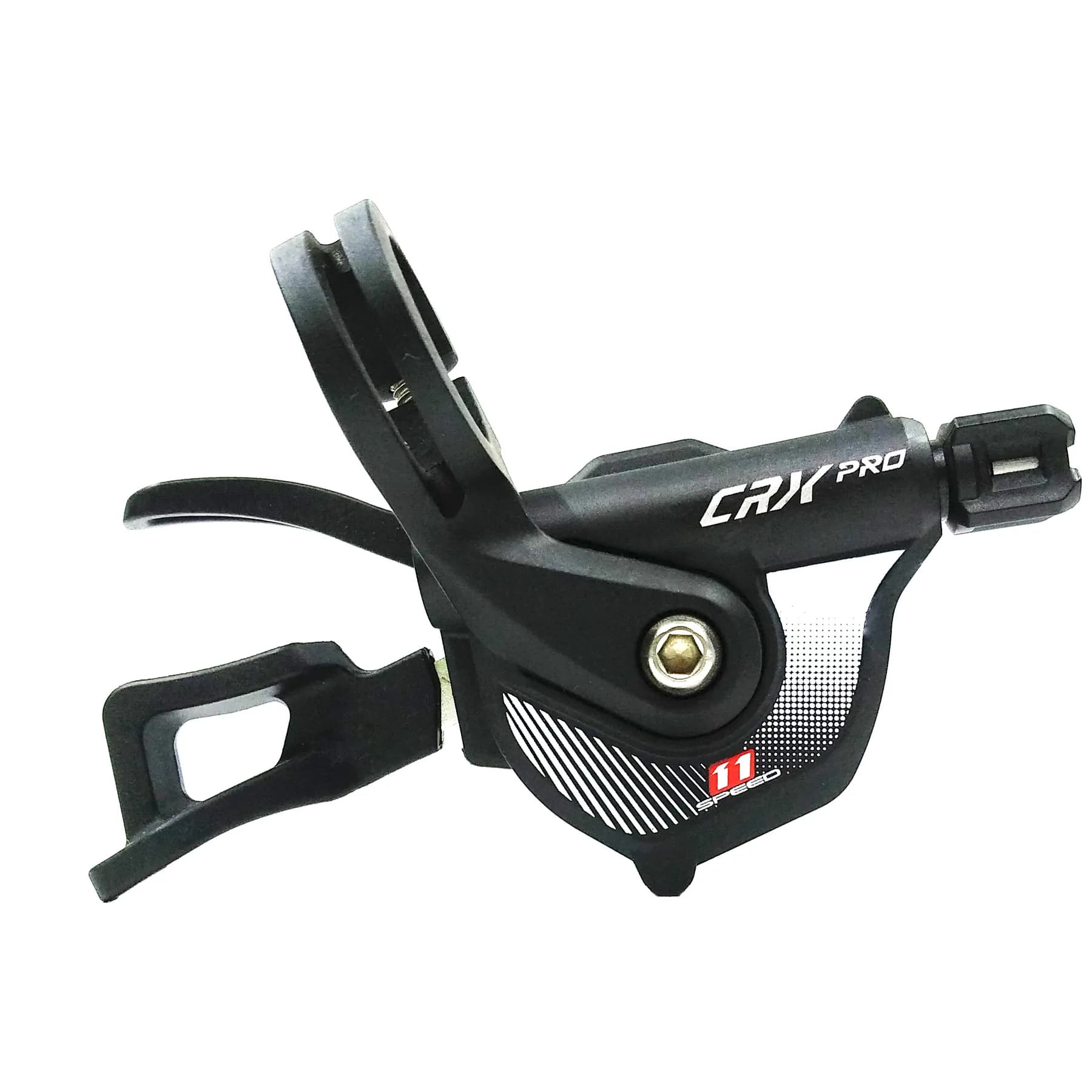

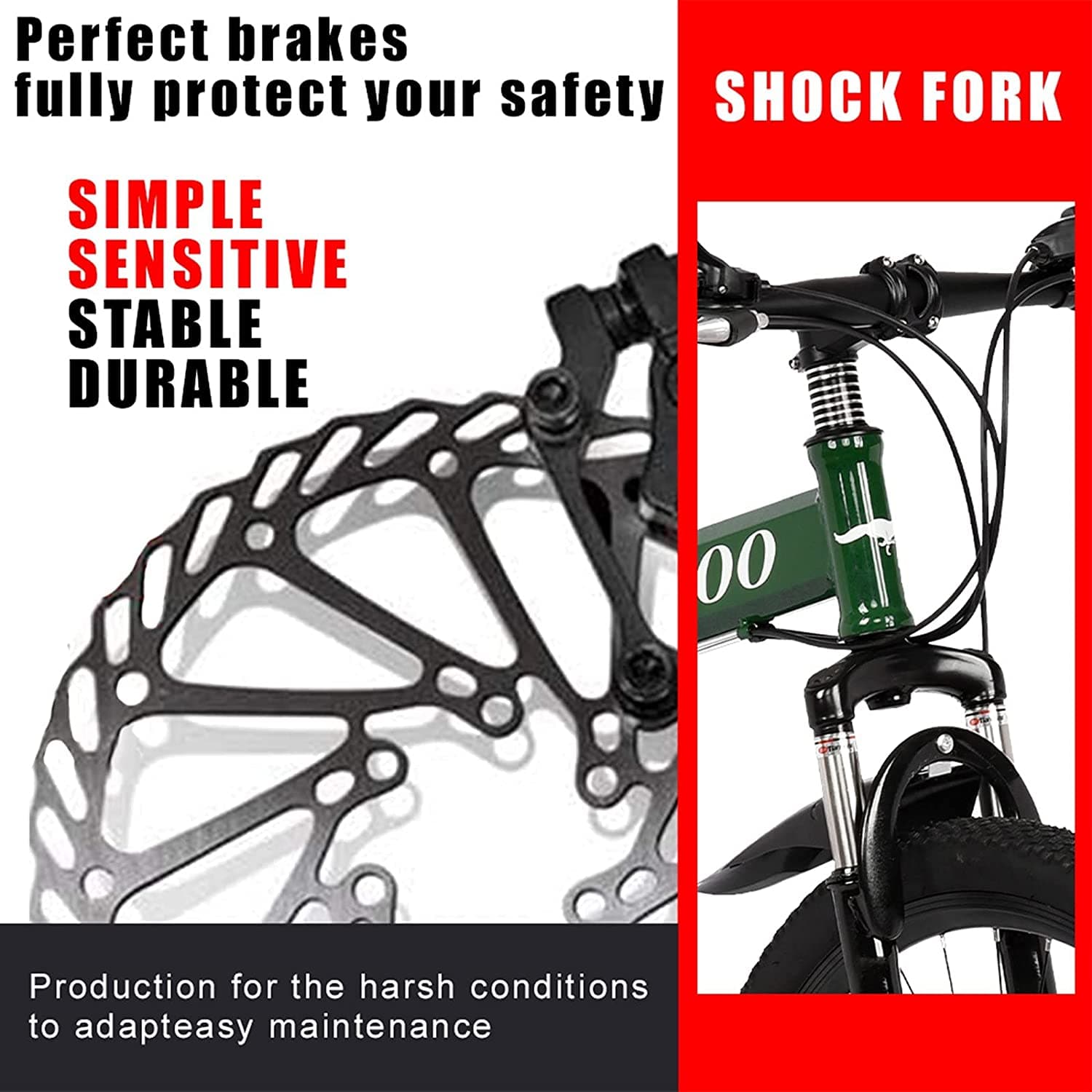

I worked on the worst bike today. Dude brought it to my workplace lunchtime pop-up. It was a sub $200 full suspension MTB that folds mid-frame. All of the drivetrain is counterfeit SHIMENG. The fork was on backwards, which is bad enough. But that made the THREAD-ON ROTOR self-loosening rather than self-tightening. No lock ring. My gob remains absolutely smacked.
thread on rotor??? this is why you always spring for the genuine shimeng
Yup, made to look like 6-bolt. But the bolts don’t do anything! Seems harder than just using acceptable parts.
Oh! AND the fork’s stanchions were covered in, like, tinfoil? The real stanchions are black, but over top is a silvery layer that doesn’t seem to be attached to anything. Maybe some kind of dynamic shims to deal with the horrendous bushing slop in the forks guts.
