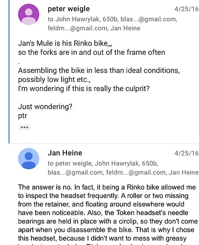

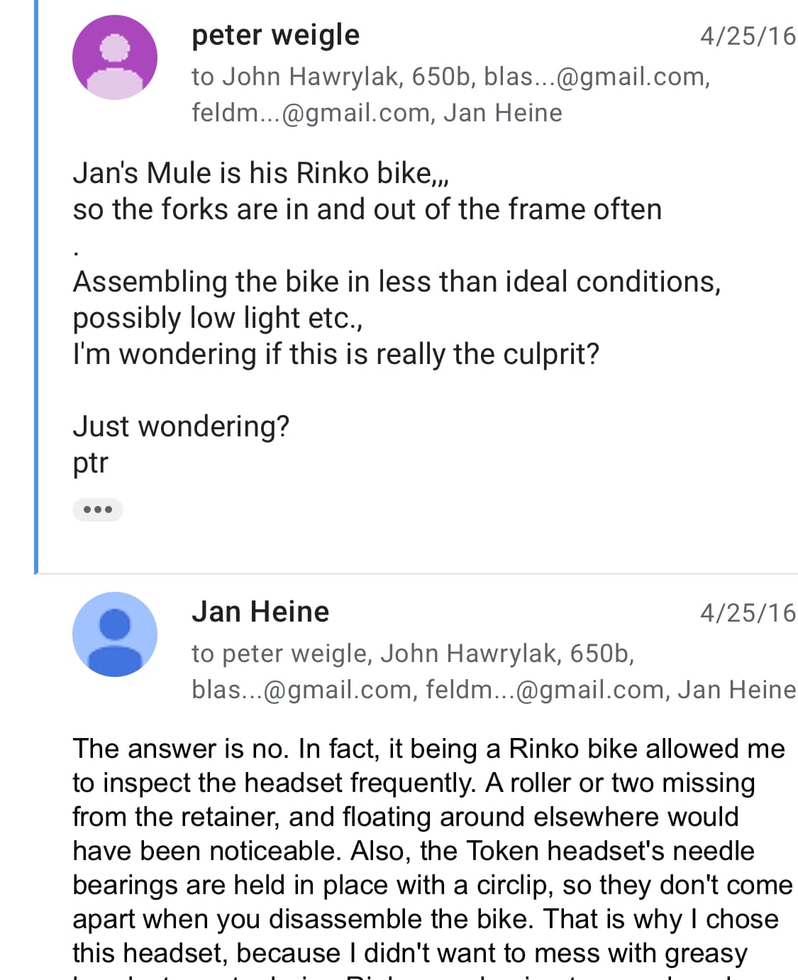

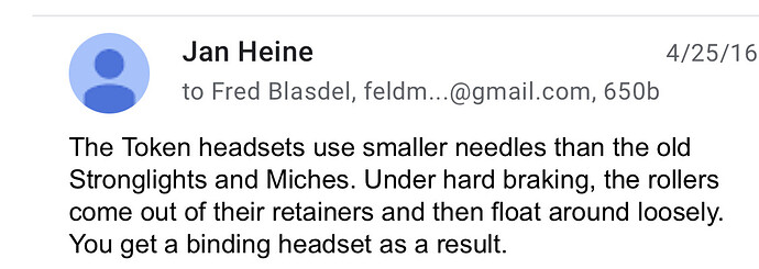

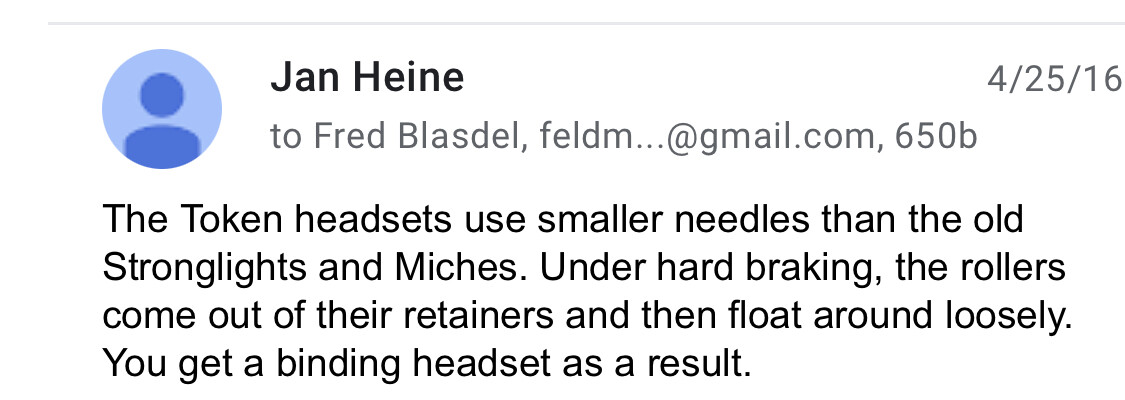

But before I do I might as well ask if anyone has tried this before? I googled around if any of this is interchangeable and all I found was an old google forums thread where Jan Heine was shitting on Tokens.

I never had any issues with my token. And I am a fat guy. Maybe I don’t brake as good and hard as Jan
I honestly can’t fathom how his problem is possible on a properly adjusted headset
Reference:
Yeah lol Jan in 2016 had not even considered disc brakes. Seems fine on my disc brake / token bike

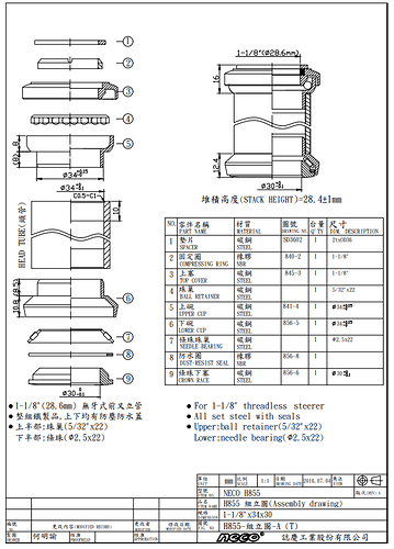

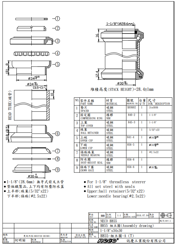

I hate the unnecessary cost and complexity of getting a needle bearing headset. The real irritating thing is that Neco pumps out tens of thousands of low-cost 1" and 9/8" models exclusively for Chinese bike shares and Japanese mamachari bikes. Limited quantity occasionally show on eBay and Aliexpress but never under the right model name. They clear out for $10-$15 and last forever.

Preload is a little sensitive but it seems to work fine. I’ve been using one since 2018 on my gravel rando. Only had it apart once to check and re-grease and didn’t notice anything out of the ordinary. Rollers are staying in place under spirited braking at least.
Surely you’re not braking as hard as Mr. Heine though.

the number of needles in the bearing is irrelevant
the only thing that really matters is the angle of the bearing seat (all I’ve seen are 45°) and whether the bearing races physically fit in the cup (which might not work if they’re too thin or if the cones are mismatched)
your replacement bearings should fit just fine, but you shouldn’t need them at all as the “for parts” headset is complete and this shit just doesn’t wear at all
I’ve never seen any bicycle roller bearings that were tapered
the needles are always regular cylinders, just set at an angle in most headsets (but some like the Dia-Tech or Woodman use them flat as thrust bearings in the lower cup)
Yes this results in dragging the rollers like a locked differential — and that’s exactly why shimmy fiends like them, because that supplies damping to the steering
But they were originally invented for durability to combat what’s now known as “False Brinelling” where your headset indexes itself. At the time the needle bearings were ostensibly for the bigger surface area, but actually worked by allowing the outer races to be an independent moving part from the fixed cup — implicitly adding a plain bearing to each end of the headset to displace under vibration.
Cartridge bearings of any kind get you this same property incidentally and eliminated needles from the market.
