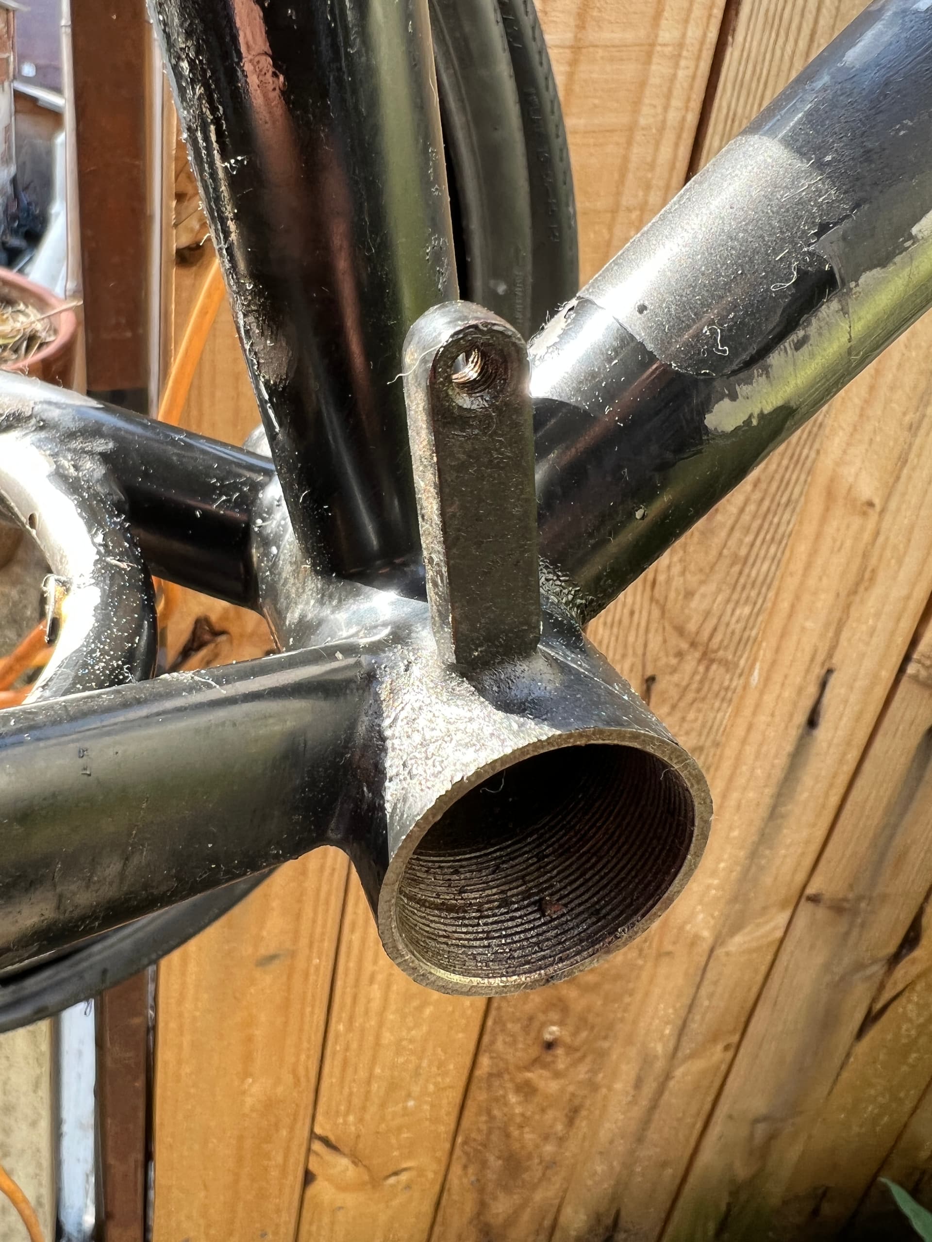

Anyone have any idea what this tab is on my moonlander bottom bracket?
Chain catcher mount?
Edit: their current moonlander data sheet doesn’t mention it. What model year do you have?
It was the first year. I can’t find any evidence of it online. I thought the same thing but only one bolt? It would have to be proprietary
Might eBay a stingray chain guard and mod the bracket.
Chain guard
Forgot I already have one
Front derailleur tab for E-type models.
Thank you. Didn’t know what Those where a thing
Yeah, it’s a pusher mount. My OG Pugsley had one.
