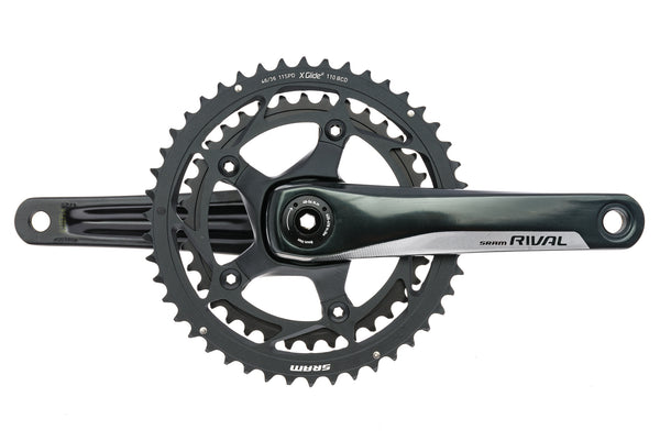

Yeah, rival and force bb30 (excluding 10 speed force) are both essentially 386 cranks. They should work with a bb386 bottom bracket and the right spacer configuration.

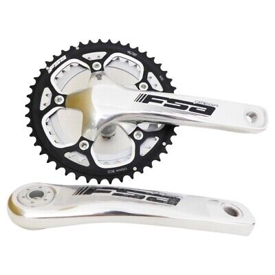

Like ross said, rival would work. Don’t fuck with the fsa bb30 though, all short spindles, which is why they shifted into almost exclusively 386 cranks.

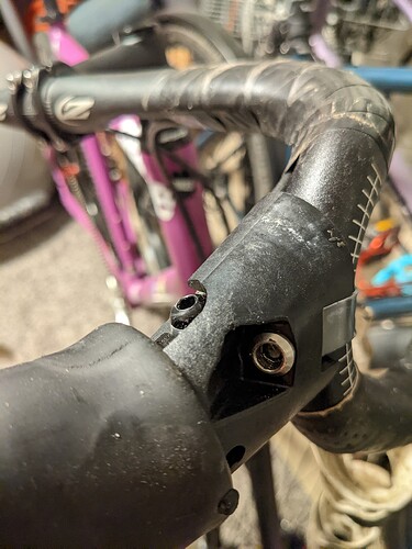

What tool do it need to get this stripped lever clamp bolt off?
Things I have include screwdrivers, hammers, cordless drill.
Drilling it out doesn’t bug me because the bars were cheap and I have replacements if I hit the bar. Just don’t want to damage the lever.
Angle grinder
Propane torch
pipe wrench
Check all of your Allen keys for one that might fit tightly? Failing that, cut the clamp?

You can try tapping/banging/hammering in a torx bit that’s just a hair oversized, that should dig in enough to get purchase in the bolt head to loosen the thing.
If it’s not totally stripped jam some sandpaper in the bolt head and then see if it lets you grab
This is what I did for a well with a security bolt. Worked great. You can also use a very slightly oversized inch based hex instead of metric, but you’ll have to hammer it in and the torx will probably grab better.
