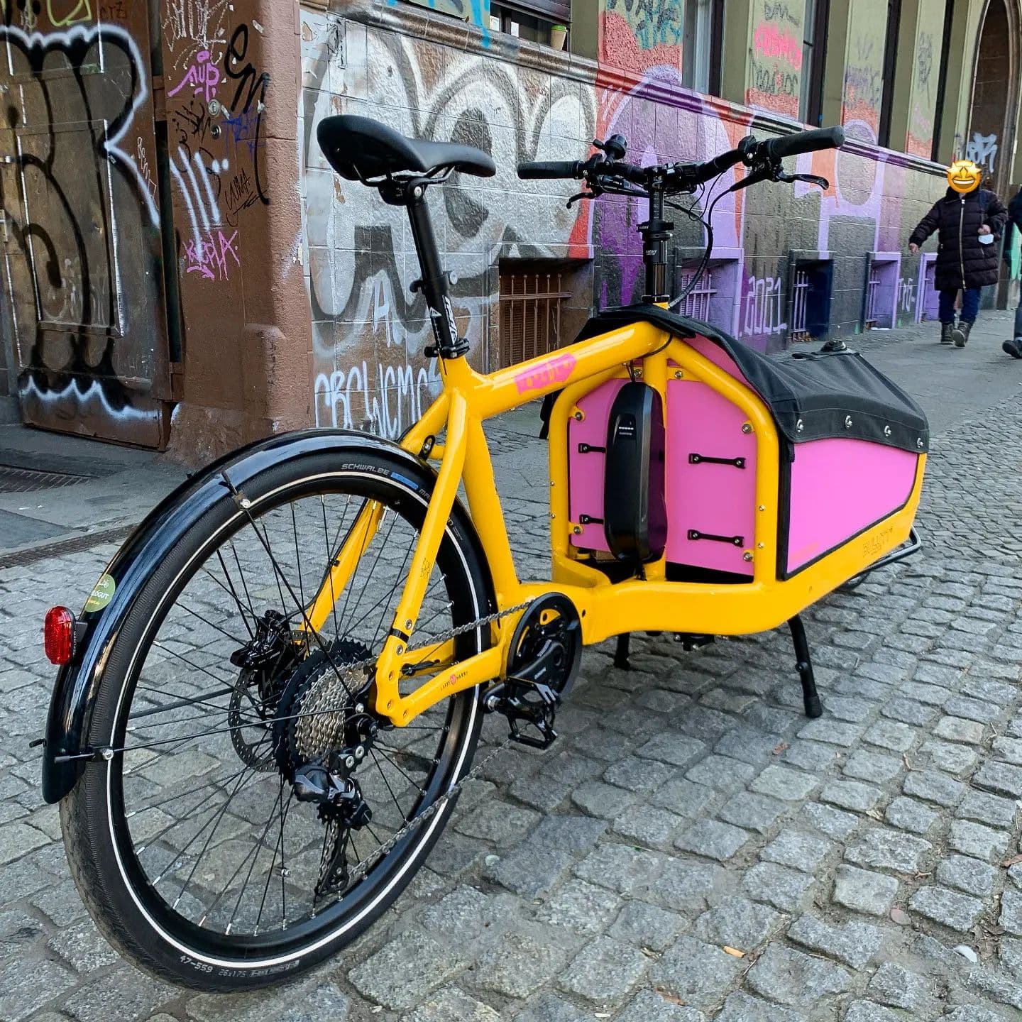

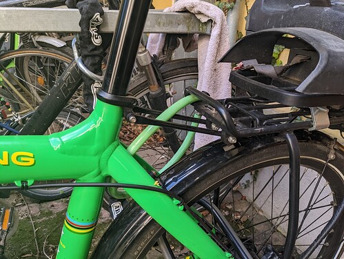

Kinda silly that the Bullitt doesnât have rack mounts on the seat stays. Iâve been using a tubus fly that bolts to the bridge but Iâd really rather use my tara. Might need to get a clamp like that.
