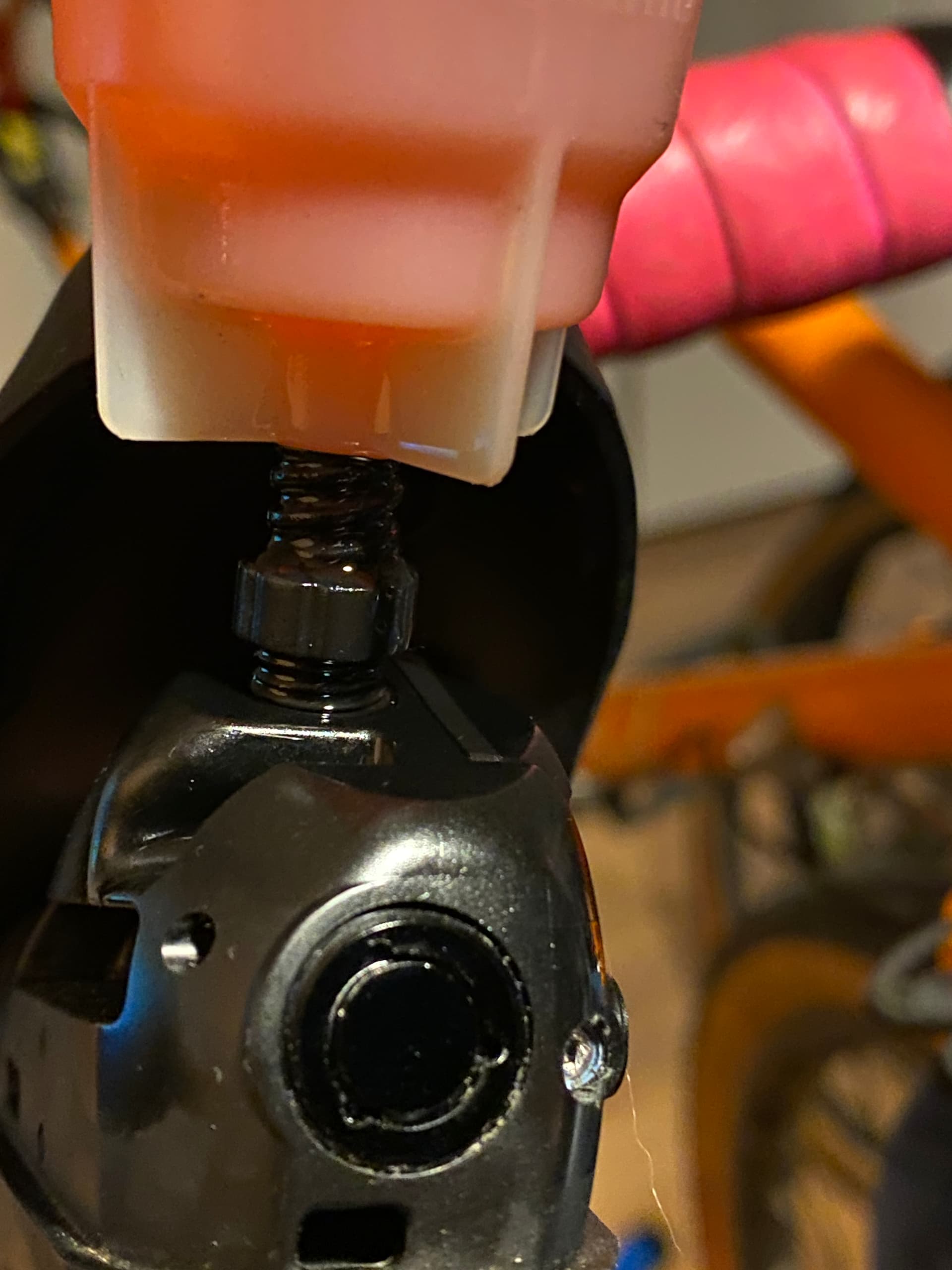

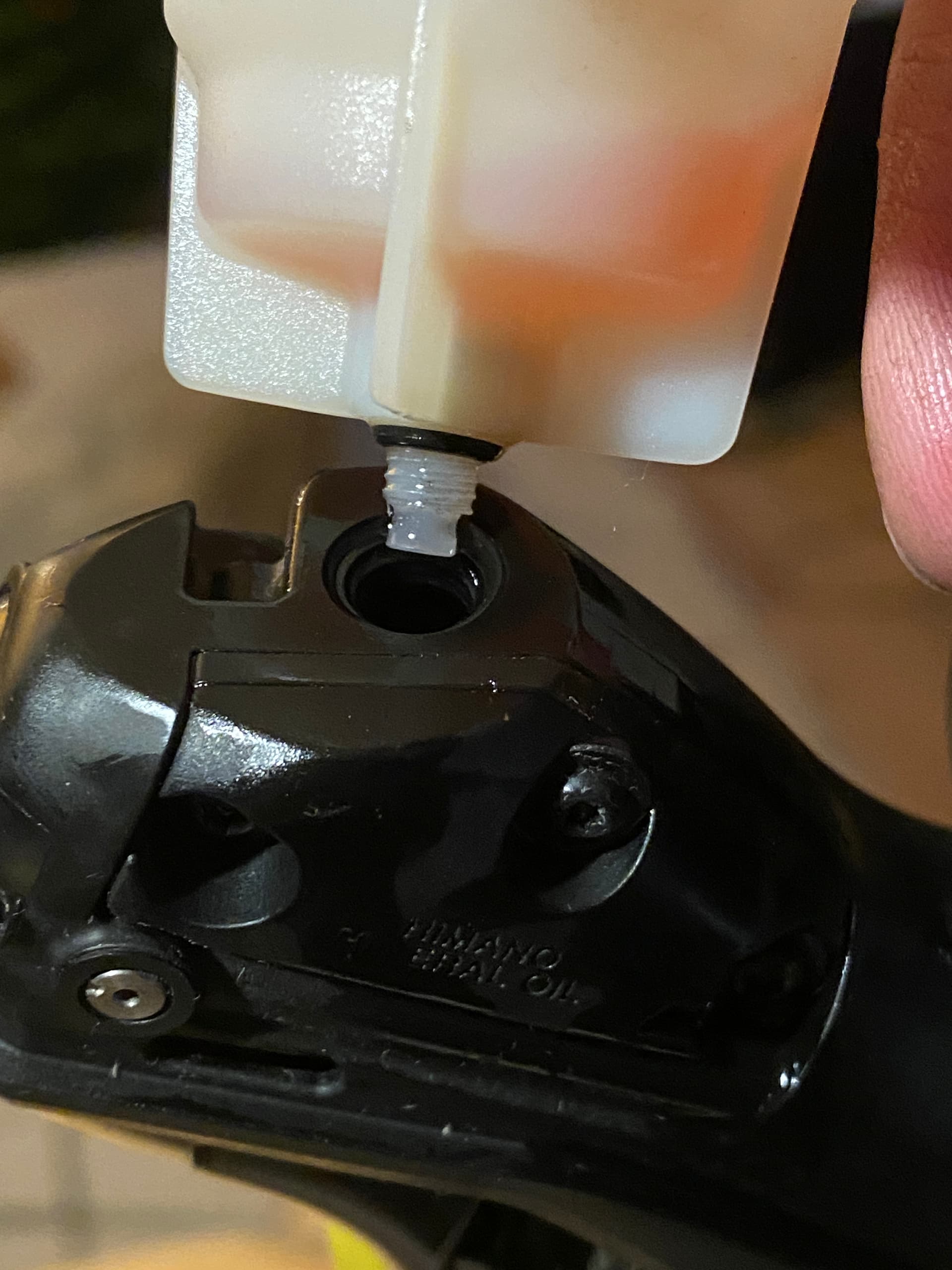

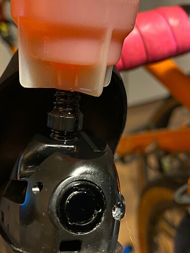

Anyway, what in the fucking hell, Shimano
Why would they do this? Why would they make the hole a different goddamn size.
I think they did that on the second gen, but I could be wrong. Needs another little adaptor jawn.
Meanwhile, I seemed to have lost the stopper for my funnel now.
And I also managed to snap off threaded bit at the bottom of the park tools mineral kit. So won’t get one of them.
Will I be able to resist rigging something up rather than waiting to get the right tool?
looks like you already spilled mineral oil all over the lever body
so not much benefit in having a tool
just let it spill a bit more
100% did try to attach it with a rubber band to see if it would leak
I mean, yeah, pretty much. You’re just doing lever bleed to get some bubble out, right? Don’t really need the funnel in that case. If you need to push from the caliper, then maybe wait, or just get a bunch of dry towels to soak it up, lol.
That is a better location than the first gen, though. It shortens the reach a bit more.
