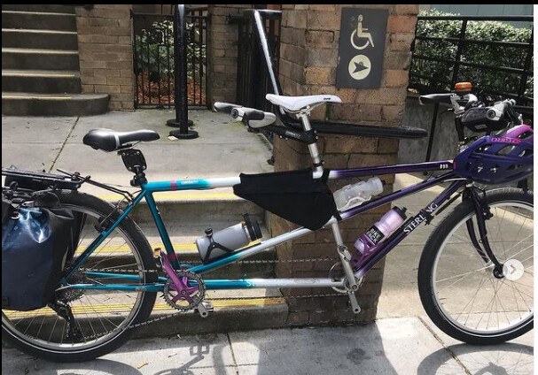

this is what we currently have. would probably look to replicate it pretty closely. definitely keeping the swept back bars and the thudbuster. It would be cool to have a braze-on that would let the wheel alignment spring attach directly to the frame instead of the big ugly mount.
That is awesome and I’m sure whatever you put together is going to be sweet.
we love it so much, and that’s been a big part of why we haven’t tried to replace it, yet.

Her thudbuster is a little lower than it really needs to be, and we’ve actually brought it up a cm since that picture. She is not at all a confident bike rider, so we’ve been slowly getting more towards a normal fit.
Her inseam is about 30" and mine is about 33" and the Sterling is 29" standover front and rear.
I dont know if you can tell from that picture but the EBB is at about 12 o’clock, so my seatpost could come down a lot if i moved it to 6 o’clock, and actually that’s something i should do anyways. I always feel like i am vaulting off the saddle when we come to a stop.

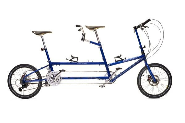

This is definitely old anecdotes, but when I used to sell tandems at an LBS 99% of tandem owners with a couplered tandem just used one of those extra-long roof rack trays.
They basically reported that the hassle of assembly/disassembly took up time they could be riding, and the couplers were only used for boxing for serious travel.
I know your situation is different b/c you don’t have a nice garage to just roll it out of, but wanted to offer that.
Would it be absurd to have a set of 16 “or 20” wheels for it, not for riding but just to swap on for bringing up the stairs and storage?
